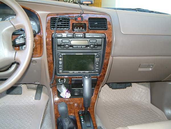

I did a quick search and couldn't find a mod or anything on this, so if anyone has a link to this, it would be appreciated.
My concern is on the limited model that has the Digital temperature control, there is no backlight, and therefore you can't tell what settings you are at when it is dark. Is there a lighting mod to get either a backlight, or at least a light that will shine on the display?
I am talking about that small display at the top of the center dash.
I stole this image whilst searching on google. Brought me to a yotatech post, so whoever posted this pic, thankyou.
Attached Thumbnails LED Climate/Temperature Display-dscf0009-vi.jpg

hmm..the top center is the digital clock. Underneath that is the digital climate control which is backlit when your lights are on.

No "mod" needed. The original lights must be burnt out.
Try going past a quick search, as just typing in "digital climate control" yielded many results.
https://www.yotatech.com/forums/f127...acement-70183/

Good find. Thanks.
This truck has been in the family for about 8 years, and they have been burnt for as long as I remember, so I just assumed they never had lights.
Thanks.
