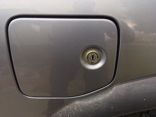

Well I pulled the gas door lock cylinder over the weekend. I was definitely winging it...
I ended up prying off the cap, pulling the cylinder out of the casing, pulling all the wafers out (wafers- a term I just learned from the locksmith), then put it back together minus the wafers, which are what determine that only a certain key shape will fit and turn the lock. I was way too impatient prying off the cover and bent it all out of shape, so there was no way I could get it back on. Otherwise it all went together fine. So now it still has the little lever on the inside to latch the door closed, but I can stick any ignition/door-like key into it and it'll open.
Only problem I can see is in cruddy conditions like winter, mud etc. The cover definitely protected the innards. Now it's open to contamination. Time will tell. Even if this is just a couple-year temporary fix, that's cool.
