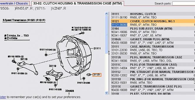

OH MY GOD!!! THIS THREAD JUST HELPED ME SO MUCH!!! I have been freaking out about the hole on the bottom of the R151F Tranny. I just bought a Turbo pickup and couldn't figure out if that was normal...
Mine doesn't have the rubber plug anymore? Is this bad? Any clue on how I can get a hold of a new one?

This http://www.toyodiy.com/parts/
gave me a part number 31121‑36060 that https://www.1sttoyotaparts.com/ recognizes........ shown here

Thank you very much. I appreciate your help tremendiously.
