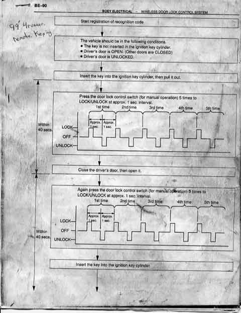

Here are copies of the actual diagrams from the dealer that I have...let's you have a few more options if you want to try your hand at it.
Just open, save as, print out, and then keep them for safekeeping for future use.
