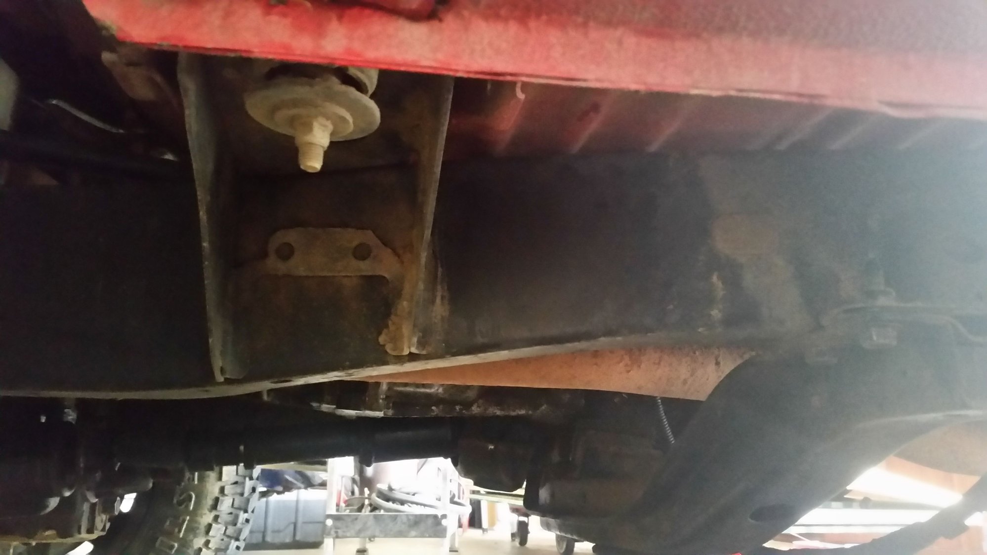

Here are some before pictures of the frame
Started by grinding away the paint on the frame for the placement of the 5 plates on each side that the spuds will be welded to

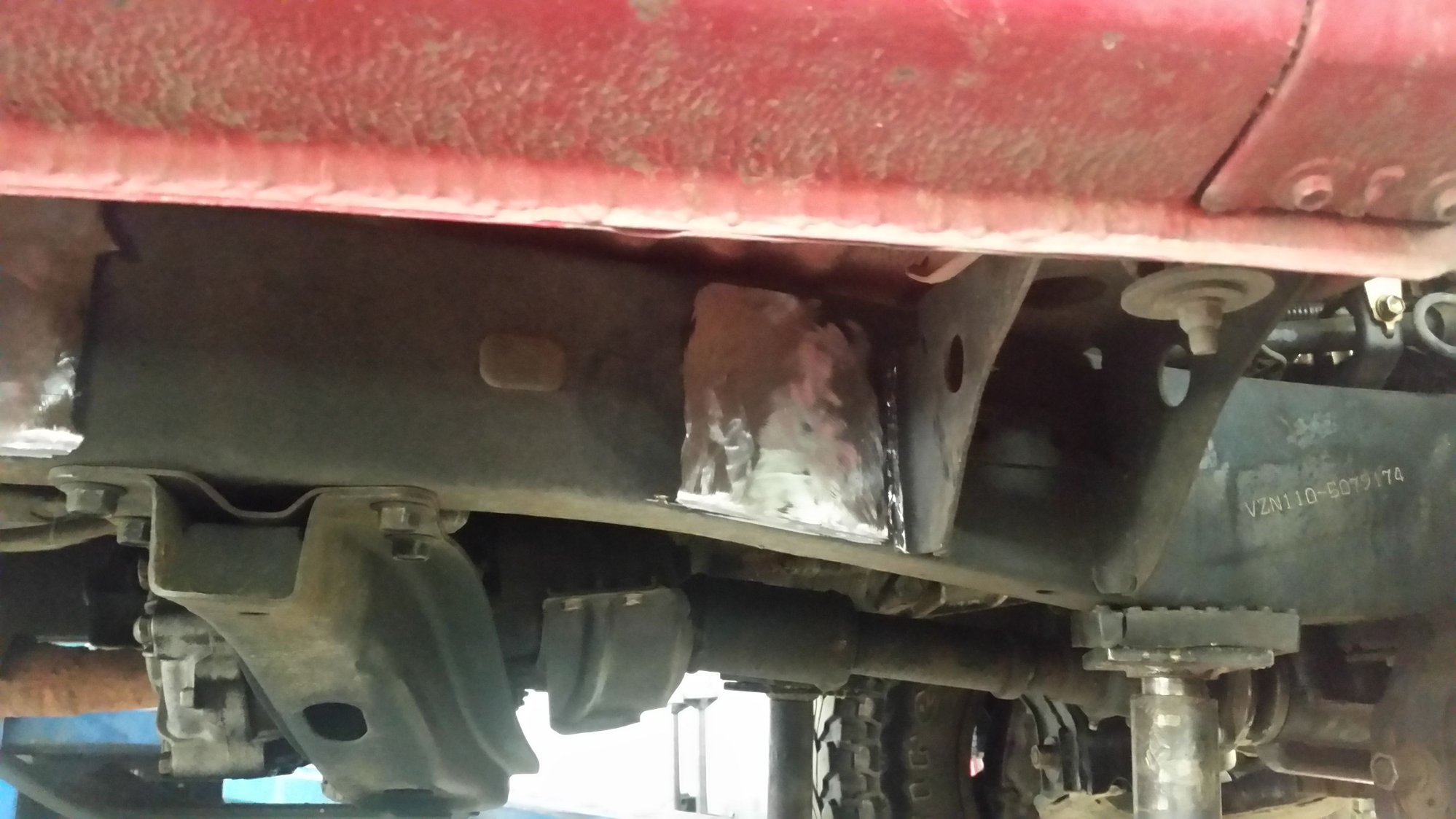

Here are the front and rear spuds installed
And here is a shot of the base tube welded to the front and rear spuds

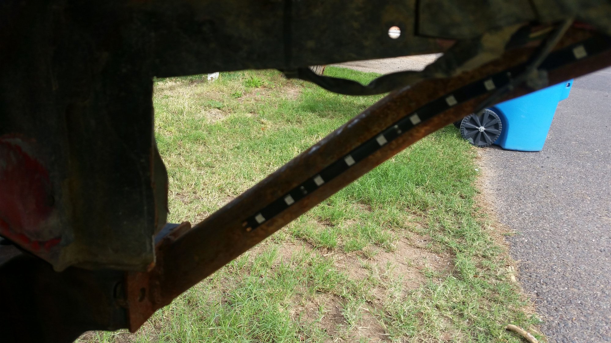

Because the stock turn signals were in the original bumper that was removed, I added some 12v amber LED strips to the backs of the support tubes for turn signals

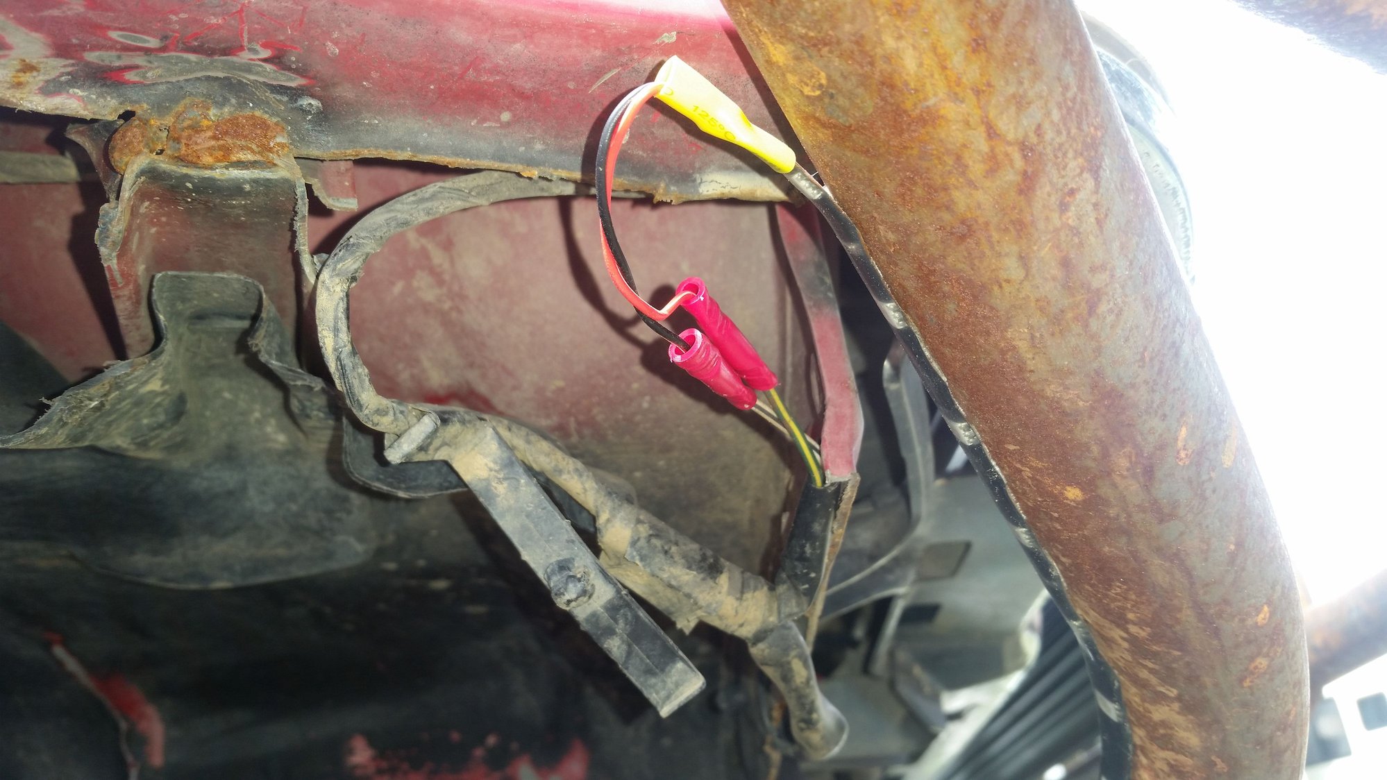

Thanks man, the wiring is actually really simple to do if you get LEDs rated for 12 volts. I got a 4 pack on amazon of 12 inch amber 12 volt LED strips for $12. If you get LEDs rated for 12 volts, you don't have to wire any resistors, the LEDs will wire directly into the power lines from the turn signal. I just turned the turn signals on and used a multimeter to figure out which wire was positive and negative, then crimped the LED strip directly to the wires.
Later on I'll probably drill some holes into the tubes and wire brighter LEDs, but I feel better driving around now with working turn signals.

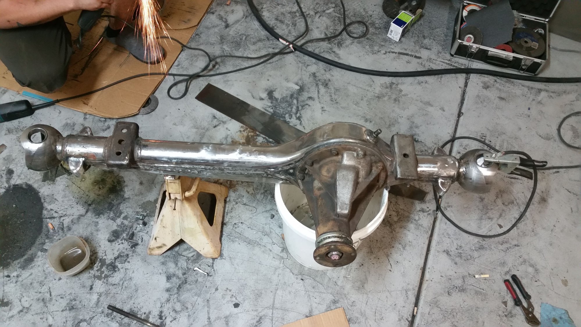

Cutting off all the extra brackets
For the steering stops, I followed Wheelie Pete's bombproof steering stops guide:
and placed 15/16" nuts inside the stops and filled it up with welds. Then welded a plate onto the top and bottom of the steering stops
Now its ready for a top gusset

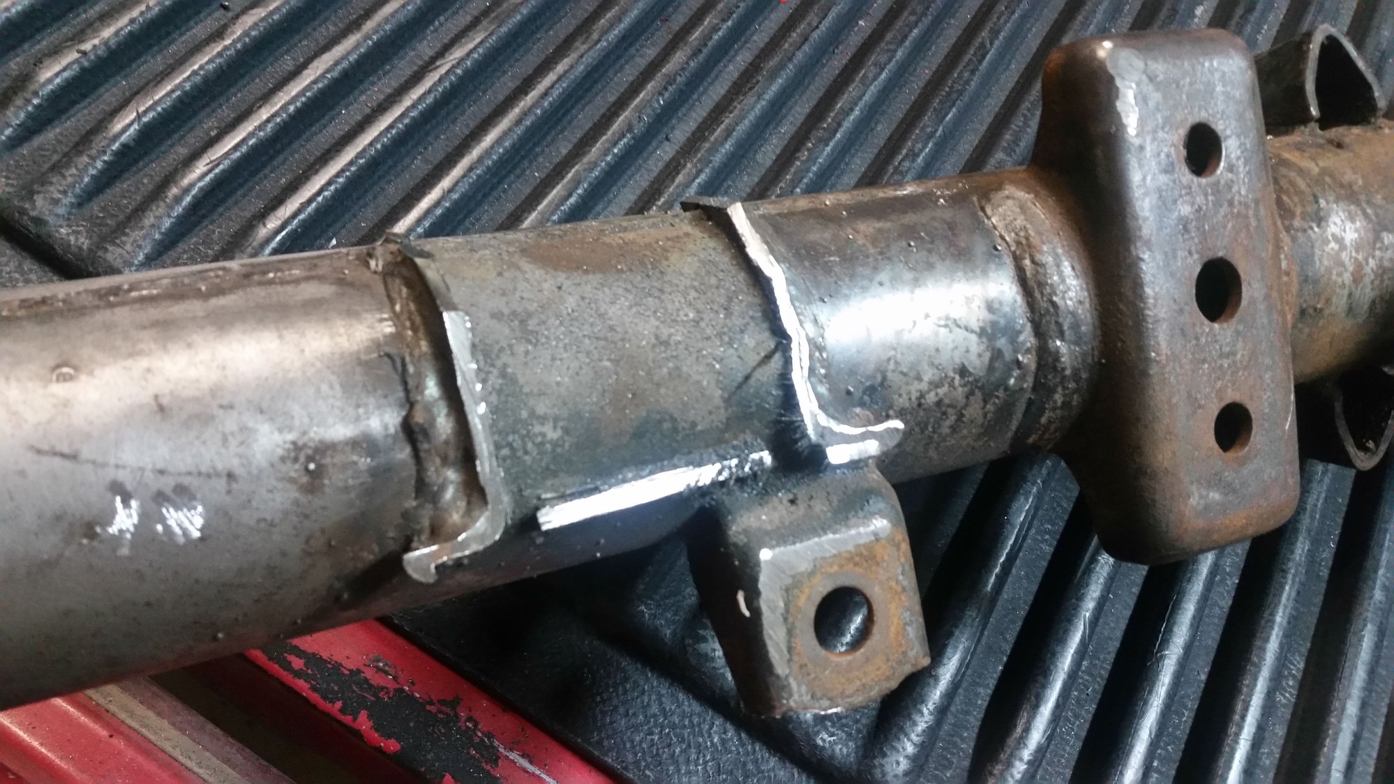

Upper gusset front plate tacked on
top and back plate tacked on
Closeup showing how thick the top plate is
Upper gusset welded up
