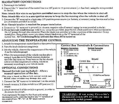

I assume you need a relay for the switching as well, right?
I also heard it was recommended to use a diode between the pos and neg lines on the fan to reduce the load on the relay at fan spinup.

Ahhh, well no. No extra diodes, switches or relays needed. There is an inline fuse...but that comes with it.
I was referring to that with the taurus fan rather than the flex-a-lite one......I would hope theirs comes with everything needed for install to get you up and rockin' quickly.
