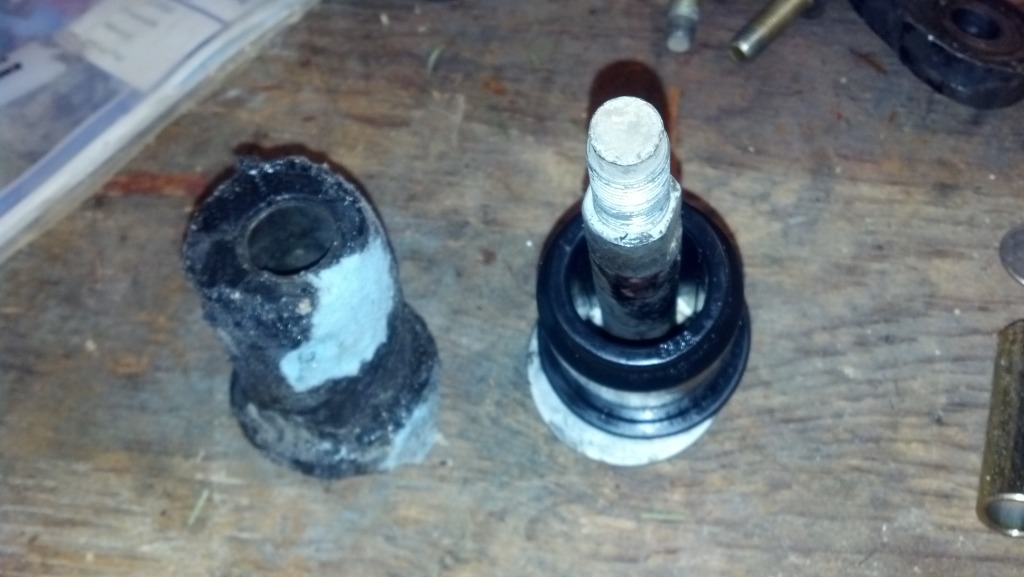

I got the energy suspension 8.3115 poly lower control arm bushings. It's for a tacoma but I found several people that said it worked well on their 4runners. The problem is that the inner diameter of the bushing is way bigger than the outer diameter of the cam sleeve.
half melted stock bushing on the left for comparison:
If I install it this way I don't see how the cam is going to adjust the lca for an alignment. Anyone with this bushing that can chime in?

Are you sure they sent you the right number?

I would give them a call on Monday if you did not have a chance yet - not where you bought, but probably ES. I used an ES kit in my 87 P/U a couple years ago there was no play in them like you have pictured. They were tight not only against the LCA, but also internally against the cam sleeve. Now I know you are doing your 4R and I'm talking P/U, but from currently owning a 994R and an 01 Taco there's not much different in the front suspension and then comparing the LCA to my old 87 it was just about the same as well. The UCA was different because of torsion bars and no coilover, but the LCA was the same basic setup.
With that said, I could not see how you would ever get that properly aligned let alone massive banging and movement with that much play in the LCA.

If I'm not mistaken, you reuse the metal sleeve with the poly bushings, however, those poly bushings look way to large, If I remember correctly, its States on the web sites information that you must re use metal sleeves, I almost bought these for my pickup, but ended up goin oem.

So after a while the guy at ES emailed me back and told me that there was no way that what was in there was a factory bushing so it wasn't going to work. His recommendation was to find a stock bushing or to go to one of their retailers and order a complete bushing by size. Not a bad option but my local dealership had them in stock so I went and picked up some oem bushings.
Moral of the story is that if you want the poly bushings from ES make sure you've got stock bushings to begin with.

Man, it has only been about a month or two since I removed (drilled out) my LCA bushings and they looked exactly the same as your first pic. I know mine were stock because of the amount of corrosion on the outer sleeve and the LCA itself. I could not press them out because of the amount of corrosion and had to drill the rubber and then notch the outer sleeve and "crush" it inwards to fold it out.
When I did this I already had new ones and they were the exact same. I did not go with OEM, I went with Moog because they are a good name and its hard to screw up a pressed in pushing.
With that said, since you picked up the OEM does it look like this will fix your problem? Will they come apart where you can use the inner sleeve?

I could use the OEM bushings with the ES but to do that I'd have to destroy the OEM ones. Seems like kind of a waste if I've got brand new OEM's. I'm going to return the ES ones and just use the toyota's. I found a good thread on replacing them here
