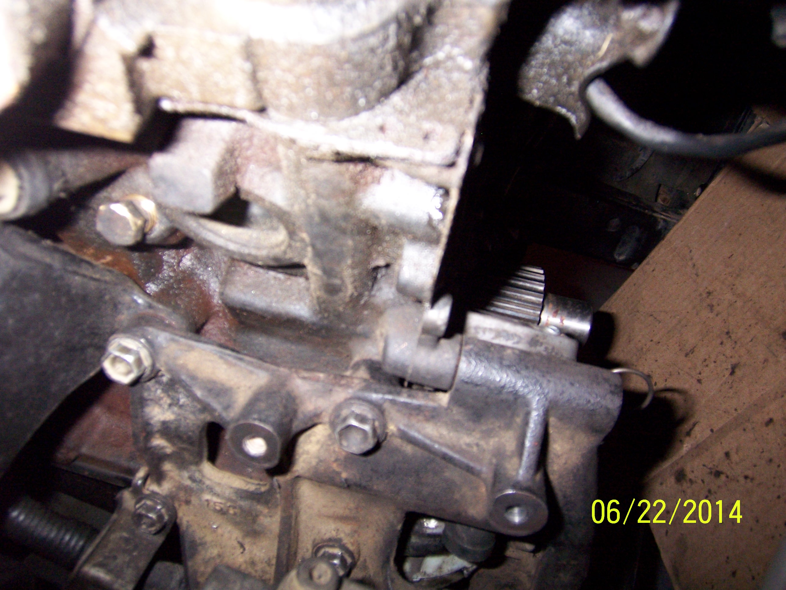

Hello First Time Poster here.
I have a 98T4R 4x4 and I am doing the TB and WP for the 1st time, I have taken everything off upto the water pump.
The kit I bought also included the lower Pulley and the black T shaped tensioner, well how do I take off the T shaped tensioner visible in the first picture on the left hand side?
The cam and crank seals are also included but my understanding is not to screw with them unless needed?

There is a write up on here on a complete timing job. Google search for it. How many miles on the tensioner? are you gonna replace the crank and cam seals?
To replace the tensioner you need to unbolt the ac pump strap it out of way then unbolt the bracket. Then you will have access to both bolts that hold the tensioner.

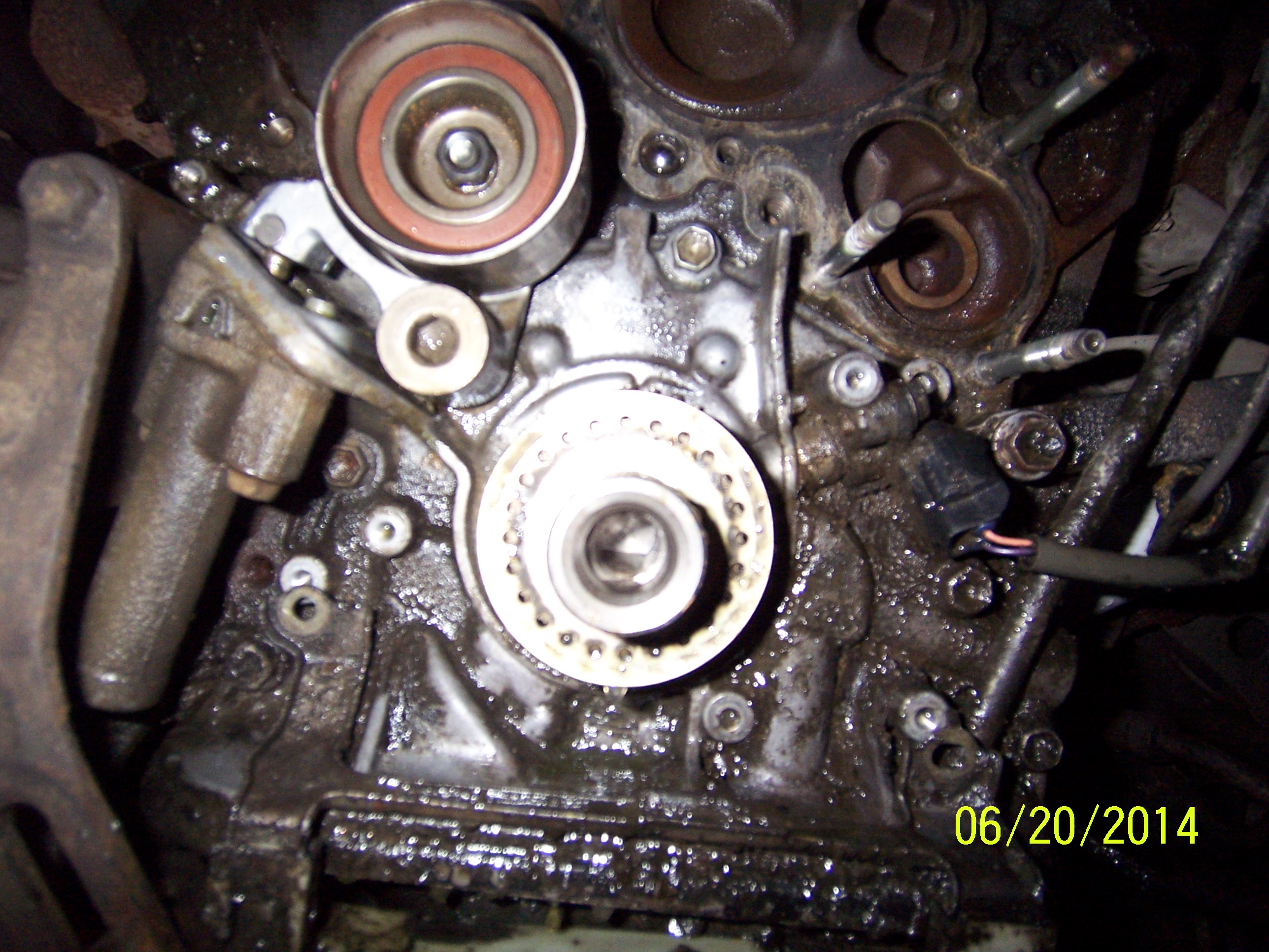

I just took off the compressor bracket and now have easy access to the tensioner, last two bolts before I can start to put things back together. BTW I have a pre-compressed tensioner in the kit and will be replacing all items in the kit but the seals.
The WP was leaking into the bottom TB cover and there was road grime mixed with coolant in there. I am not sure if the seal was leaking, I will readup some more on it tonight and see if that is the case, and how much extra work it is
I have a torque wrench that goes to 250 ft-lbs and I also made a tool to hold the harmonic balancer, will also be using some blue thread locker for peace of mind.

I use a holder of the same design...it gets the job done.
Hardest thing sometimes with doing the crank seal is getting the crank timing gear to slide off. I generally use a puller on it as mine has two threaded holes in it. Be careful...those teeth on the timing ring are very soft and if one breaks off you'll be replacing the timing gear.
Jiggle valve is Toyota's term for it right out of the FSM. We have a thread around here that documents a 10 degree increase in coolant temp when it's in the 12 o'clock position on the 5vz-fe 3.4l engine. No one knows why, but it was reproducible for multiple members.

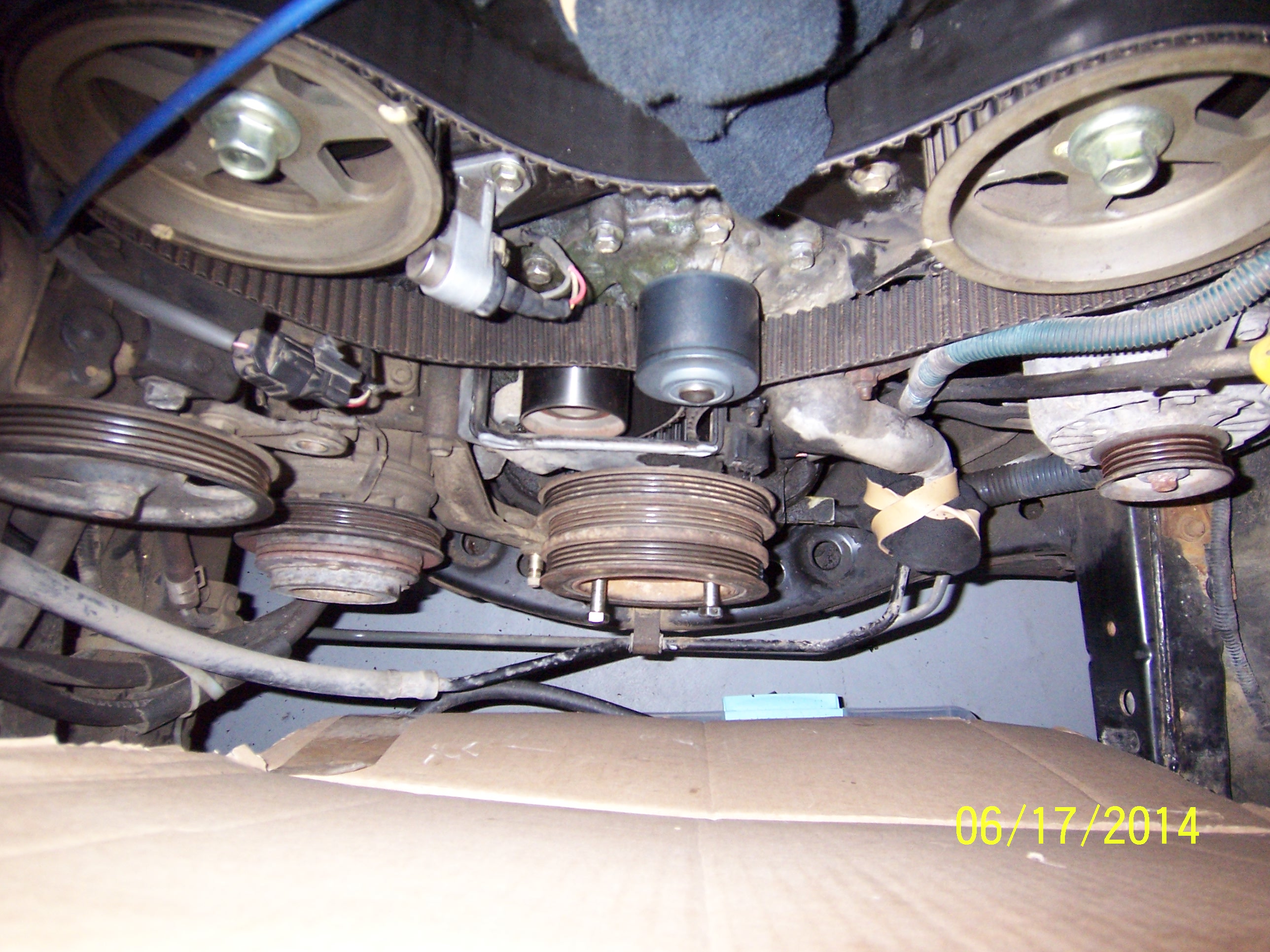

Finished putting the Tensioner, the compressor bracket and the compressor back on last night used a little anti seize for next time.
I have already done a cleaning job of the mating surface, covers, bolts etc.
Starting with the
gasket, wp, thermostat, then the two bearings, the crank pulley, so I can set the engine to TDC with the old belt....
Then remove the crank pulley again, put the new belt and the TB cover back on then the Pulley again...

You may want to think about flushing the brake fluid...noticed yours looks nearly black. Fresh fluid is nearly clear to amber.
I find it easiest to fill the block up with coolant through the upper radiator hose before attaching the hose to the rad. It helps to minimize air bubbles.
For TDC, just bring both cams and crank to their respective TDC marks and install the new TB. No need to mess with the old belt (and least I don't except to wrap old TB around the crank to remove the crank bolt after setting crank TDC). It's a non-interference engine to you can move the cams either direction.
Remember, passenger side is right and driver side is left if the belt is marked with R/L alignment marks. I use spring clamps to hold the belt on the cams while fiddling with getting it on the cam.

No! You suggest the wrong approach on the TB. Get the cams and crank aligned to the TDC marks BEFORE putting on the TB. After the TB is on and the grenade pin pulled rotate the crank 2 full revolutions clockwise and cam and crank timing marks should come back to TDC.
Hmm, on the water pump I've only used AISIN i.e. Toyota OEM and they come with a metal/RTV gasket. Have you tried a google search for suggestions on the best way to mount the paper like one? Maybe it needs a bead of RTV?

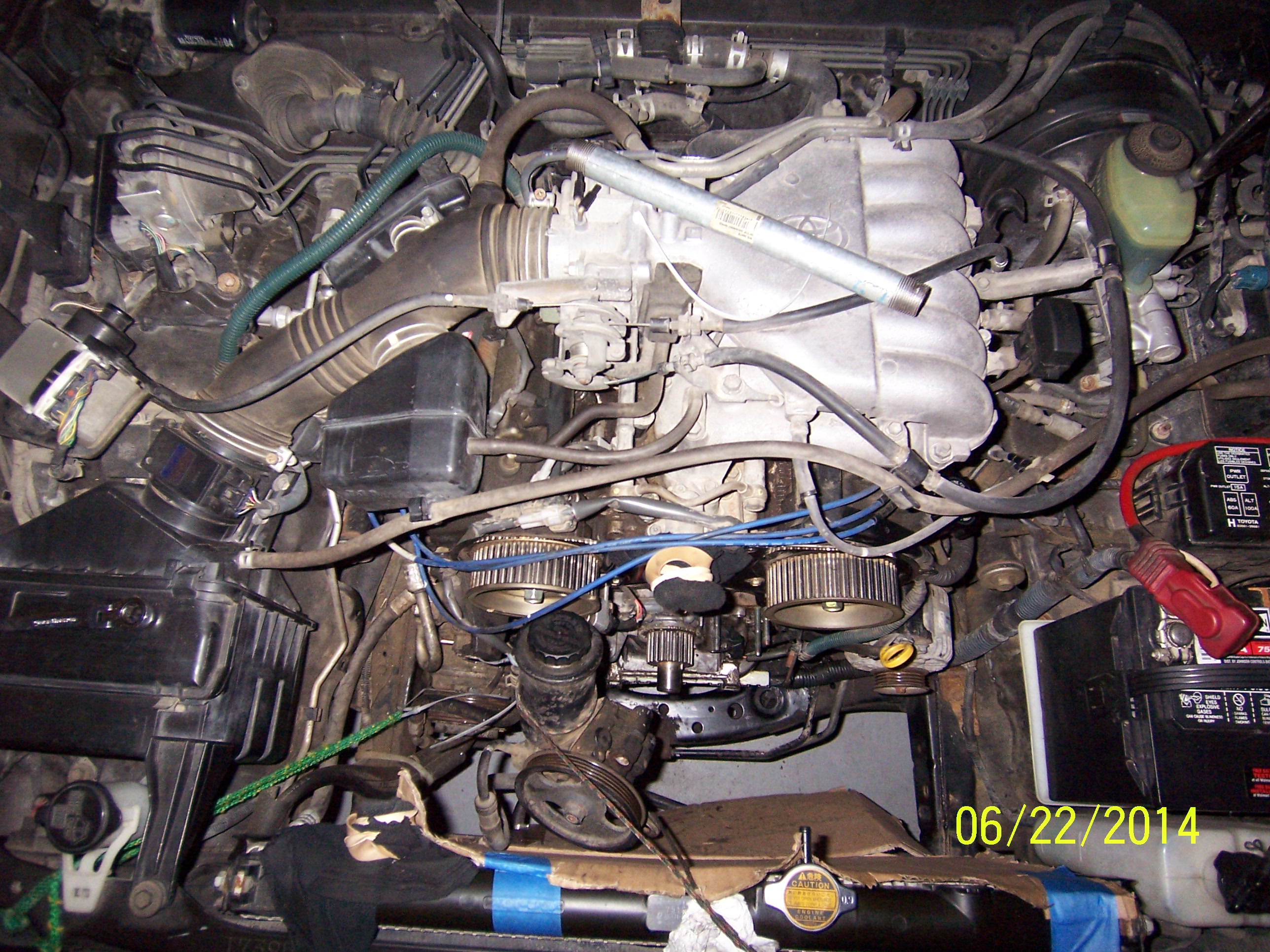

Ok, I have set the TDC as pictured on my flick account.
Jiggle Valve at 6:00 just flipped into the WP housing
https://flic.kr/p/o4Y47v
Driver side cam
https://flic.kr/p/o4RN2b
Passenger side
https://flic.kr/p/o4EMD6
Crank Pulley
https://flic.kr/p/nMu1DE
https://flic.kr/p/o4RS5j
https://flic.kr/p/o6Kgce
I am off to wally world and grab 10 gallon distilled h20, and some Zerex Asian Coolant if I can find it at O Rielly's... will do the flush per the steps you posted above....thanks buddy for helping a new wrencher:=)

Do you have the TB back on? The right cam may be a bit to far clockwise. Other pics look ok to my eye.
How did you finally seal up the WP?

On the cams, just be sure the marks are lined up at TDC and then install the belt. The cams sometimes want to jump due to the valve spring resistance. The real test is after the belt in on, grenade pin pulled, and the 2 clockwise revolutions should bring everything back to TDC. If not, redo. If back to TDC, button it up.
