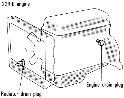

One of the best ways to "flush" the cooling system is to drain all engine coolant VIA the drain plugs located throughout the cooling system.
Fill the engine with distilled water while leaving the radiator drain plug loose, and radiator cap off start and run the engine turn the heater on high.
With the radiator drain plug still removed allowing a flushing/removal of the system with the engine still running. Also remembering to constantly top of the cooling system with distilled water. Doing this for around 20 minutes is ok. This being a time consuming method however is a good one recommended by lots of manufacturers. Using compressed air to "blow-out" residual water left is also great if available.
Thank you very much. My only question is what do you specifically mean by using compressed air to blow out the residual water. Do I put the air nozzle in a specific location? I will have access to a compressor with a nozzle this weekend when I do this flush this weekend.

Well as mentioned above in other posts. When you are finished "flushing" and draining the system. To remove upper and lower radiator hoses(Maybe even the heater hoses for the heater core.) and apply compressed air to remove as much of the left over water in the system as possible to get a good and true coolant fill.
Again this is all preference. Most of the water will drain from the drain plugs located on the engine/radiator as they are the lowest points of the cooling system. Most of the water will more than likely evaporate after the said above flushing.
After getting the system good and "flushed" re-fill cooling system with preferred engine coolant, run engine with heater on high and let cooling system bleed or "burp" residual air pockets left in the system upon re-fill. Bleeding should take some where around 15-20 minutes with the 22RE.
