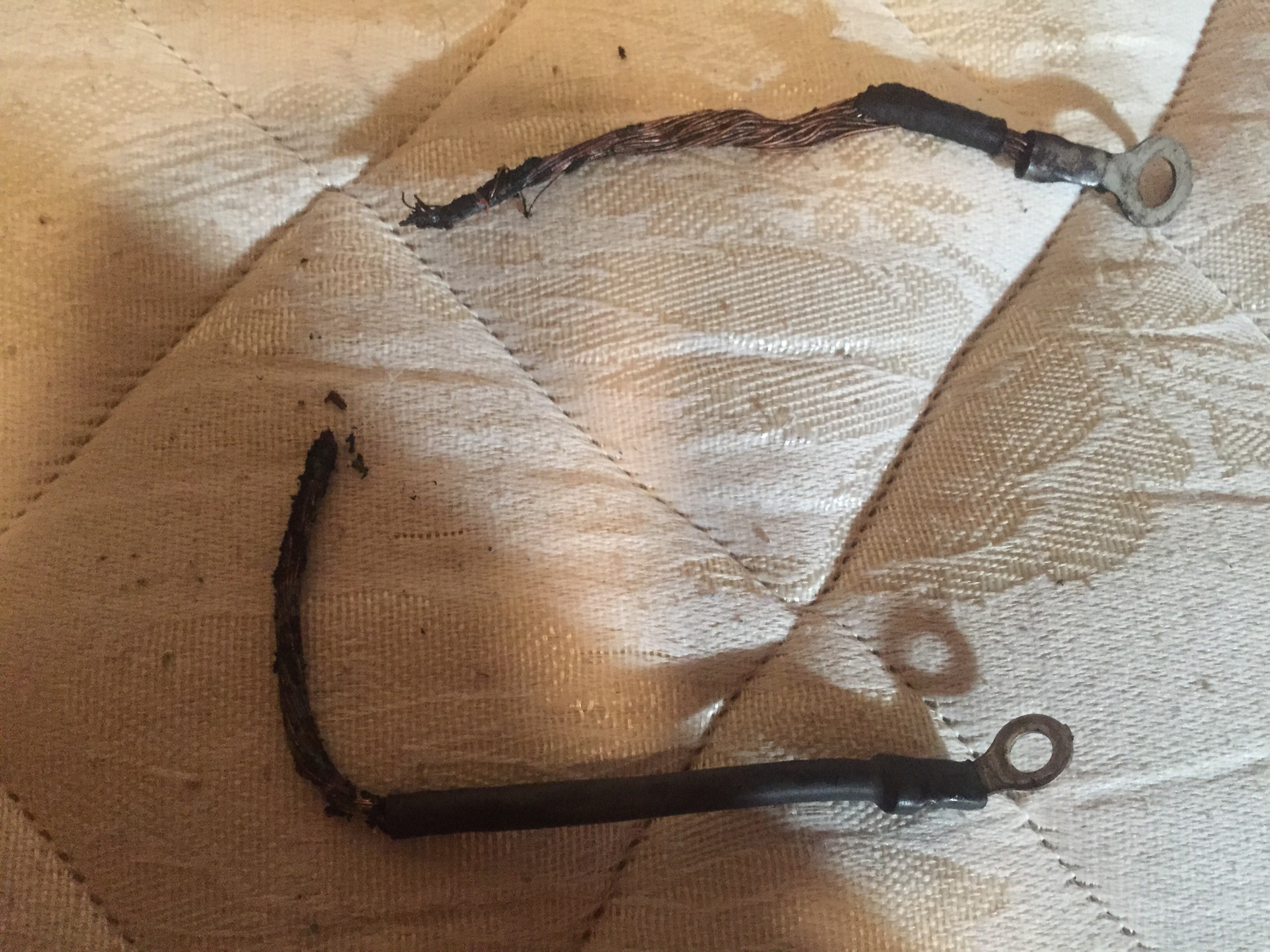

ZUK is the winner on this one. Thank you sir!! It was the small 8-10 gauge wire behind the block, above the starter to the firewall. Fried in 2. Replaced it with a 6 gauge and also replaced my battery to chassis ground as well, it had been disconnected for years without issue.
All symptoms are gone!!! I can get the Z06 back in the garage and get back to breaking 200,000 on the 97.
