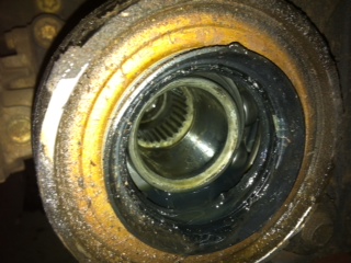

Hey All,
I am in the middle of replacing the CV axles on my 2001 tacoma. The driver's side is done. Took a while, but that side appears to be good to go. I then popped out the CV axle on the passenger side and prepared to install the replacement just like the first one. However, it looks like interior of the differential is different then on the driver's side. It looks like there is a splined interior piece missing, and without it there is no groove for the C-clip to pop into. No additional pieces came out other then the axle and dust cap. Any ideas?
The smooth, shiny part of the diffential in the picture just before the splines had a rotating, splined piece on the driver's side. ??????
Thanks!

Mine, and I know it's good....4Runner though....
With new seal, but still good....
And what's behind that seal....if it's not leaking/messed up don't mess with it!

You're good to go. What's different is supposed to be that way. You just have to understand how the 4WD ADD system works to know what you're looking at. Which you apparently do not...

Great, thanks for posting the photo! I guess I am confused on where the C-clip ends up when the axle is back in place, if there is no recessed spot for it like there was on the driver's side. I broke the C-clip in three pieces on my first attempt to pop the axle in.

Yep, it's popped right in every time I've done either side.
Thanks. Nope, I don't know what I am looking at. First time replacing these. I figured if the axles are identical and interchangeable then their mounting in the differential would be indentical too.

Everybody's gotta start somewhere, least that's what I keep telling myself! Watch that seal when you put the new shaft in, don't knock into it. That's one of my DOH moments. Ah well, I'd rather fix my mistakes than let someone else have all the fun.

stinky coon, Hab modified post #5. It does not appear she is meaning that she broke the clip, but the the cv axle slid in and the c-clip popped into place locking the CV axle in its installed position.

Thanks RW, that's where I was going with that....bad about not quoting what I'm answering. Don't worry Stinky, you had a fighter on your hands, your life or its. You've still got fingers, toes and a face so you can consider it a win.
