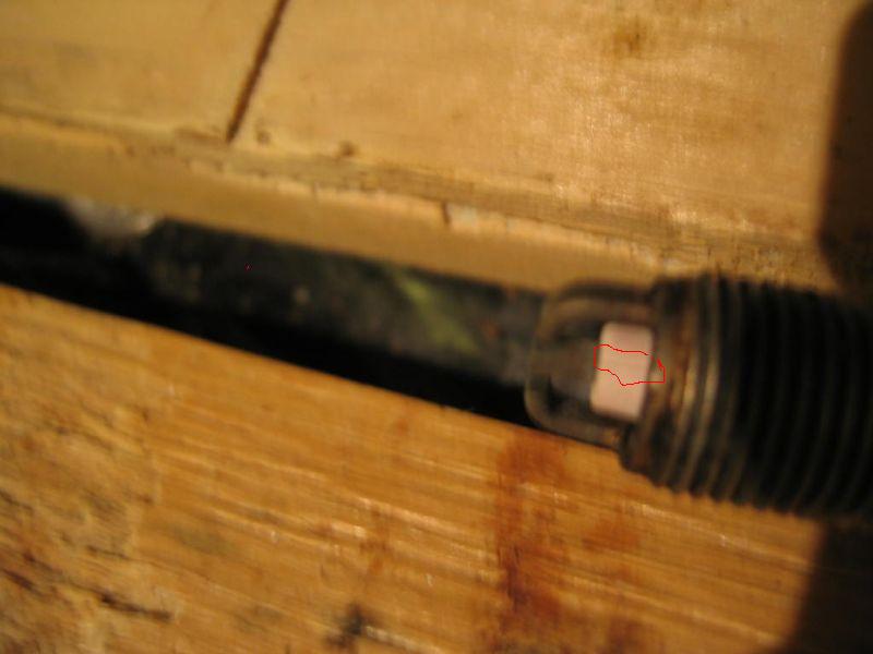

My trucks 3.4 engine tends to crack sparkplugs regularly, about every 4k miles.
When I say crack, I mean it is actually putting a barely visable tiny crack on the porcelin by where the electrode extends out. This crack is enough to make the cylinder misfire and throw the misfire code, generally run like crap. The plugs always look fine with the exception of the crack thing. This has happened 7 or 8 times already. My guess is I may have a lean condition going on or something.

Yes, the cracks are happening where the tip of the electrode comes out, you can kind of see on the pic.

Can you please post a clearer photo of the plug you took out, I can't see anything on the previous one you posted.

3, 6 and 4 cylinders so both sides of motor. No detonation at all, not sure about the timing, but usally running perfect. I dont believe its my driving habits as I never rap it out, mostly 3000rpm between shifts. I do always run regular gas, maybe I should switch grades? I did the fuel filter about 50k ago. If you open the pic you should see the crack.
