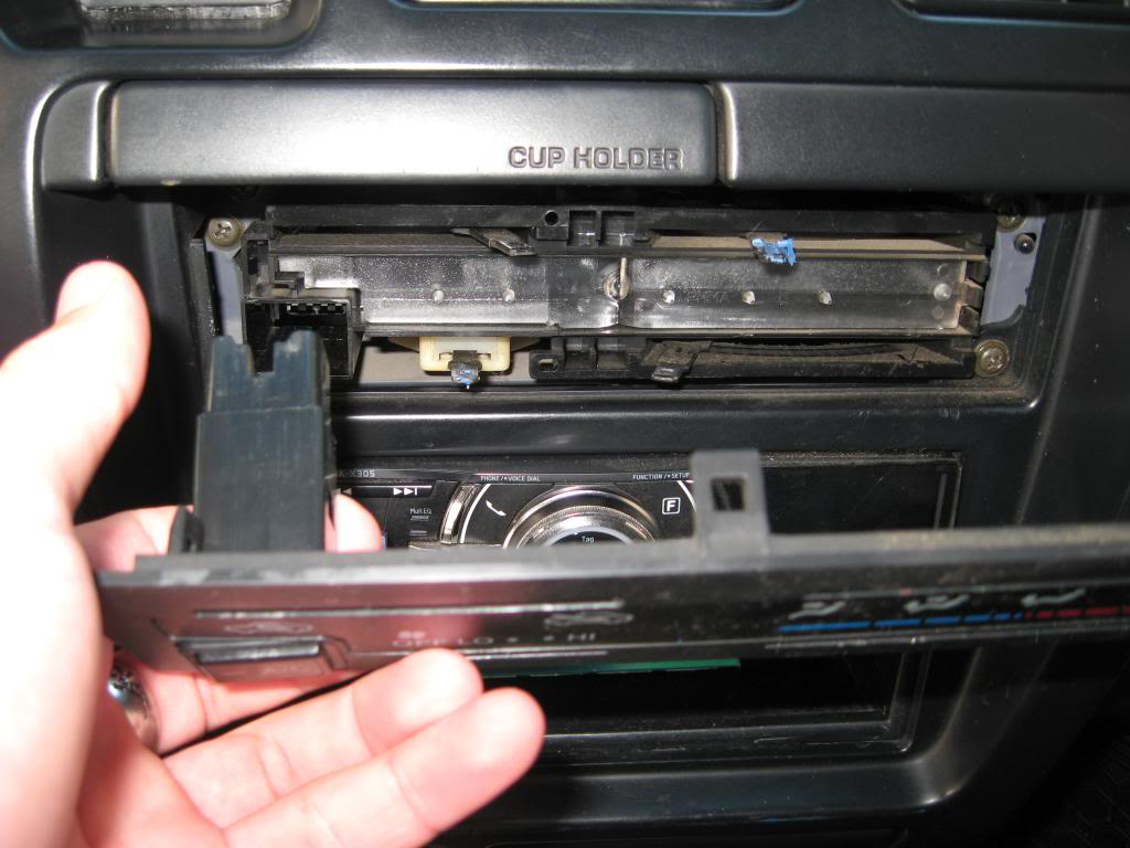

first you wanna take off the four climate control knobs and pop off the plastic climate control display plate off.
the knobs just pull off and you might need a small flat head screw driver to help you pull off the plate. pull the plate off as evenly as possible as the AC button has a long button/sensor assembly as pictured in the two pics below

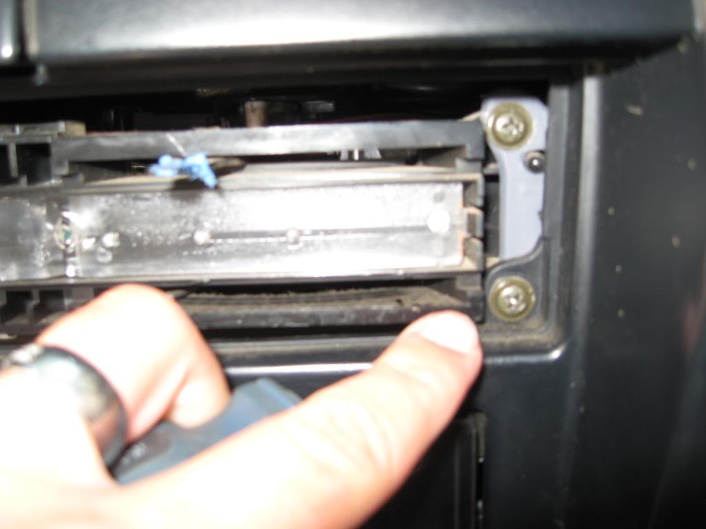

second unscrew two phillips screws that hold the entire console into place.
one screw on the top left and another on the bottom right side.

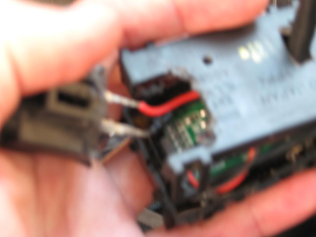

i cut out a hole in the clock display large enough to fit the temp display.
i used a exacto knife to trace the outline and a dremel tool to cut out the hole.
i also had to round off the corners of my temp display to fit the way i wanted it.
i dont have any pics of this step sorry..
i also cut a small hole to fit the sensor wires and cutout the power plug to make soldering easier.

to supply power to the temp unit, i used the connections that said "acc +" for my positive and "e -" for my negative.
again sorry i have no pics of this..
after that your all done.
the unit that i purchased came with a very short sensor wire, i soldered a long 3 meter wire so i could run it to the front of the 4runner
reverse all your take apart steps to reassemble it all. and your done
