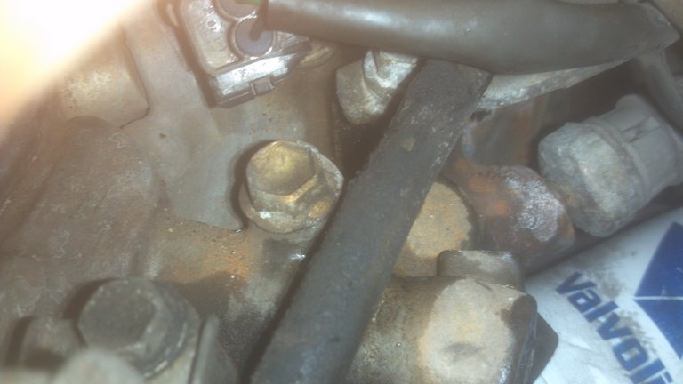

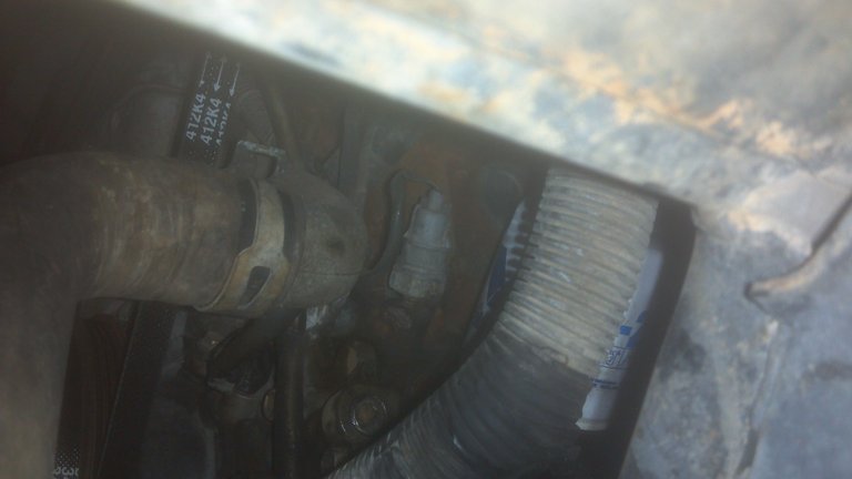

whoops, sorry its the tacoma in my sig! No MIL, no codes whatsoever!
I thought this was the coolant sensor... apparently not, so what is it? (center of pic, in between hose and oil filter)

Whatever it is, its drenched in old coolant, so i thought that was why the truck keeps bogging down and going into safe mode. Guess not. And i'm still leaking coolant from somewhere. great.

The sensor in your pics right above the oil filter is your oil pressure sensor. Just so you know
Ah, i should have figured. Thanks!
