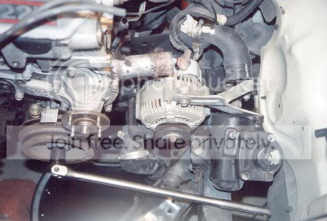

courtesy of 4x4 wire
use a 1/2 breaker bar and socket
