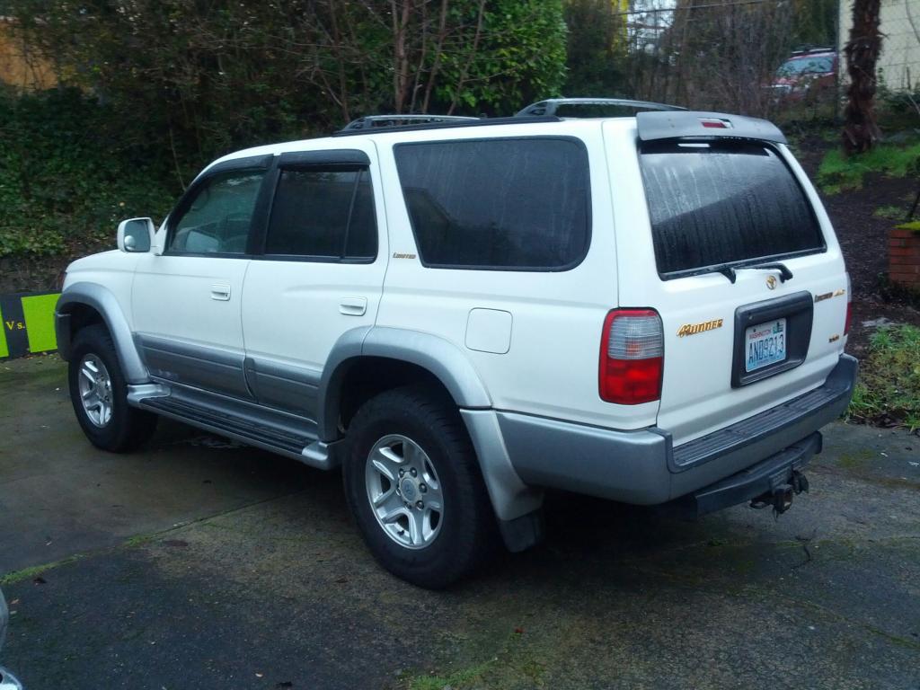

Well this went pretty quick - found this guy 250 miles away, and picked it up yesterday:
180k, automatic, every option ever (including e-locker!), in pretty good shape (minus that the driver seat is utterly destroyed, & the window controls crapped out a few times). Not too worried about fixing those.
Now what I am a little nervous about is, of course I didn't notice on the test drive, but when I got it up to 70 mph on the way home, it's spinning a hair over 3,600 rpm. This seems awfully high to me (75-77mph is almost 4k). I assume it has 4.30 rear gears (since it has the factory e-locker), but is that normal? Could the tach be reading incorrectly, or maybe I'm missing 4th? 60 mph is 3,000 rpm almost exactly.
Oddly, I tested fuel economy, and got 22 mpg after running 70-75 the whole way home (flat, highway), which is better than I anticipated. Thoughts?

That sounds about normal RPMs if you are not in overdrive. There is an overdrive off button on your shifter. Are you sure that was not pushed? There should be an orange O/D light on your cluster if overdrive is turned off.
What size are those tires? 265/70s came factory.
What did you pay for it?

Overdrive was definitely on - tested by turning it off (rpm jumped way higher as would be expected, light on the dash works).
Not sure what tire size is, looks normal to me (can check tonight).
Paid 7k.

Yikes that's too high unless it's been regeared, which I doubt by it's stock appearance. What happens when you pull it down in "2"? Can you feel it shift all the gears? Are you sure when you turn O/D off that it's not just the converter unlocking? When going 55 down the road, tap the brake lightly and see if RPM rises by a few hundred to verify your converter is locking up.
Check engine light? Checked for any stored codes?
Your tires look stock sized to me. Couldn't tell on mobile earlier, but they are not significantly smaller so it wouldn't affect RPMs drastically.
