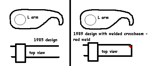

i actually got ones off a 89 toyota pickup... i realized in looking @ my broken ones that the part that broke has an open ended U type hape...... well, the one for the later truck, the 89 i got the parts from, actually has one side longer, and welded onto the otehr side effectively boxing the area that broke....
i think the parts i got are sufficient, however now that everything is back together, i realize my truck is now about 3-4 inches lower than it used to be up front! i think this might be due to the fact that the tbars might have been that badly cranked up, and thus caused the actual failure of the old part, or that the design is differnet on the newer ones..... hopefully its the first... its lower, but i still can pull u turns and stuff... i would rather have a working suspension and sacrifice tire to fender rubbing than tire clearance and sacrifice suspension parts...

finally made a drawing of the part i broke and the part i replaced it with... you can see the obvious change in design... well i think... hard to tell off a drawing....

ok here is the pic fixed better... for clarification
