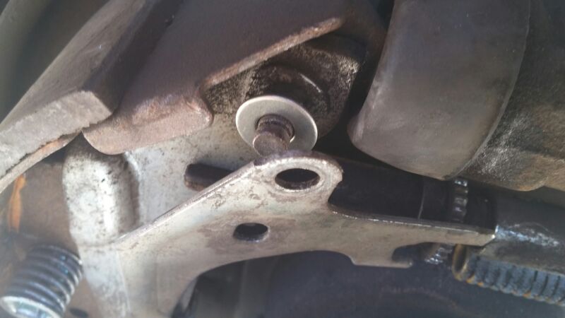

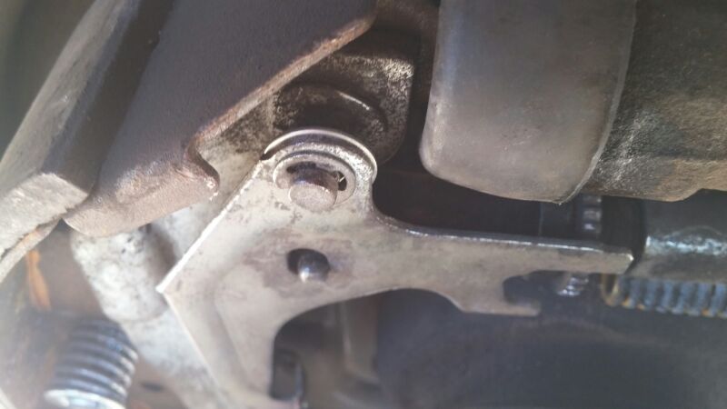

I fixed my drums over adjusting with a 1/4 stainless steel flat washer as pictured
So my passenger's side drum adjustment keeps over-tightening no matter what I do. Driver's side works perfectly. Backed off the parking brake adjuster ahead of the fuel tank lots so there's lots of slack when disengaged.
Everything's brand new aftermarket stuff from RockAuto, driver's and passenger's side. Dorman parking brake hardware. New Toyota OEM backing plates. Nothing's seized. Assembled with care following he FSM on the bench.
Wheel getting hot again after a while as do other's on here after yet again backing everything off and readjusting.
Can you elaborate with that little washer trick? I'm guessing it keeps the pawl from wobbling and over-tightening the adjuster?
