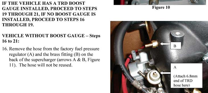

MT,
Does the brass nipple that comes out of the boost port come with the supercharger?
Does the brass nipple come with a TRD boost gauge?
I have a plug in the back of my 2nd gen S/C where there should be that 90 deg brass nipple.
Old Dec 7, 2006 | 03:20 PM
QSVeilside's Avatar
Joined: Sep 2003
Posts: 378
This is the part I need in the attached picture, (Part B). In MT's picture it is a 90 deg nipple.

The ones I've done, it came witht he supercharger.

The 90 deg fittting came from Ace hardware. The SCer came with a straight fitting but my heater hoses interfered with it, so I changed it.

Thanks guys. I'll try to find the right fitting at Ace.
