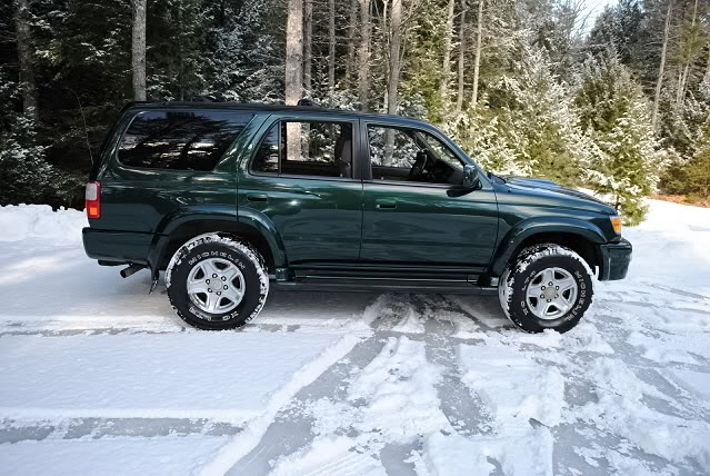

the 2000 4Runner we had sagged really bad in the back. Banged off the rear bump stops all the time even with fresh Bilstein HD's in it. Then I bought stock Moog replacement springs for the back from rock auto for like $75 for the pair shipped. Drove like a new truck after that and looked WAY better.
