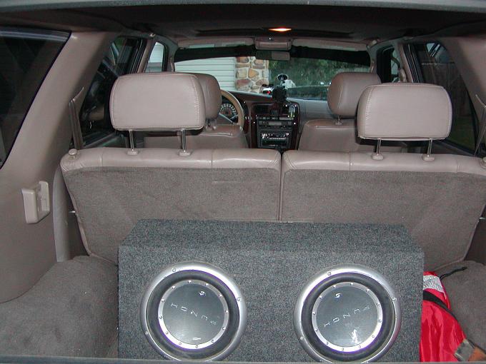

I have a 900w Fosgate mono-amp and 2 10" Fosgate P2's. I got the whole system from a good buddy of mine for like 40 bucks (brand new) like 5 or 6 YEARS ago and It's still plenty loud. I'm very surprised they've lasted this long. For my dash it's just a $100 JVC I bought for the aux input to play my iPod. Looking to upgrade but exterior comes first.

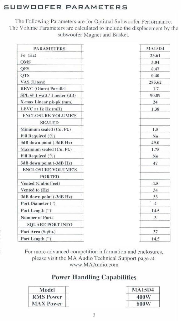

OK guys I think I'm ready to build a ported box. Remember my sub stats from page 2?
It says 4.5 cubes per sub. Tuned to 34hz. Do you think this is an ok frequency to have them tuned to? I was thinking more like 38 or 39hz. How would I calculate the correct port size for that frequency?
I'm imagining a finished product that will look just like 4rx's but upside down, in order to keep the subs below the window line. And instead of 6 cubit feet it will be 9 cubic feet.

SLYTLYSCRAMBLED, chea! congrats on breaking it! haha good thing is that i have my rearview mirror attached on the roof, not on the windshield. you are seriously underpowering subs. get the 2nd amp!
toylocost, most people prefer low tuned 30-34hz, but myself like high tuned to 40's hz just because I liked the way it is. maybe you could go to several car audio shop to listen ported box. are you sure you want a box that is tuned to 38 or 39hz? dont you want the port and subs firing toward to the back? i'm not sure what you are meaning of upside down, like SLYTY's sub box setup?
my new box will be under the window line as well

The only reason I wanted it tuned higher is because I listen to mostly rock. I figured it would be suited better for that frequency. If you think I would be good at 34hz I'll leave it that way because thats the measurements they gave me.

then go for higher tuning frequency...You need to shortening port length a bit.

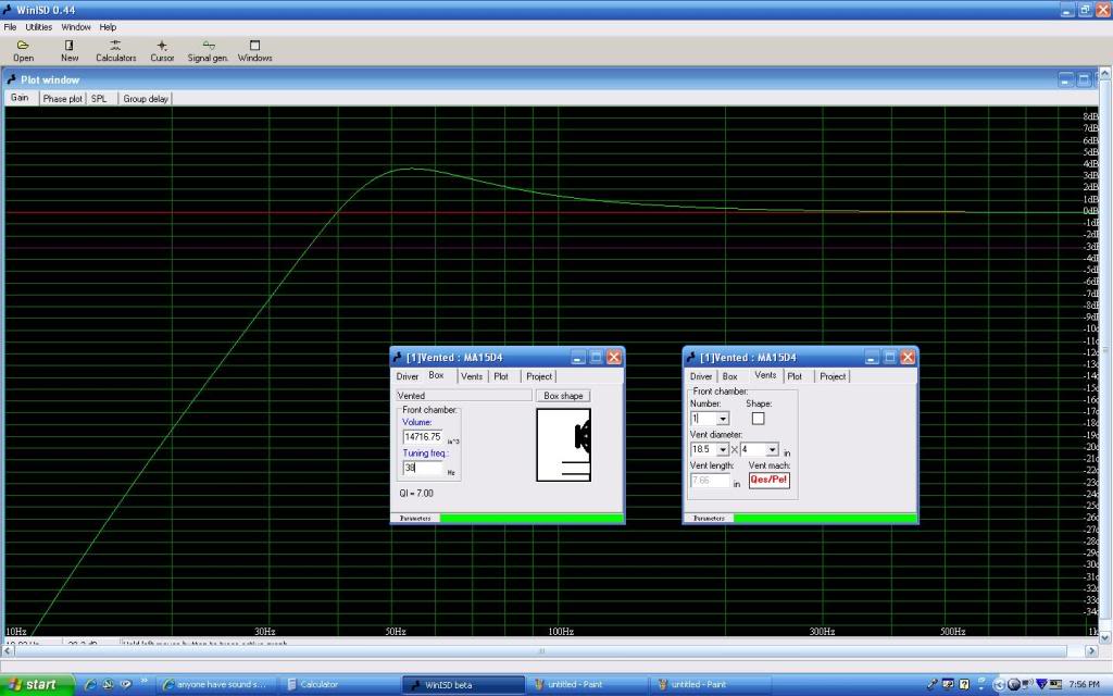

Thanks man. Ok so I think I have my box measurements down.
These are INSIDE measurements. Not including the thickness of the wood.
BOX - WIDE/TALL/DEEP - 43" X 18.5" X 18.5"
PORT - LONG/WIDE/DEEP - 18.5" X 4" X 7.66"
This was my best attempt at an 8.517 cubic foot box at 38hz.
Here is the WinISD screen shot. 4rx does this look good?

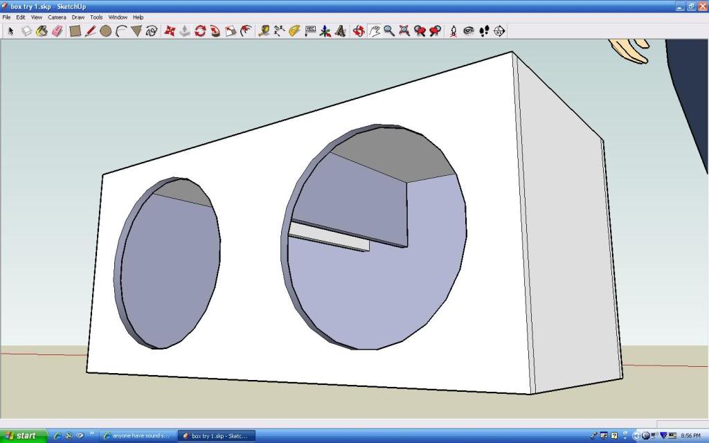

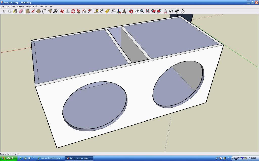

Couple renderings. After looking at this I'm thinking "How could that possibly be 8.5 cubic feet?"
