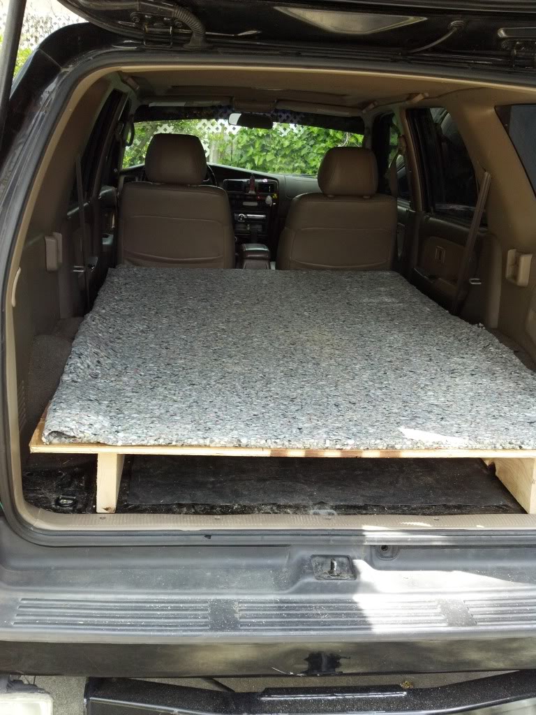

This is the carpet matting (two layers):

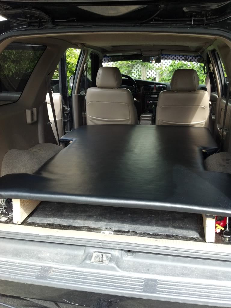

This is the vinal cover:

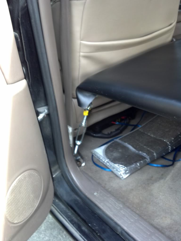

These are the front turn buckles keeping it anchored (there are two in the rear as well):

Very pleased with the outcome, sturdy, comfortable, lots of storage and room to sleep. Can't wait to try it out!
If you do a lot of camping in rough weather, surfing, skiing and/or don't always feel like setting up a tent or don't have a good place to do so, I highly suggest this. I can only guess it will be much better then sleeping back there w/o out it!
