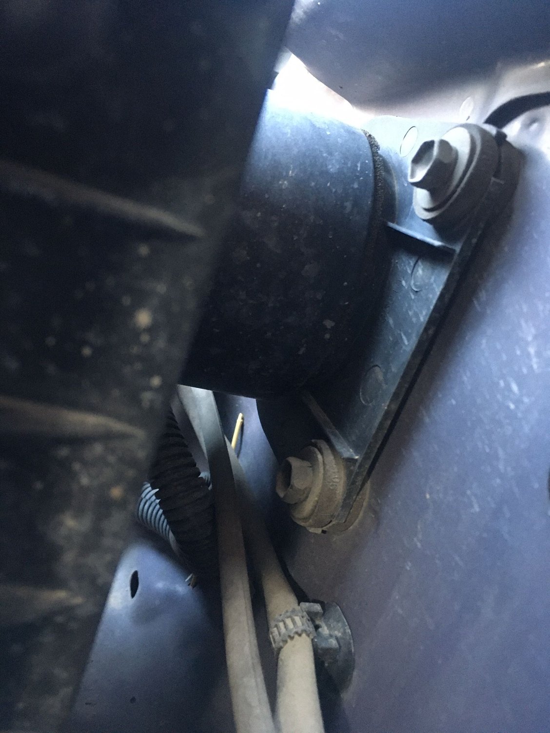

The 97 4runner 3.4L I bought had an aftermarket air intake installed. They removed the air box, where the filter sits and clamped on a generic K&N filter to end of the MAF. I'm in the process of removing the intake and installing an OEM airbox I picked up form a junkyard. To the left of the airbox, there is a hole in engine bay leading to the fender well and a 90° elbow running into the fender well. When I installed the airbox there is 2-3inch gap between the box and the elbow. I have to assume these is a small piece of pipe I am missing but can find no mention of it on any parts diagrams I have seen. Every part diagram I have seen shows the 90° elbow connecting directly to the airbox. The elbow on my 4runner is flush with the hole between the engine bay and the fender well. Anyone have any insight on this or pictures to show how that connection is made?

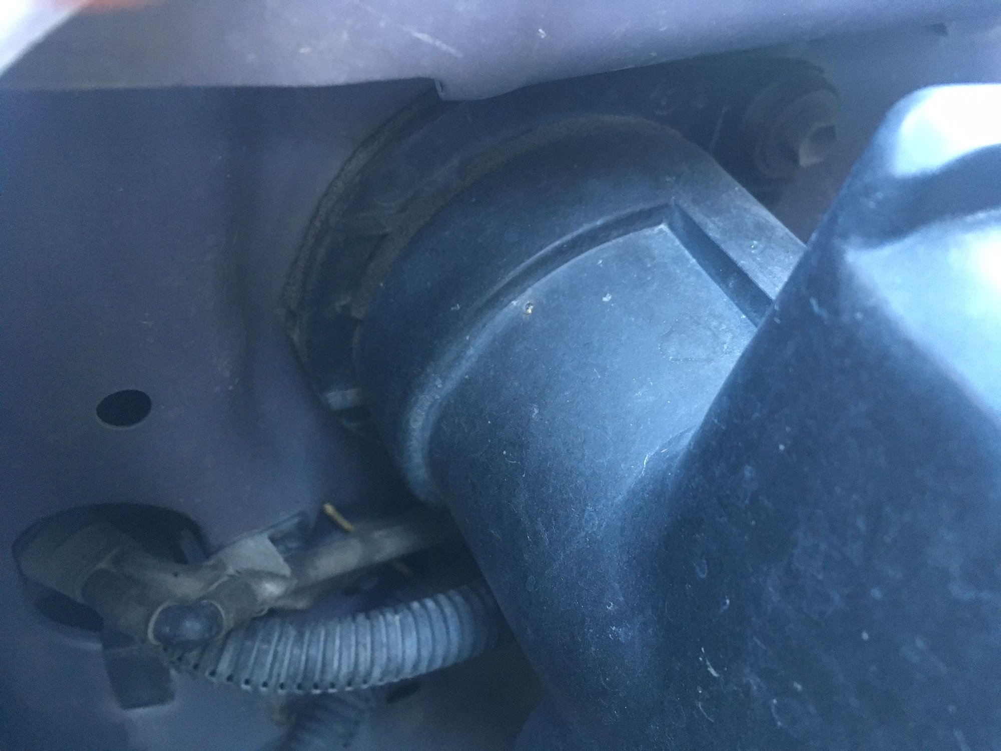

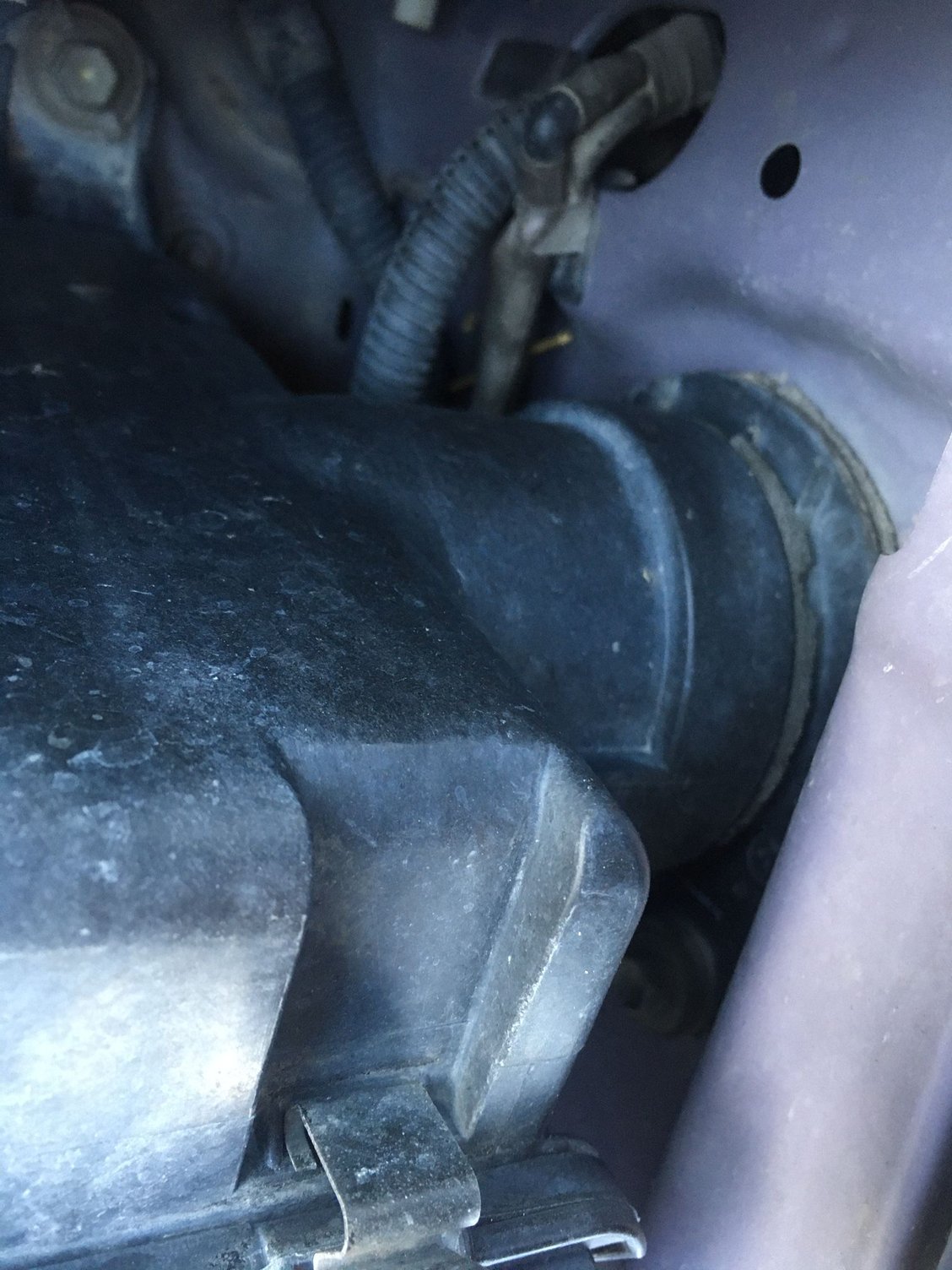

I'm assuming the 97 4Runner engine bay is the same as my 98 Tacoma...
This is a molded part of the box, not an attached pipe.

Thanks for the pictures! My airbox had the molded tube headed to the fender well. Looks like what I am missing, at the least, is the escutcheon that bolts to the engine bay wall. What is weird is I don't see that part on any of the parts diagrams.
