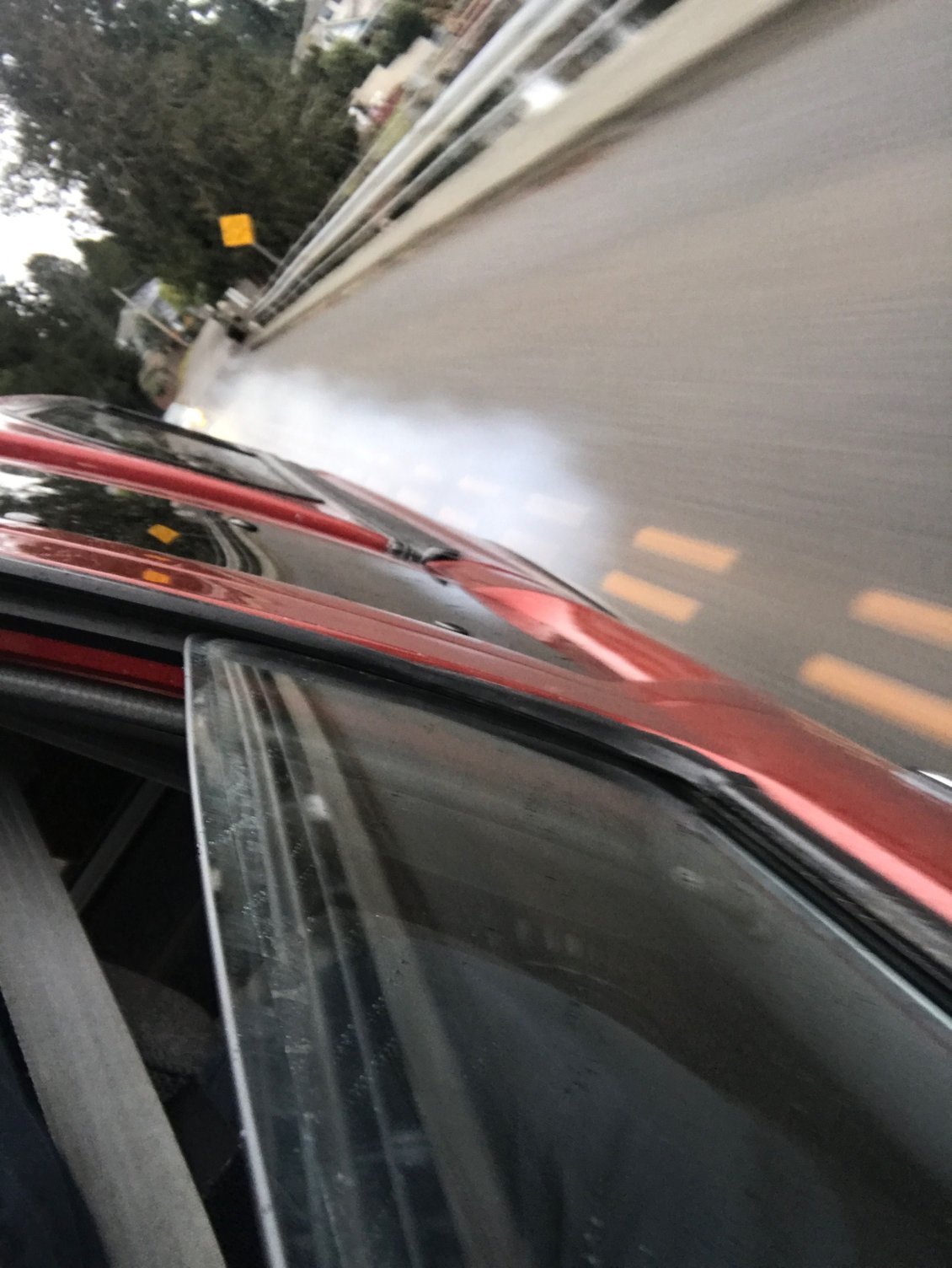

I took my throttle body off last night to clean it and while putting it back together on the intake plenum I plugged the coolant hose into the vacuum part of the TB on accident. Now I have milky oil and white smoke coming out of the exhaust. I drained the oil and let it sit over night. Today I changed the oil twice and did a coolant system flush, the oil cap isnt that bad and the truck isnt over heating nor loosing coolant. It drives perfectly fine but there is still clouds of white smoke. Does anyone have any ideas? second oil change and cooling flush while under load
After driving around with the second oil change and coolant flush
Idling after second oil change and coolant flush

What's the temperature there?
Are you sure it's not just normal cold temp exhaust?
There could still be a bit of coolant in the intake manifold.
Lucky you didn't hydrolock the thing.

I am pretty sure, when I accelerate it has a huge cloud of white smoke. And should I remove the manifold and clean it? I just don't understand how there could still be some left especially since I flushed it

There are two coolant hoses going to the IAC valve did you get those hooked up correct??
These are the only two coolant hoses you need to disconnect to remove the throttle body
The only two with clamps the vacuum hoses just slide on

This is an old dead thread, but Actually it looks like he switched the coolant lines for the IAC on the throttle body for the IAC to intake vacuum air assist line pumping rad fluid into the intake, he could have hydrolocked it now though.. Note his first sentence, "I took the TB off", no way would this cause a head gasket to leak, but the air assist and coolant line for the IAC is about an inch apart and easy to swap if you didn't pay attention

I'm aware of what hydrolock means, the discussion was concerning a head gasket leak after removing a TB, if you switch the rad fluid line for the IAC with the IAC vacuum line for the IAC you will hydrolock a engine with rad fluid, he had the TB off and it is likely he switched the line upon reinstallation since they are the same ID and the ports are 1" apart "Hydrolock occurs when a volume of liquid greater than the volume of the cylinder at its minimum (end of the piston's stroke) enters the cylinder. Since liquids are nearly incompressible the piston cannot complete its travel; either the engine must stop rotating or a mechanical failure must occur." rad fluid in any cylinder can cause this, even a leaky head gasket that leaks down when parked,
