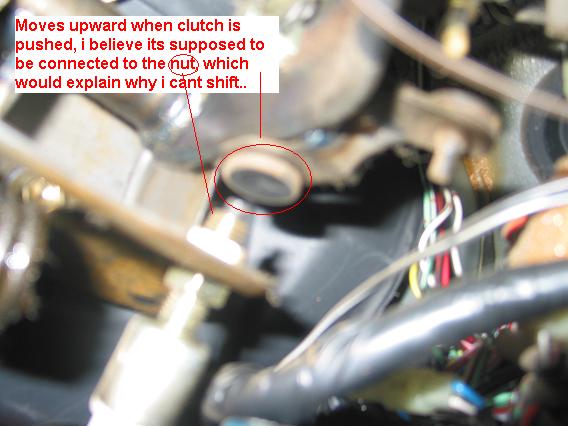

Latest Development in my Never Ending Shifting Story....
Friday 10:27am: Went out to see what I could find, Its really hard to wiggle into that spot between the seat and the dash, but somehow i managed. Got up to looking in there and pushed the clutch in and out. First thing i noticed was This (see attached picture)... I believe it has somehow gotten loose and that is causing my problems? Im assuming they are supposed to be connected, when i release the clutch they butt up right next to each other, but when i push it down, the clutch moves away. The metal ummm rod? is threaded so im guessing that its supposed to be threaded into the whole? Could this be whats causing my probs?
Old May 28, 2004 | 09:34 AM
boogyman's Avatar
Joined: Jul 2003
Posts: 662
From: Sacramento, CA
Talking
kinda hard to tell from that picture, i can't quite get oriented..
anyway, my first thought when i read the original post was either the spring or the bracket on the clutch pedal..
if it is the spring or the bracket, it can be easily fixed (without replacing the bracket) by replacing the torsion spring with a linear spring from home depot... there's a thread around here somewhere..
-Russell
Old May 28, 2004 | 10:28 AM
Dryheat's Avatar
Joined: Oct 2003
Posts: 34
Seen this before
Could it be the clutch release fork that is broken or has come off of the pivot point in the bellhousing? The slave cylinder is moving correctly but there is nothing holding the clutch fork to it. This is the fork that is attached to the throwout bearing. I've seen these forks break(but not on a 4R) and also the clip that holds it to the pivot point. See if the lever is wobbling freely. Take the rubber boot off of it and you may be able to see inside.
It may also be the plate under the dash. My brothers 90 4runner had that happen. He was going to replace it before it got totaled.
Paul

Old May 29, 2004 | 10:42 AM
nolongeraneqaddict's Avatar
Joined: Apr 2003
Posts: 329
Well me and my friend, went down to a Dismantler and picked up a new Clutch Slave Cylinder: $25 some Dot 3 Brake Fluid: $2. Went home put the new Slave Cylinder in, bled the lines, and Adjusted the clutch a bit, It runs better then it did before now. Thanks for all the help guys. Only took us about 30mins to install it and bleed the lines. Took 45mins for the guy at the dismantler to unbolt the 2 screws that hold it in... Think he had a lil to much before work...
