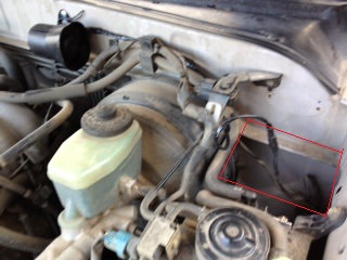

And the available space I have to fit in a fuse block, you can see I all ready relocated the alarm horn:

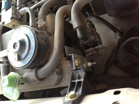

So, first things first, I need to modify a few minor things to free up some room. Fab up a quicky bracket to drop these lines a few inches. A Vice and a BFH made quick work of it.

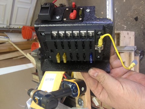

Next, I picked up some puckboard (thats High Density Polyethelyne sheeting to you Americans) and fabbed up a mount for the FuseBlock, Relay, fuse, and Circuit Breaker. For anyone who has not discovered the wonders of puckboard, it is pretty awesome. A heatgun and a dremel tool made short work of this. Incidently, the yellow wire is just left over from testing, All the power wires are 8 guage.

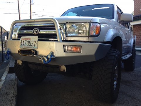

First of all, My rig:

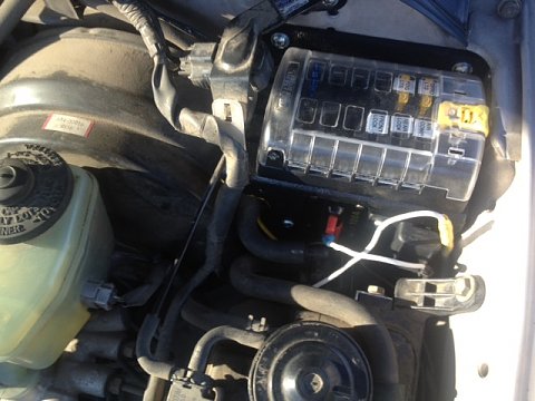

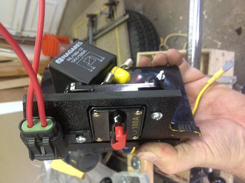

And Installed:

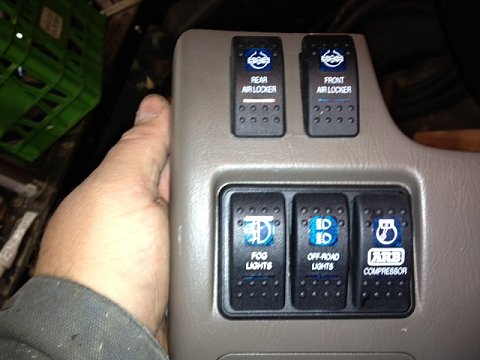

All so I could do this:
Just have to connect the few wires, and good to go.

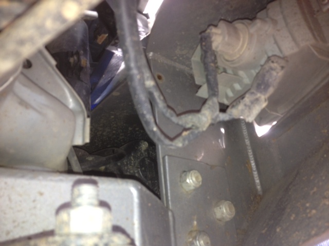

I can tell you from running a amp wire through the grommet on the firewall under where you mounted your box that area on mine gets a lot of water when it rains. I didn't get the grommet sealed up good and water run into the floor. Of course if may just be bad seals on my cowl letting water into the engine compartment. Just a heads up incase.

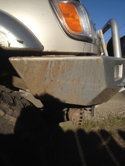

Originally Posted by afartinthewind
Looks tough as hell, what do you think it weighs? I don't want to toss on 75+ without a rear to balance it out. thanks again.
I think it weighs aLOT. I haven't pulled it, but from pulling the rear off, (4" square tube with side skirts), I am guessing the front is somewhere around 150 lbs.... NOT including the winch.
I will see about some pics and dimensions for you. I have a 1.5" body lift, so take that into consideration when it comes to the mounts.
J.

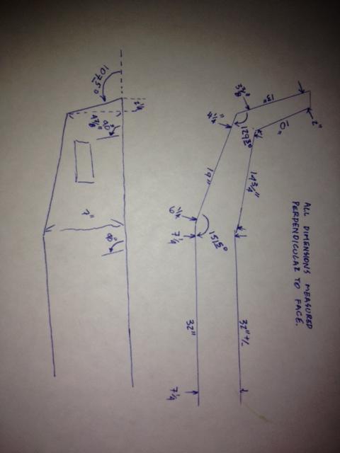

Farty,
Sorry to take so long getting back to ya.
Here is a sketch of the top of the bumper.... should be a good starting point for the frameup.

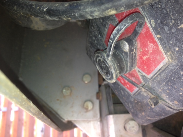

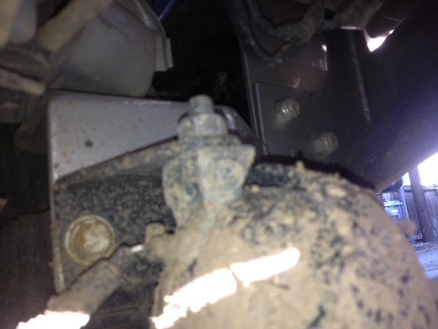

And starting from Passenger side rear:

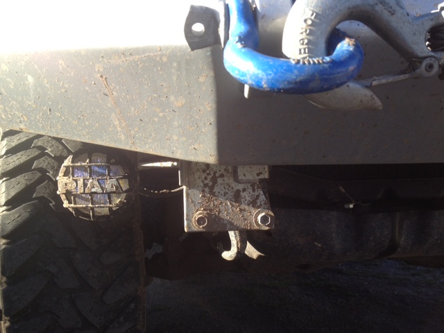

Mount from Pass side looking in. The Fog light mounts utilize the bumper mounts as well, so one of the 2 bolts is hidden by the light.

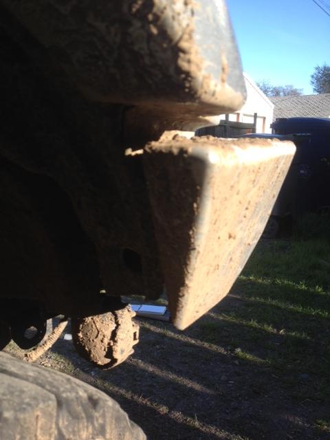

Front Shot of Mount

Old 04-21-2013, 05:00 PM
afartinthewind's Avatar
Join Date: Feb 2013
Location: Portland OR
Posts: 48
Received 0 Likes on 0 Posts
your the ˟˟˟˟ man! that should do just fine. well done on the drawing btw, very clear and exactly what I was hoping for. thanks a million, I was afraid to be caught measuring some strangers rig in a parking lot and you just saved me that encounter.

how's that Blue Sea fuse box been working for you so far?
Fuse box is working Just fine. The plastic is holding up just fine with the heat, I should find out in the next few months how it handles the cold.
