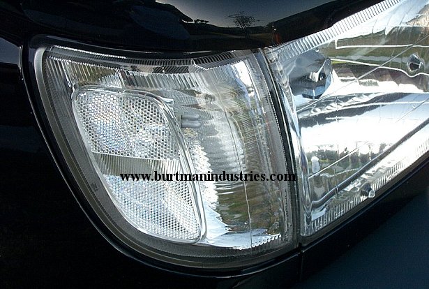

Why don't you just get the 99-01 grill, headlamps, tail lights, Mr Burtman clear corners and bumper lenses and the PP spoiler. All of it is swap and bolt on.
Gee. The above items sound just like what Jason's has on his rig.

After you add those you will want to upgrade your front corner lenses so they match the see-thru heads. I do sell these as well as the bumpers:
4x4-runner
