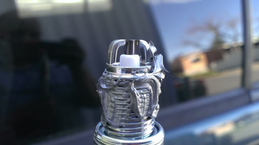

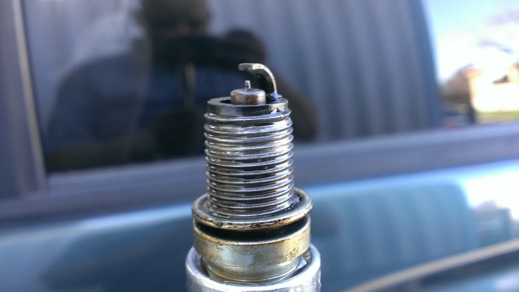

UPDATE!!!!!!!! Thank you guys!!!!! I went and bought the PB Blaster and let send overnight and it work!!!!!! Well, with a little of elbow grease too but I did it.. Change the spark plug and no more codes!!!!!!!!
spark plug #3
new one with a lot of the anti?
and the next thing i'm replacing on the engine... but why are soo expensive?????
http://shop.advanceautoparts.com/web...923%7CL2*15034

Nice job getting the old plug out. Good idea with the anti-seize, but try to keep it on the threads only, lol. And like chadsy said, you probably have a leak somewhere.
