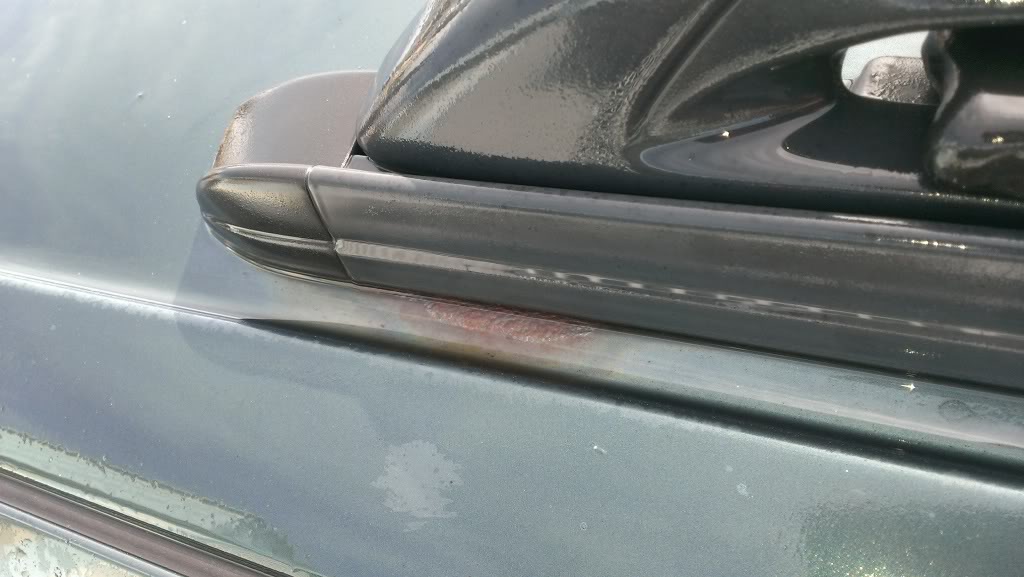

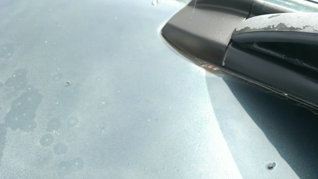

I just found out the my runner has rust on the roof. I read a few post about this problem been pretty common on this model. I guess it was too good to be true on the price.. Now I don't know what to do about it. It has rust on all four conners of the roof rack....
On the leak situation, it looks like it is leaking for the thersmostat housing... Like between the water pump and the block... It doesn't leak too bad and doesn't over heat. But it is kinda annoying.
On the key problem, I bought the runner from the bay area. So I put some wd40 in the key hole to clean the interior and didn't work.. Did I made it worse? does it have any sensor inside? and can I take off the part from inside or outside?
here are some pics of the rust and the leak.

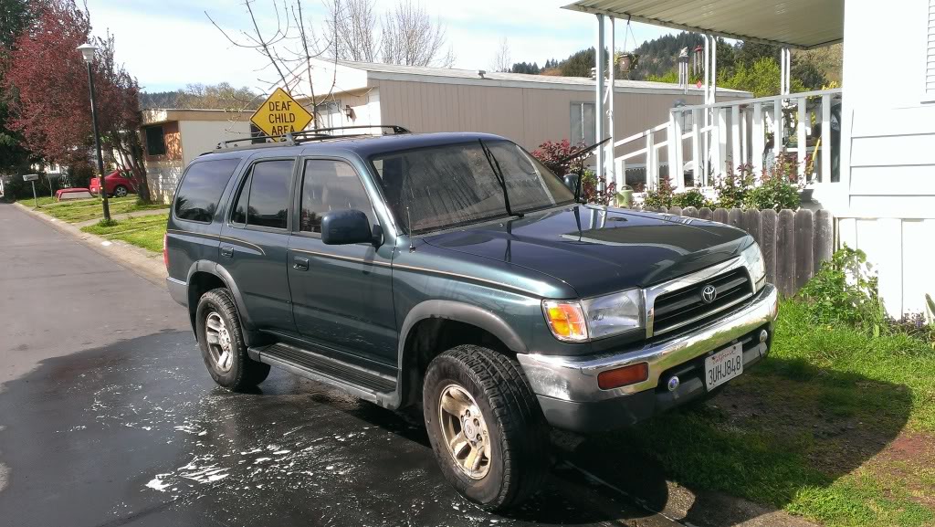

and after I wash it
[IMG]http://i966.photobucket.com/albums/ae141/7nor0
cal7/IMAG0289.jpg[/IMG]

after washing it

She looks pretty good. Despite the rust and water leak, you didn't get ripped off for only $1500. You could sell it right now for a profit if you wanted.
If you're really worried about the roof rack rust, pull the roof rack off and have a look at the spots closer up. You could probably pull the roof rack and spend a few hundred bucks at a body shop having them clean those spots up. Stopping the rust before it eats through too much of that metal would be ideal.
If the water leak isn't slowing you down too much, you can keep refilling with coolant and live with it. When you want to tackle a project, you can get a new water pump gasket and/or water pump and replace the old stuff. It's not too bad of a job, and there are extensive writeups around here.

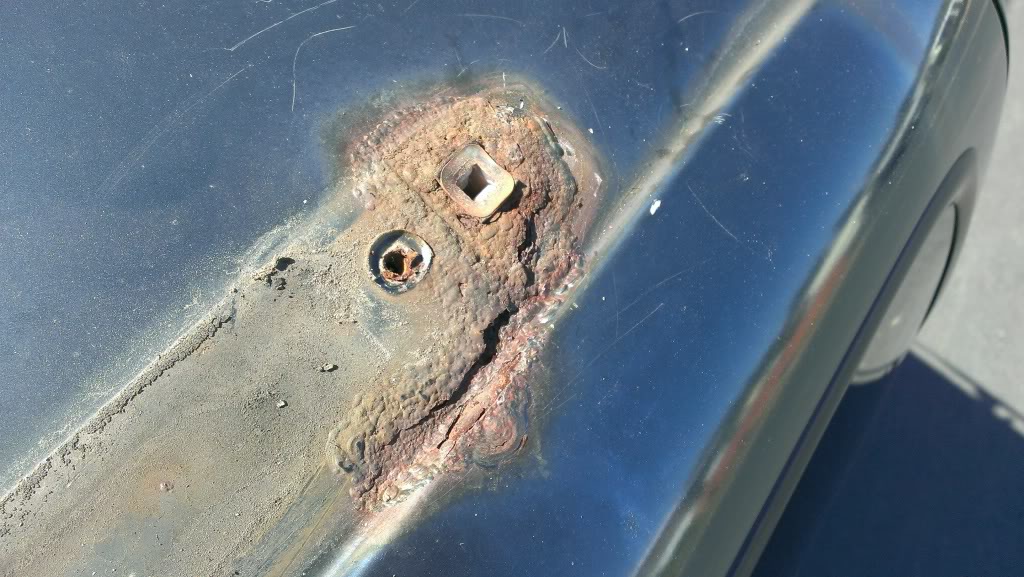

well, I had some time to take the rack today and doesn't look right so I took it to the only body shop in town and they told me it needs a roof job which would run me between $3k to $4K.... I asked them if we could patch it and even that would be around $2k.. now I don't know what to do... Im going to ask more around, but here some pics
this is the worse spot of the roof
IMG]

I'm far from an expert in this area, but the roof is made of basically sheet metal. I would think that it would be possible to cut out those rust spots and weld some new metal in. They don't seem to be that big relative to the size of the roof. Then do some body work on that metal and make it match half-way decently. I wouldn't care if the paint was off or whatever, it's the roof and half-covered by the rack. I figured a body shop would be willing to do something like that, but you may have to get more inventive than taking it to the local body joint.s

I agree. Doesn't seem like too big of a deal. That could be cut out and have something else put in. You could even just take an angle grinder and take as much rust out as you could and then use a rust treatment, then patch up the rest with fiberglass or bondo. Definitely not the right way to do it but it would buy you a couple years. If you didn't worry about putting the rack back on it's even easier.

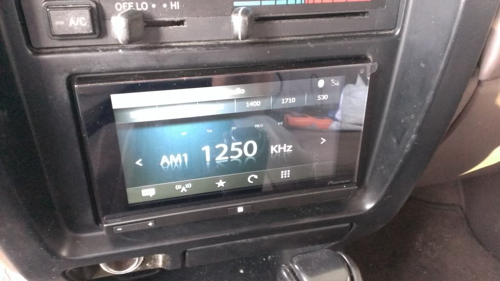

soo I installed a nice stereo for nothing...hahahaha.... I was surfing on the net the other day and saw this great deal on a pioneer app radio and decided to buy it.. when I installed, I couldn't play my old ipod.. this stereo only works with the Iphone 4 and up or the ipod touch 4 gen... which I don't have any of them... luckily my coworker is buying it from me for what I paid.... I already order anpther one.
