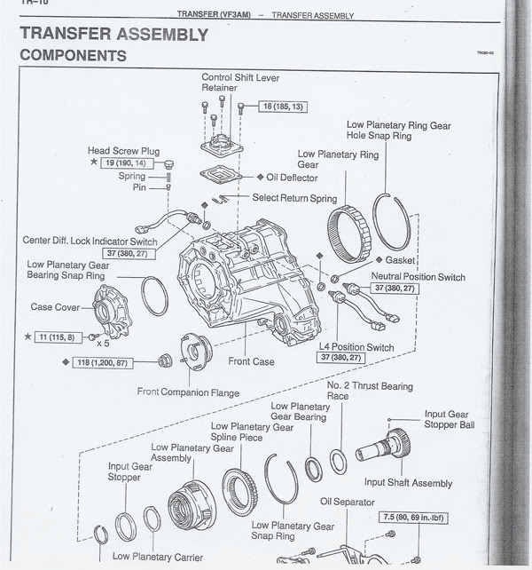

There are a few sensors on the TC you're going to want to check.
The sensors marked center diff, neutral position, and L4 switches need to removed and checked. It's a pain, but is likely your issue. Also, there are two very easy to get to sensors on top of the TC actuator that should be checked anyways.
Also, always a good idea to change out your diff and TC fluids if it hasn't been done in a while. Simply changing the fluids solved my issue.
