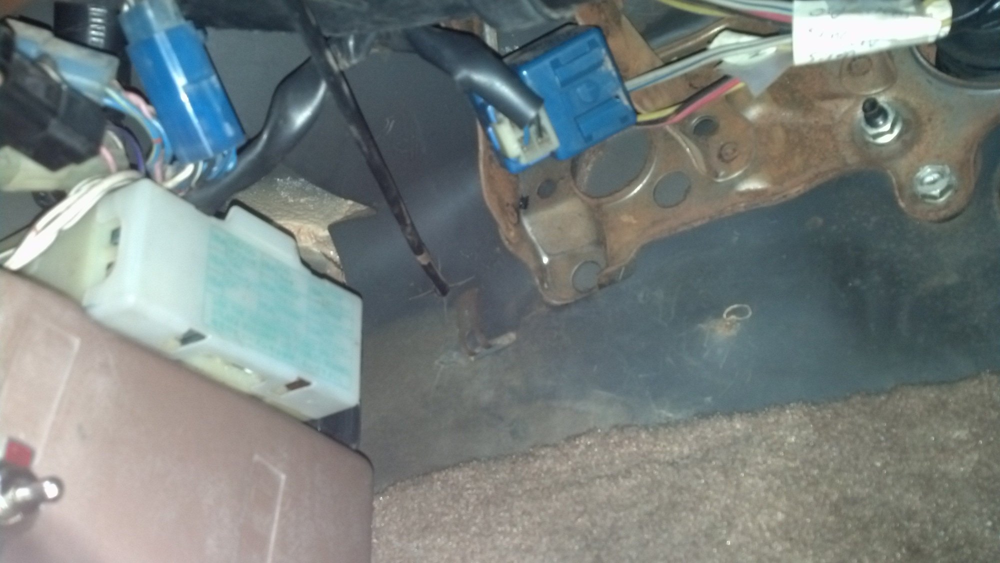

I will edit this post later.. But I seem to remember something like this. On my 86 sr5 it had a transmission relay that went bad. On mine its a blue ( I think its blue) box about 2 inches big its above the and to the left of the break peddle( where the clutch peddle would be. )
Like i said i will edit this later once I look at my notes.
Maby it was the overdrive relay. ( I had the work done , I did not do it my self.) It might be on the transmission. Mine worked worked fine with the over drive off.
yeap that was it, I could only be checked 160-195 deg.. if they did not catch it that had to let the truck cool down and start over. Cost a lot to get it figured out.

So you are saying for you, It was the transmission relay? Did you ever figure out if it was on the transmission itself or by the brake pedal? My transmission seems to work differently when the engine is cold vs when warmed up. Seems to work better when cold.

Awesome obmi! Thanks for the photos and part number!!! I was in my dash looking for that relay last night and couldnt find it! All I could find was my O/D Relay. Any insight on to where it is?

I don't know of this is the original place. But this is were it lives now.
Near the fuse box
Just above the foot "Thing"
About as high up as the steering wheel.
Near the fuse box
Wow thank you for the photos and help. It looks like Your Transmission relay is where my O/D Relay is plugged. Ill check if the part numbers are different. Thats pretty much where my O/D relay is at with the same type of male plug, except my box is Black and says O/D relay.... Maybe the Previous Owner has the wrong part installed in there. Thank you so much for the help!!!!!!!!!!!!!
