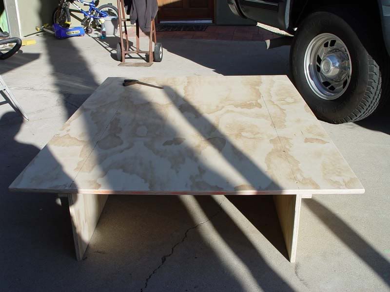

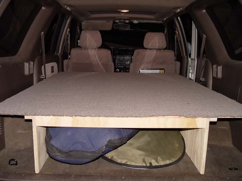

So I've wanted to do this for a really long time. Every time I try to sleep in my 4runner, it pisses me off because of the uneven surface that the seats make. I do a lot of camping trips, a lot of long trips to Baja too, so I wanted something sturdy and lightweight, so I could store my food underneath in rubbermaid bins, so mice wouldn't get into it at night.
For the city, I'll keep it in 95%. I always keep my surfboards with me, and am always sketched out about having them in view in the back, so I made this in mind to being able to keep my boards underneath there too, so you can't see them.
Its not quite done yet. I'll be adding another section that will go vertically holding up the front end towards the front seats.
All I used was ONE piece of 4'x8' high quality 7-ply, plywood. Its really nice stuff actually.
I also might add some turnbuckles on the sides to keep it held down, but, the thing is kept in place, I really doubt its going anywhere, especially if I have my truck loaded down with gear.
$27.00 for plywood
$16.00 for carpet
Its 5'10" long, 48" wide, and 10.5" high. The rear needed to be scribed down to about 9" to keep it all level.

Pretty cool... do you get any sagging with the aquired weight?
Old Feb 23, 2007 | 06:43 PM
BajaRunner's Avatar
Joined: Apr 2004
Posts: 7,122
Likes: 6
From: 5th Gen San Diegan, California
Its about 50-60 lbs...so no

its super cool that you can hide those surfboards under there. solid design. I used to keep my fishing and spear fishing gear in my 4runner when it was back at home in Hawaii, but was always sketch about it in plain sight and a cargo cover wouldn't hide it all. nice job.

Yeah, an air mattress would have worked, but, I still need storage inside while I sleep. Coyotes and mice are pretty desperate in Baja when it comes to food, so nothing can be left outside.
