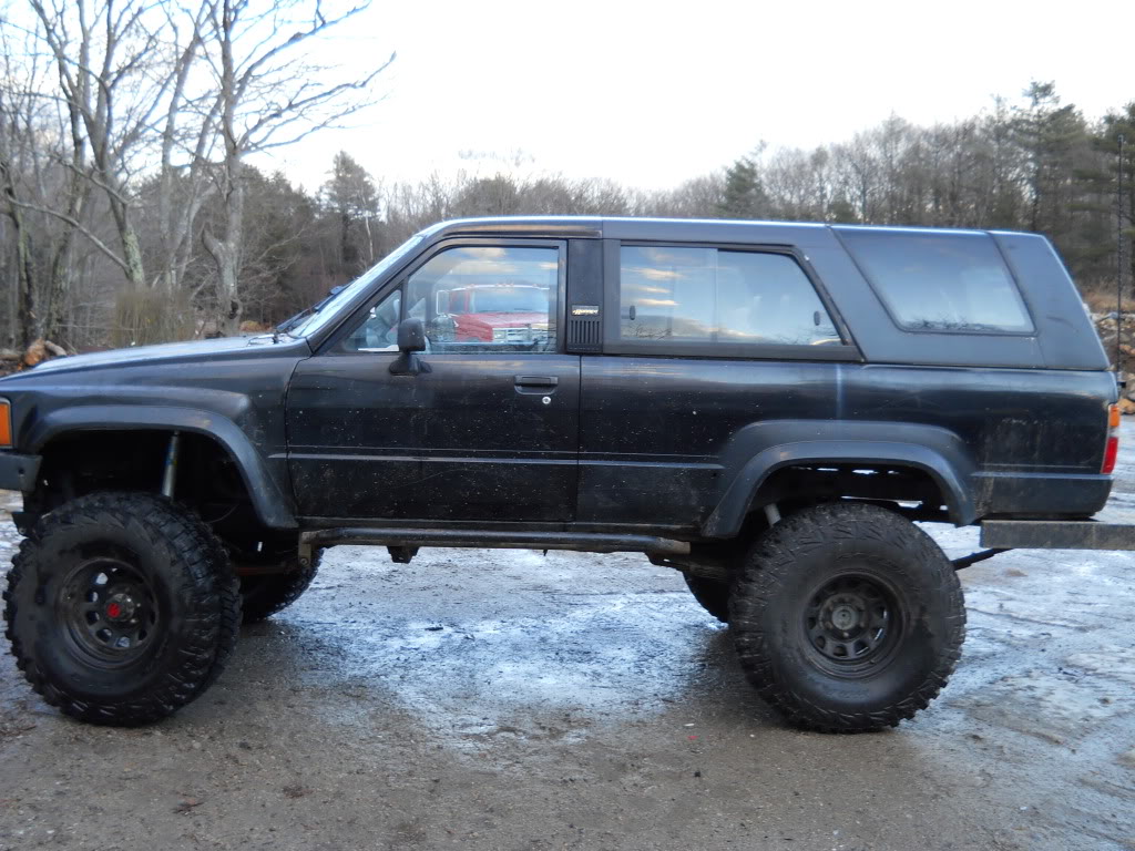

ok so i got my first 4runner back on 07 it was a 89 v6 5speed had it for a school project after getting it running and learning how to wrench on Toyota i fell in love but a blown t case and 300,000 on a v6 and not to mention the body rot and frame i had to get rid of it

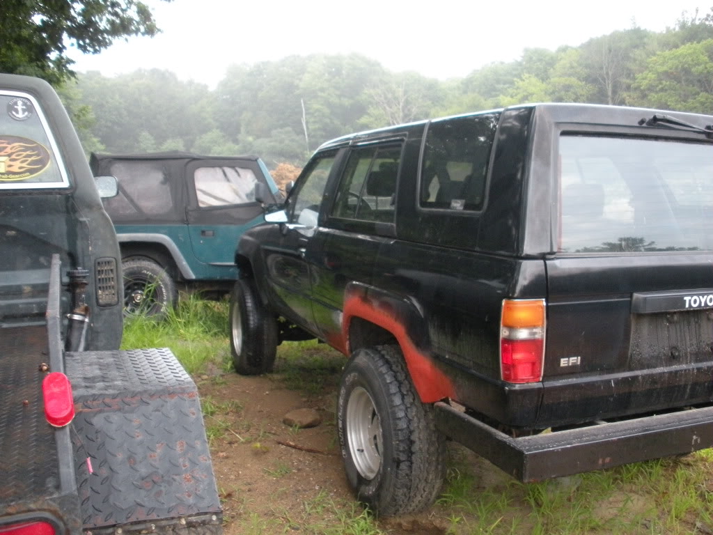

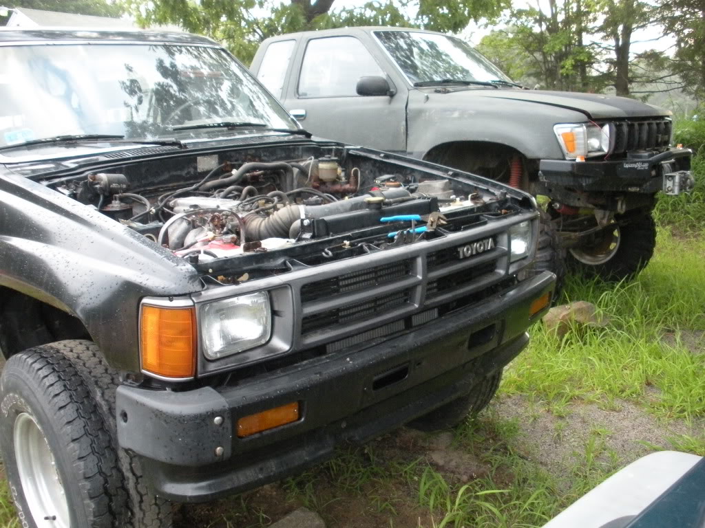

but in 2010 i picked up my 87 dlx from a friend and a fellow forum member riddarunner i had a great frame 22re 5speed with about 200,000 on it i could no pass it up the body was a little rotted but about a week of working on it after work all the cancer was gone.
when i first got it

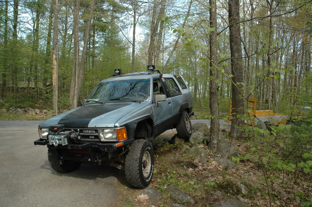

after getting it on the road i made up a plan for the truck i wanted something i could wheel on the weekends and drive to work on Monday i wanted a rig i could load up and go camping gear and take off for a week i wanted to be able to through my skis on the roof and be able to drive 4 hours chasing fresh snowfall i wanted a truck that i would have a problem going anywhere.

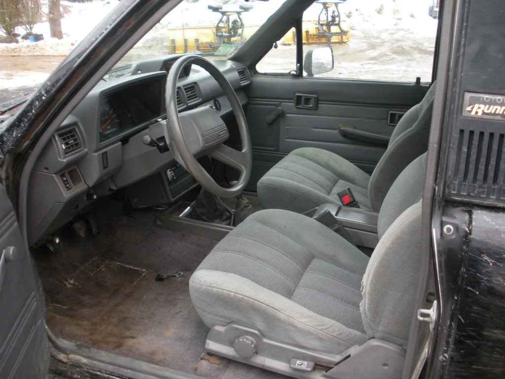

i started with finding good sr5 interior i like to wheel in comfort my friends call it the luxury crawler after about scavenging 4 or 5 truck interiors i go all i needed
the sr5 seats when i put them in

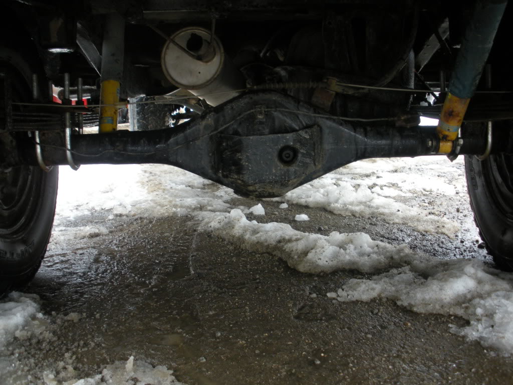

time for my first pieces of armor picked up sliders a rear diff cover and a ubolt flip do mind the exhaust it another thing replaced long ago
and after about 6 months it was time
bye bye

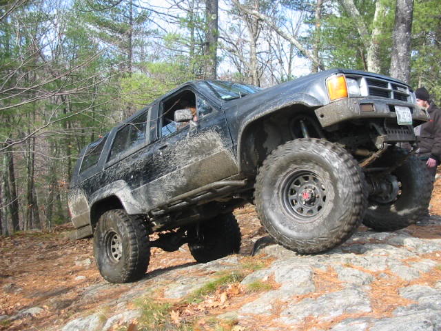

end result with my 35 mtrs

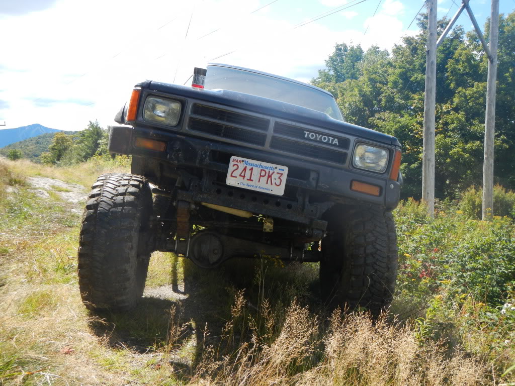

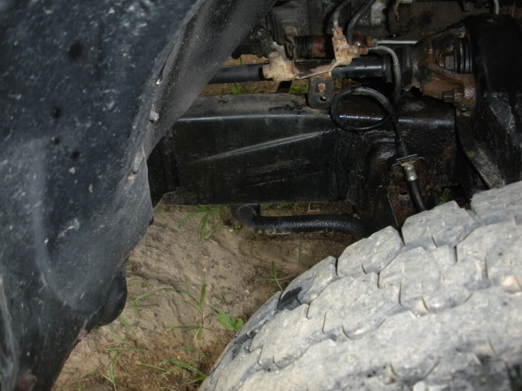

first time wheeling with the sfa and my true track in the rear i had 4.10s at the time

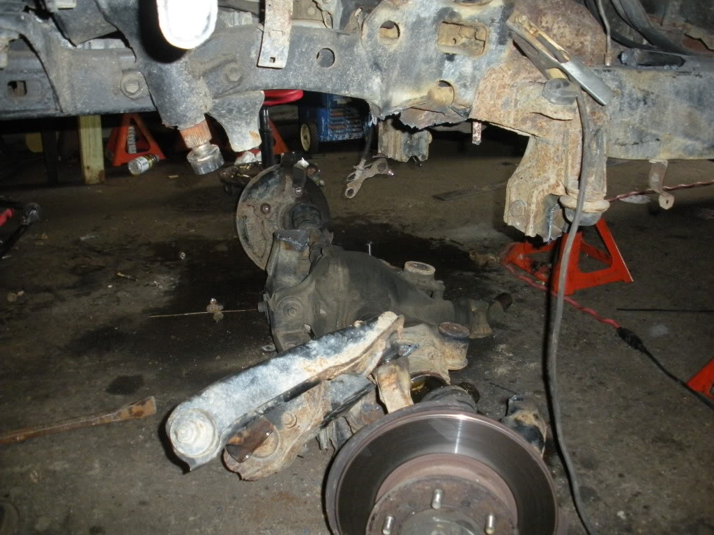

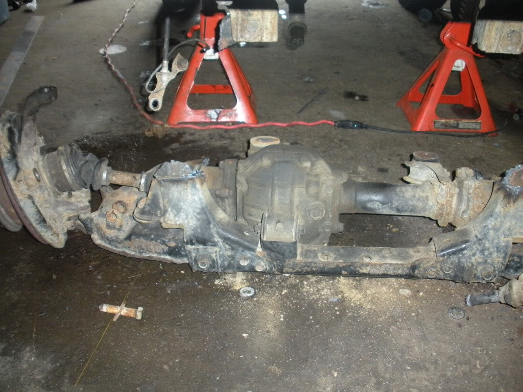

after awhile of driving on 4.10s i got sick of basically having to dump the clutch to move and down shifting to 3rd when i hit a hill so i picked up 2 sets of 5.29s one for my diff with the truetrack witch would be in the front and one for the e locker diff i picked up off of a yota tech member didn't really take any pictures of the install well none i could find but im sure you all know what it looks like.

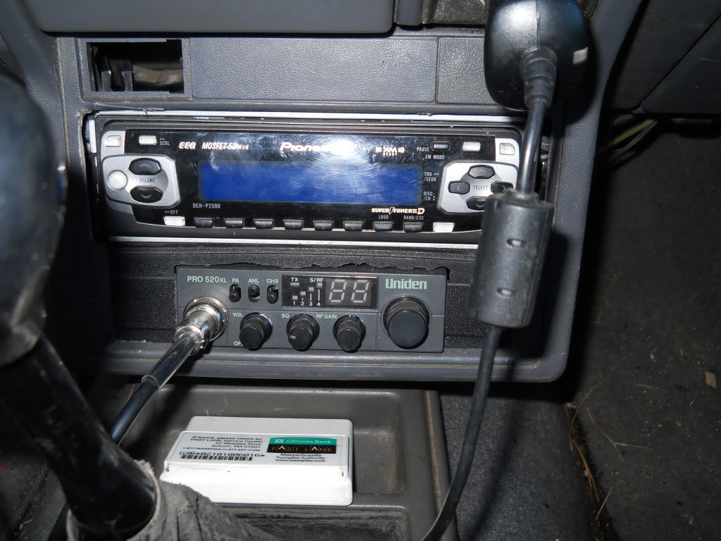

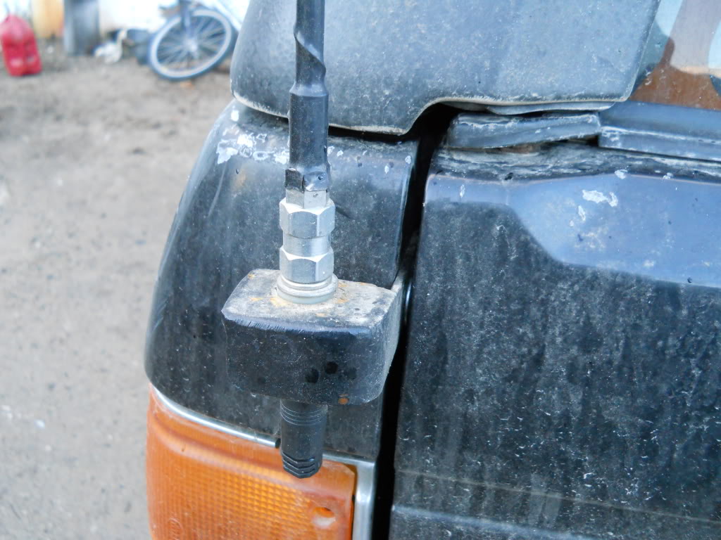

mounted a cb

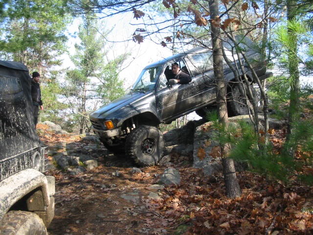

meeting of the minds
flexing out a little

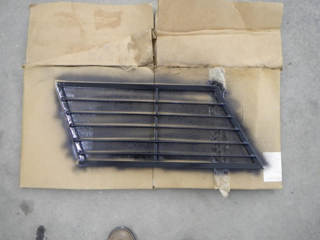

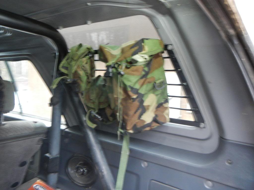

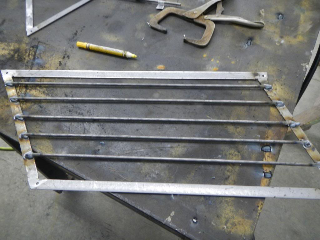

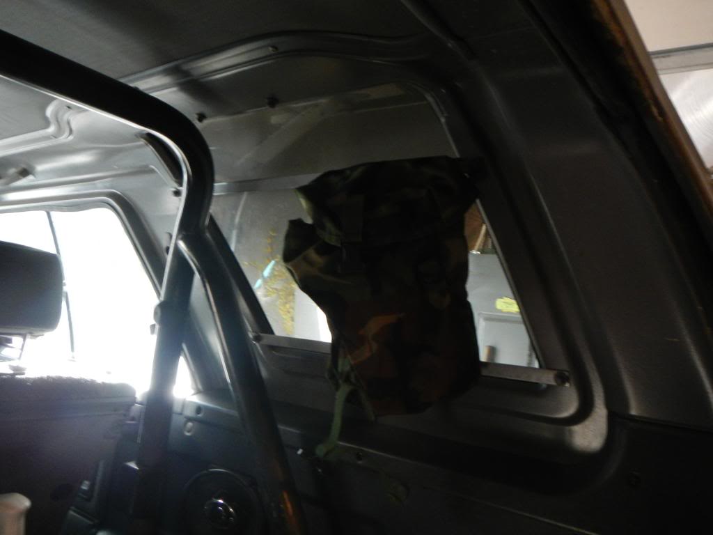

i decided i needed a better way to store gear in the back to maximize my space so being in the army i have a bunch of old Mollie gear that i no longer need so i wanted a system to hold these mollie bags
design
build
paint
mounted
and all done
now i can store rain gear and first aid that i can easily access with out digging around in the back

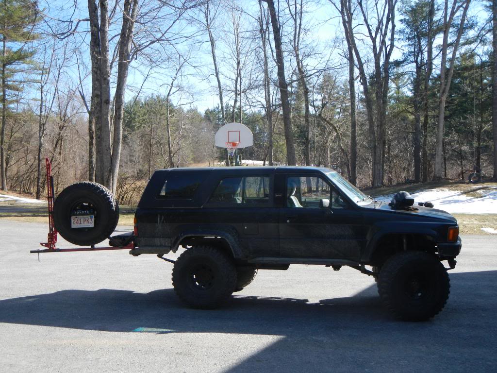

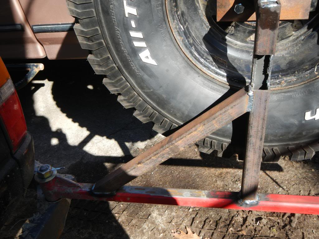

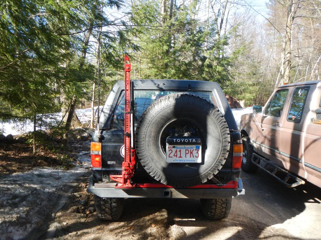

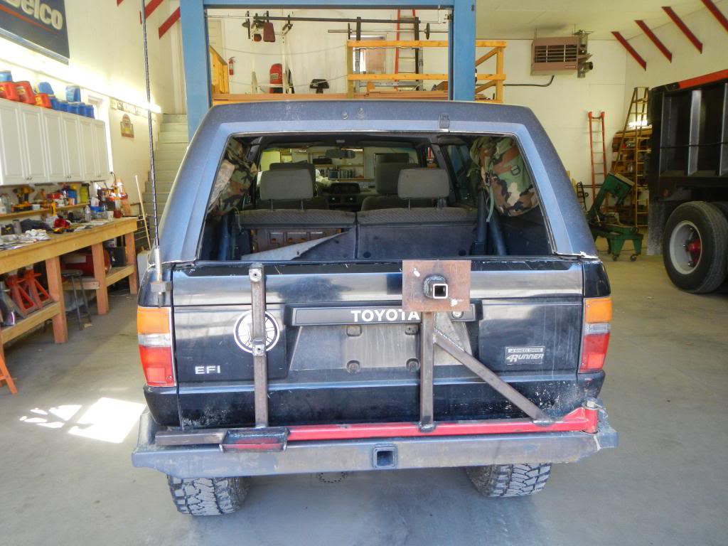

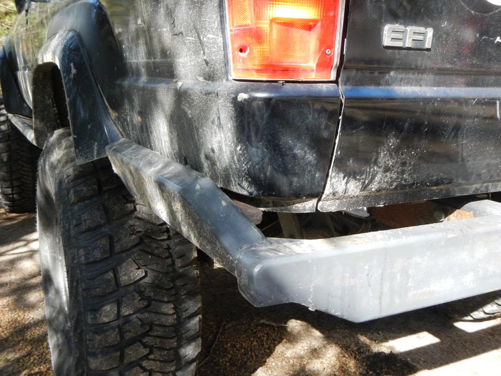

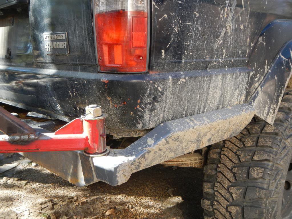

so i used to store my spare tire and my high lift in the back of my truck well a 35 takes up a lot of useful space so i decided to build a rear tire carrier swing out but i needed a new bumper while i was at it so we started to build
removed the old rear bumper and cut exhaust to fit the new mounts
http://i1234.photobucket.com/albums/...ps311b71e3.jpg
cutting out the new mounts 4 total
http://i1234.photobucket.com/albums/...ps931e7cb1.jpg
tacked into place for measuring
http://i1234.photobucket.com/albums/...ps4b148238.jpg
unfortunately some times i get to deep into the fab work and stop taking pictures but the next day i took a few more of the bumper

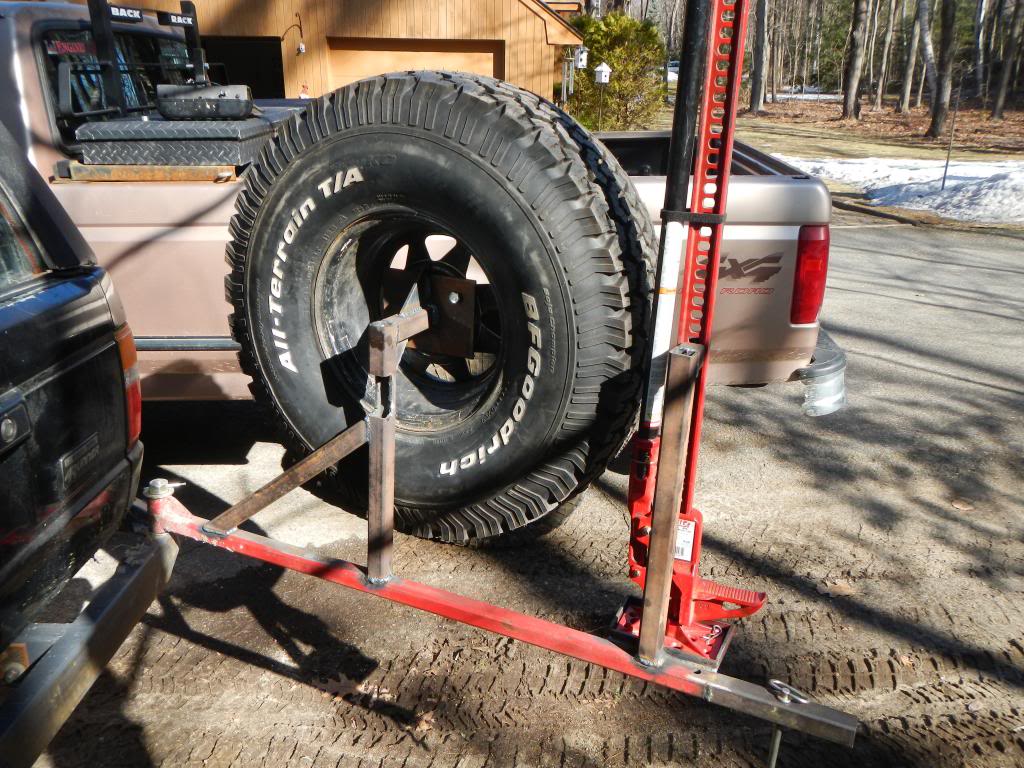

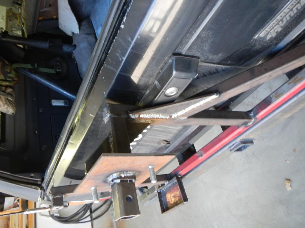

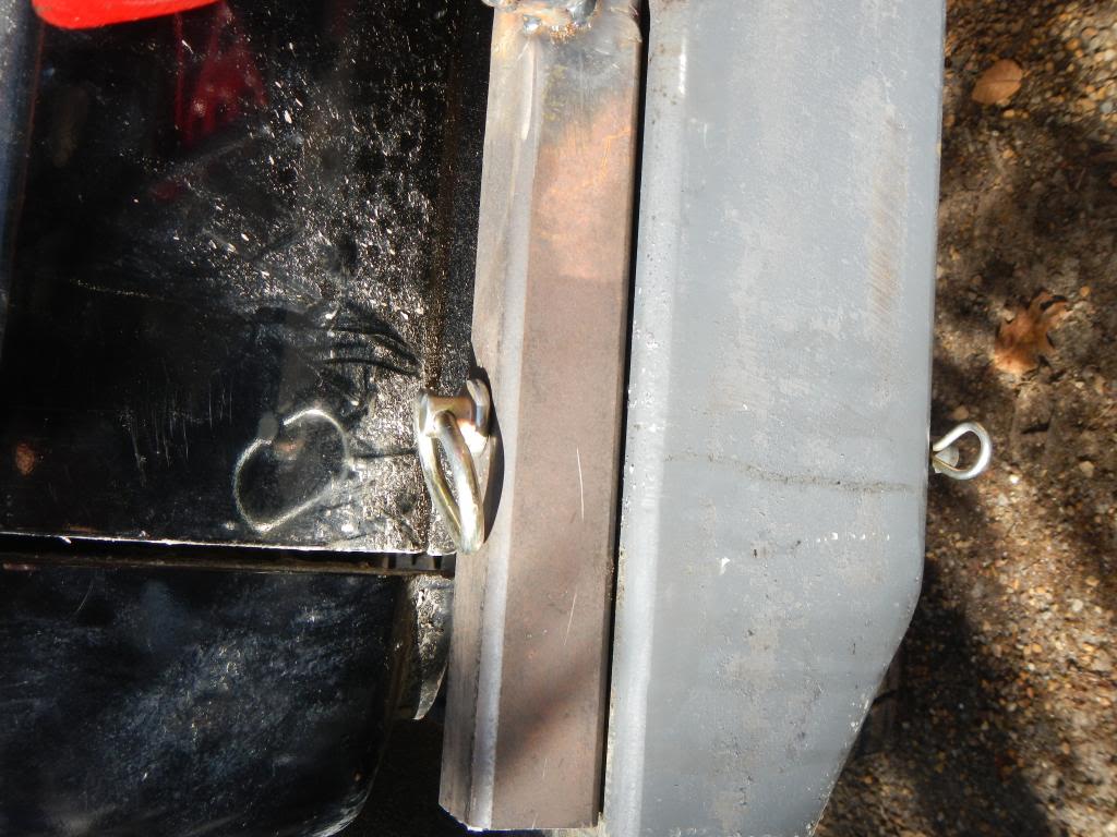

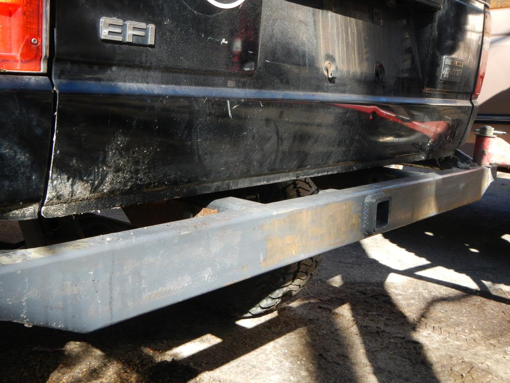

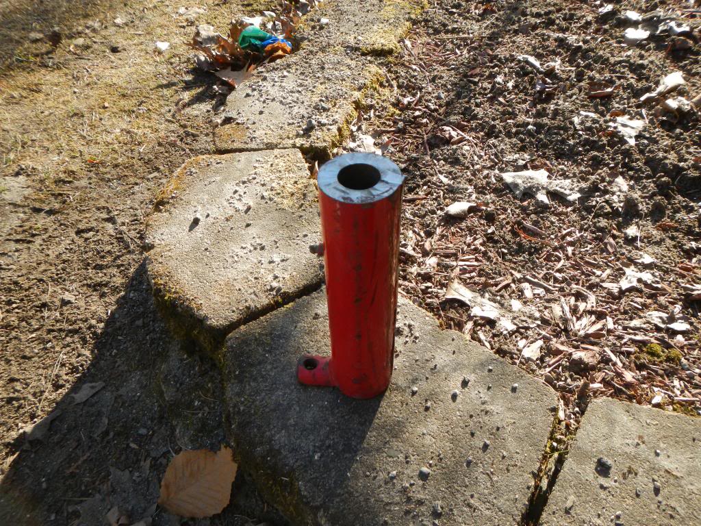

now on to the swing out the plan was to punch a 1 inch bolt through the bumper to attach the piece to tube i got that was scrap tap it with a grease fitting and start the build i took more pictures this time
mocked up had to add a few more gussets but i ran out of steel

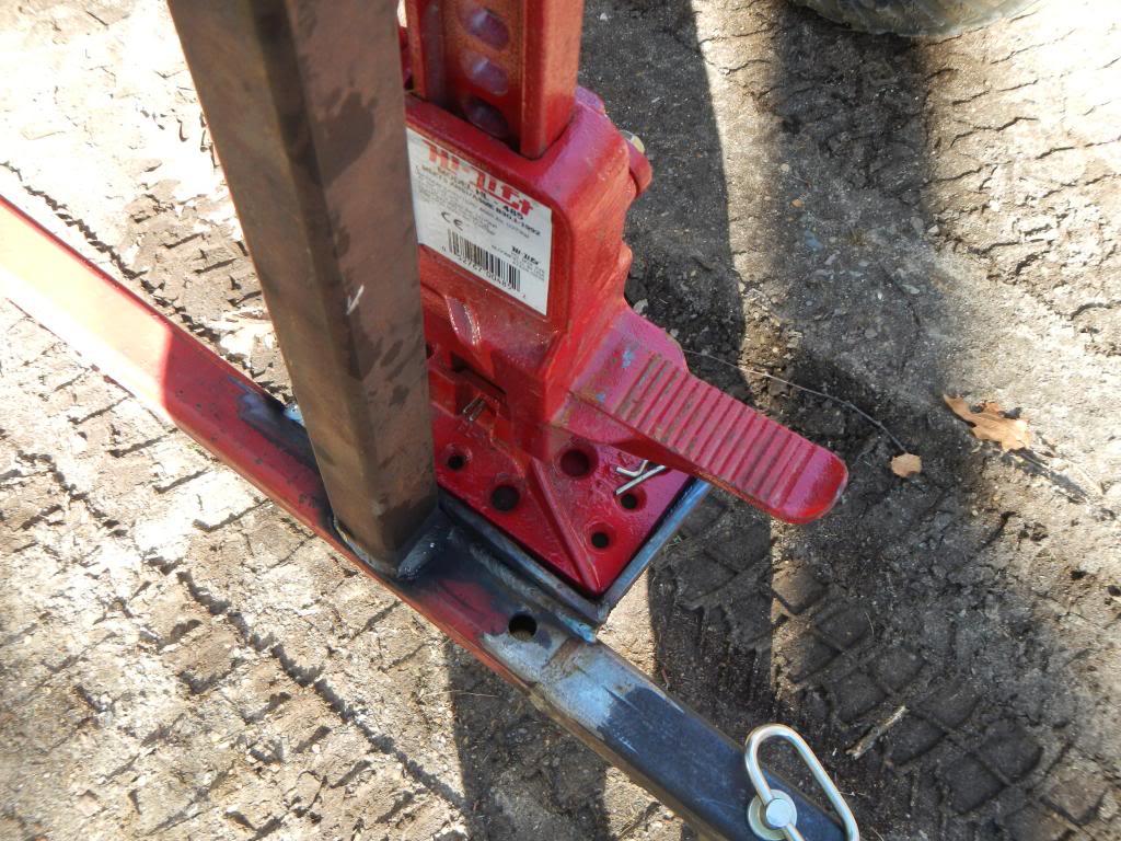

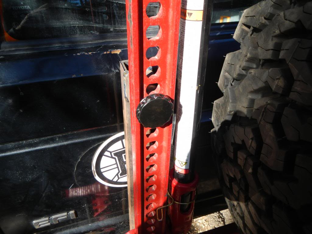

hand knobs to remove the high lift

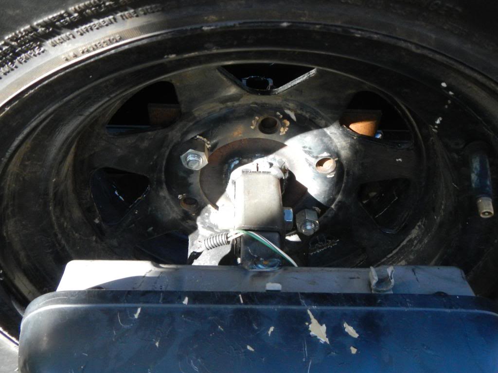

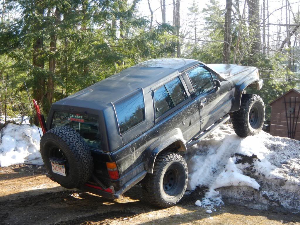

Toyota license plate holder off of a 90 4runner with a tire swing out
connected buy a 1 inch receiver
and i had to play around on what snow i had left

it has about of a 1/4 inch of play up and down that you can hear if you hit a decent size pothole i haven't yet wheeled with it but i plan on putting a small strip of rubber down on the top of the bumper and that should fix my problem
Yeah man. Nice job. Good to hear that it's pretty sturdy. Definitely gets me motivated to build one for my rig. I'm in the middle of building sliders at the moment, but hopefully soon after I'll get started.
ya it seems to be fairing pretty well i would still like to find a little bit better of a latch the best way to describe what i am looking for is i want a latch like a ski boot but i cant seam to find out that is rugged enough i like the pin but it just allows for up and down movement i wouldn't mind having both but paint is next i like to make sure every thing is good before i paint i dont like to grind new paint on to add something

I think what you are looking for in a Latch for the tire carrier is something that comes in this rear tire carrier kit. It has a red handle and works just like you described.
http://www.emsoffroad.com/store/inde...roducts_id=181
I hear you on the exhaust. When I first got my runner, the PO cut out the rust on the rear fenders so it was wide open into the cab. And it didnt help that the exhaust had a leak just about every foot. So it was like a smoke show inside of the runner until I fixed it.
I have contemplated building a roof rack also, or getting something from the U-Pull it and slapping it on the topper. Im too afraid to drill holes in the fiberglass. haha
wow that system is a good deal i wish i found that before if you build yours that kit is totally worth it thanks i was able to find that latch on amazon for 10 bucks thanks to your link
