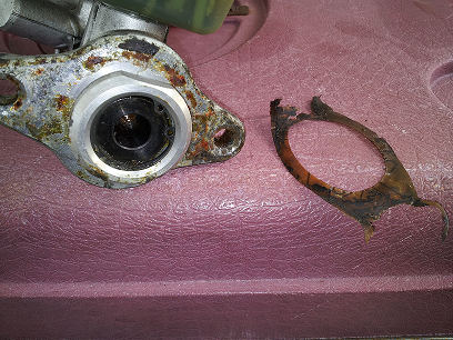

ok guys
job finished
flushed the entire brake system twice until fluid is clear in all corners (DOT3)
replaced pads and shoes (maybe half life but just in case)
replaced the MC with a new one (found a small leak in the old one)
all hoses are ok no swells,no cylinder and calipers leak
system bleeded twice while engine is off
system bleeded twice with engine running(abs was storing some bubbles)
then again with engine off and on (what a pita)
brakes tested in clear road abs working ok
brakes tested in gravel abs working ok
ebrakes working ok
did i missed something?
i think today i deserve a corona extra!!!!!!!
the old MC
job finished
ebrakes working ok
the old MC
