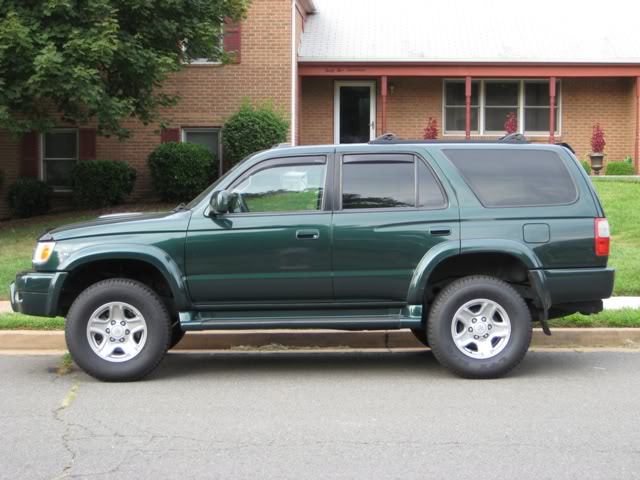

Jbud...
I'm running the following...
2000 4Runner
99 coils up front
906 coils in the rear
Bilstein HD shocks all around
265/70 tire size
I did try the 99 "tall" coils in the back and I actually wound up with a reverse rake... the 906s are perfect. The 99 coils also sagged with any load in the rear, the 906s hold up much better. There is a little bit of rake, but that's ok with me (rear is about .5 inches higher)
-batsoff

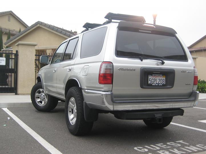

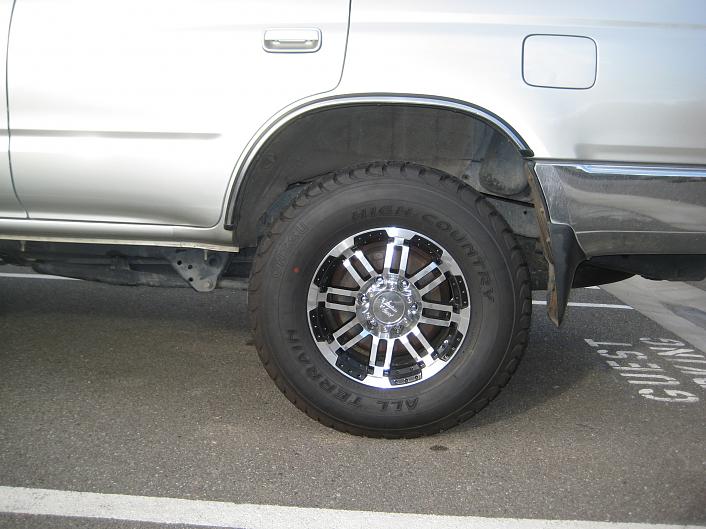

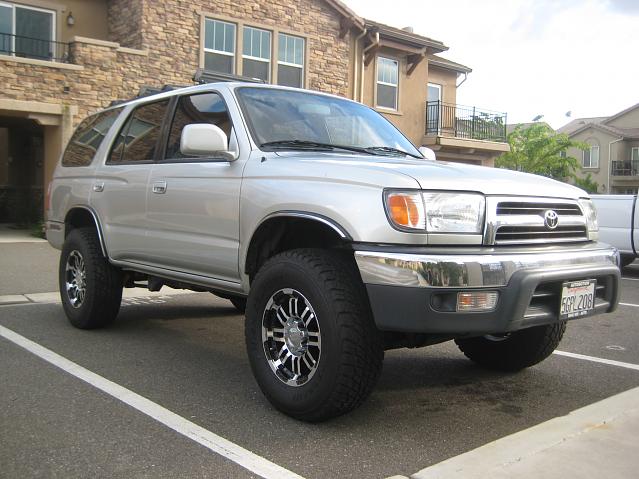

Got My Suspension Installed
I got all the parts I posted earlier installed. I put in OME Nitrochargers and OME 906's in the rear and the Bilstein 5100 ride height adjustables in the front with the stock coils. The Bilsteins are set to the middle snap ring which is the 1.25 inch lift setting.
I could not be happier with the rear set up. I was on my bump stops before and the difference is night and day, much improved feel over speed bumps etc.. The front is really disappointing........Everything I found on these shocks stated that they would be stiffer than stock and they are so freaking soft its gross. The front end bobs horribly when I hit a bump and the nose lowers and raises noticeably when I accelerate/brake. all the body roll I got rid of when I put the rear together came back and then some when the front was assembled.
The guy who assembled the struts for me said that the springs were much less compressed on the Bilsteins then they were on the stock struts. I feel like this might be where the problem is because of the loss in preload but I'm not sure. If anyone has any suggestions I'm all ears, I'm looking buying the OME 880's to stiffen up the front. I read the blurb on the SS page about the 5100's, I understand the point but I'm trying to not to throw away the 200 I just spent on shocks.
On the bright side I'm stoked with the way it looks, here are some before and afters. I got about 3 inches out of the rear which is probably becuase it was sagging and about 1.5 out of the front.
