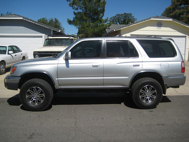

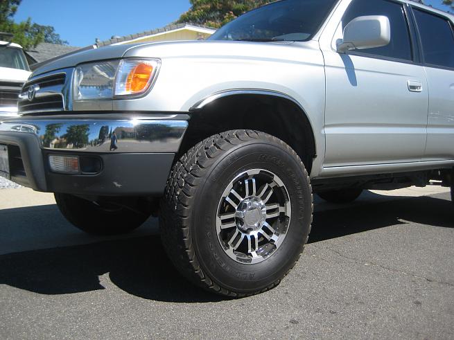

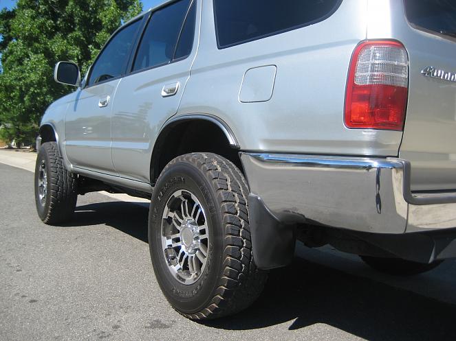

Old Jul 8, 2010 | 06:27 PM
  #44
jbudhram015's Avatar
Joined: Dec 2009
Posts: 110
From: Sacramento, CA
Pic Update
Originally Posted by Qyota
Pics?
Here's what it looks like all done, 906's rear, 881's front, OME shocks.
Attached Thumbnails 2000 Rear Coils and Shock Replacemnet-img_2758.jpg   2000 Rear Coils and Shock Replacemnet-img_2754.jpg   2000 Rear Coils and Shock Replacemnet-img_2753.jpg
gp - they technically are struts. A strut is just the term for the spring/shock absorber combination.
I disagree

Originally Posted by gpcollen1
I disagree
Yeah, gpcollen is right on this one. Here's the correct terminology:
Strut - a shock with a spring perch (no spring, no top hat)
Shock - a shock with no spring perch (what goes in the rear of most solid axle rigs)
Coilover - a Strut/Coil Spring combination that is self-contained. Usually height adjustable.
jbudhram: thanks for the info on the OME equipment and the pictures, good stuff!
To me, it does look like there is a bit of reverse rake....but that's because even if the wheel gaps are equal on 4Runners front and rear...the rear still looks lower. The rear wheel gap has to be greater than the front for the whole rig to look level...if you're looking at the roofline and body lines.
It isn't much, but it looks like a slight reverse rake to my eyes (especially in the profile shot). Pretty darn close to level, actually. Thanks for posting the pics!

The rake is slight and sometimes it looks bad and sometimes it doesnt. I think I might put the Daystar spacers on the rear to get another 1.5in out of the rear and eliminate the rake all together. The 890s are rated at 2.5in and the 906s are 2.0in so I think it would be a waste to spend the $175 on new coils that are going to settle again. I'll put up some pics if I get them.
