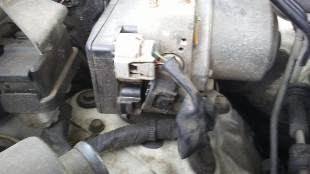

Can you post a picture of the plug you disconnected?

It is dark outside now so I'll get a photo tomorrow. The connector I pulled was the lower of the two. It is black and the top one is white.

Here is a photo of the two connectors with the black (lower) one disconnected.

From your picture I disconnected the top connector 4 years ago after the first icy day with the truck.
My ABS light has been on since. I just put a piece of tape over it.
