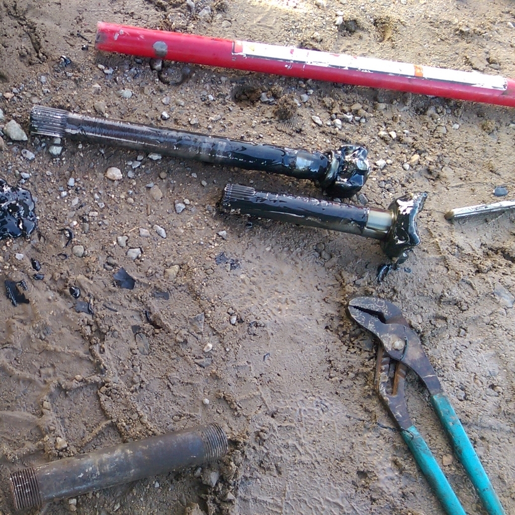

This is we can't have nice things.

^ what happened?
Old Apr 28, 2015 | 06:19 AM
  #1346
Z's Confederate Toy's Avatar
Joined: Nov 2009
Posts: 1,965
From: Bailey, Colorado
Originally Posted by liveoffroad
^ what happened?
Carnage + snow + showing off = stock birf explosion. It also snapped two bolts on the steering box. And we didn't even make it over the gate keeper
WOW! I've never broke one, i'm pretty light footed though
I was being pretty light footed. But I think it was weak already from our prior trip. So it didn't take much for it to come undone.

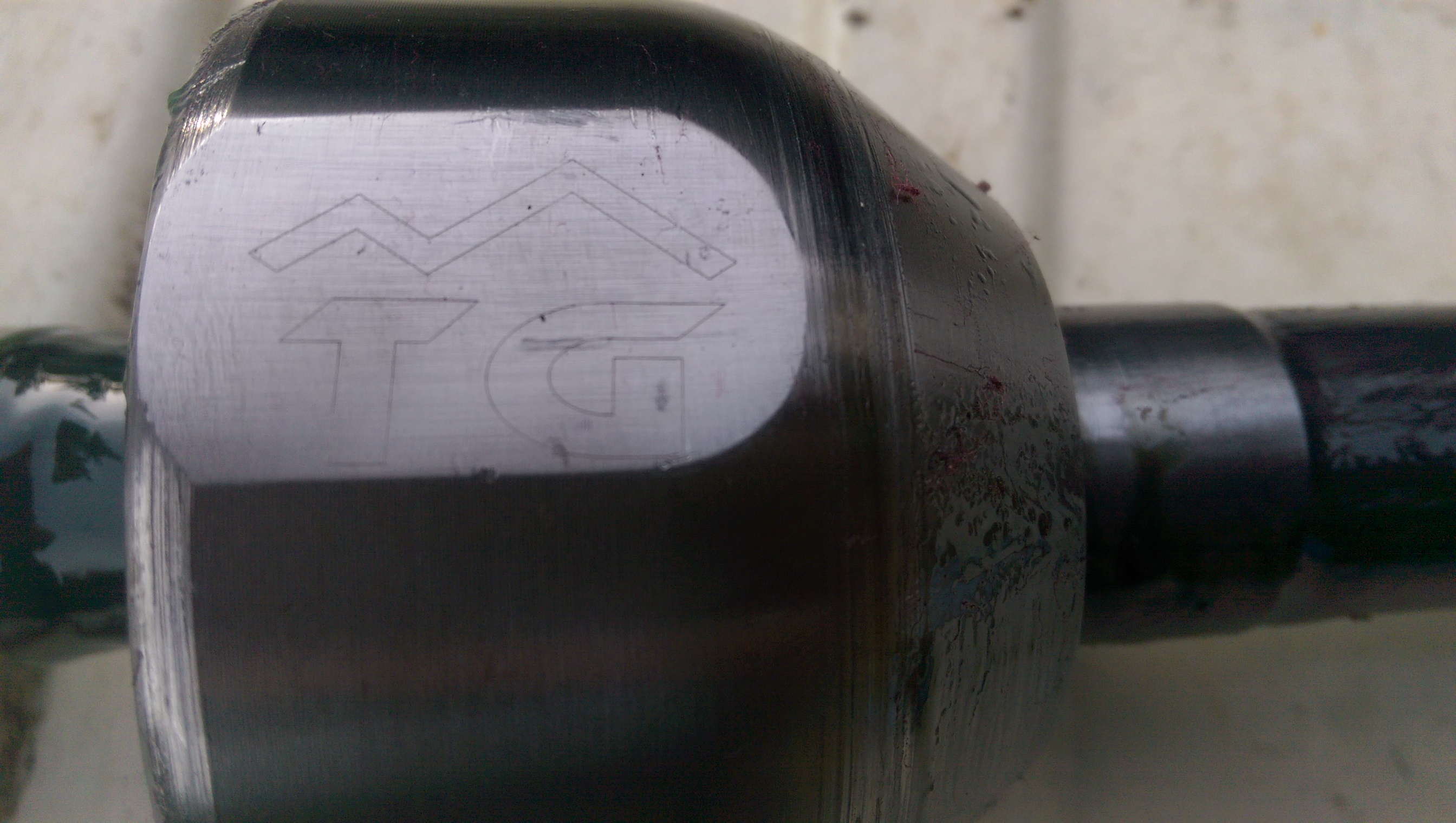

My hopes came true. The 80 had TG 27 spline chromo birfs. They'll get me by until I can buy 30 spline RCVs.

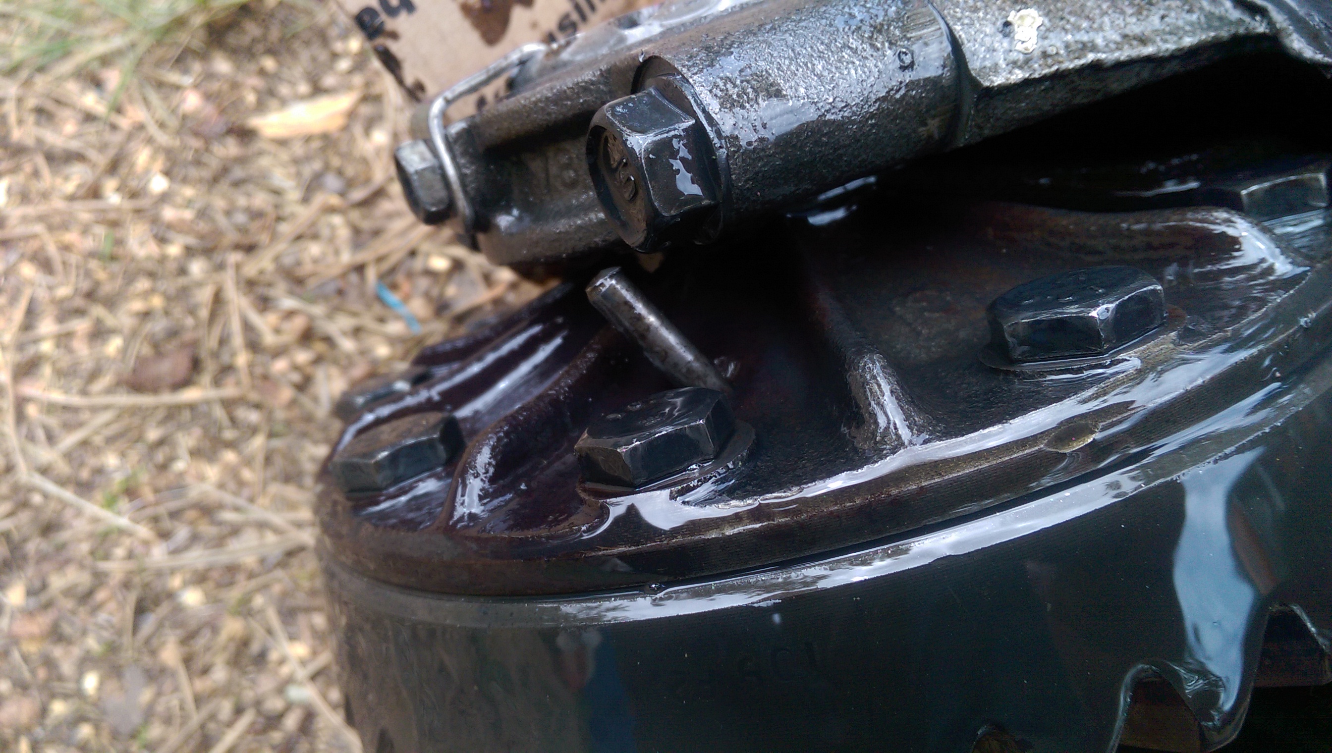

Had my front axle apart this weekend for rebuild. After the last three blown birfields, I had some good maintenance to do. Trunions were held together with broken dreams, the inner seals wiped out, wiper steals leading like a sieve, and needless to say I needed to drop in the new birfs.

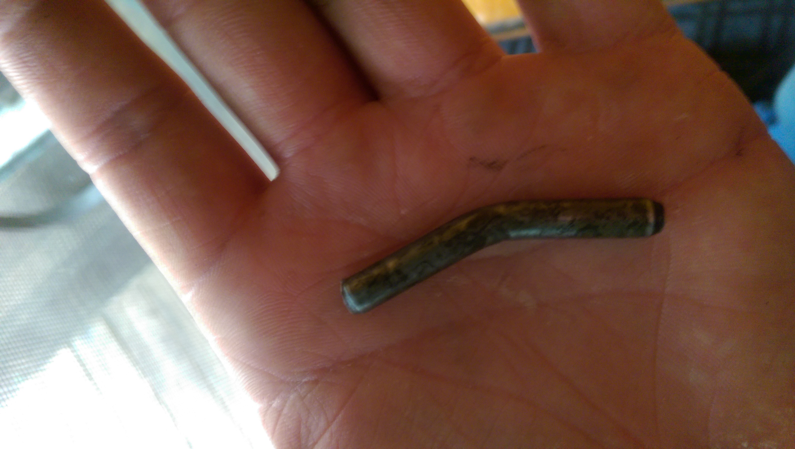

I ended up getting just the driver side done yesterday because I ran into a slight problem. When I broke my left side down I noticed some large debris on the inside of the long tube. I ended up having to pull the 3rd to clear out. So while the third was out I did a visual inspection of it to make sure everything was good. Which in fact it was not... The Aussie center pin keeper had backed out, collided with the bearing cap and was bent at a 45* angle.

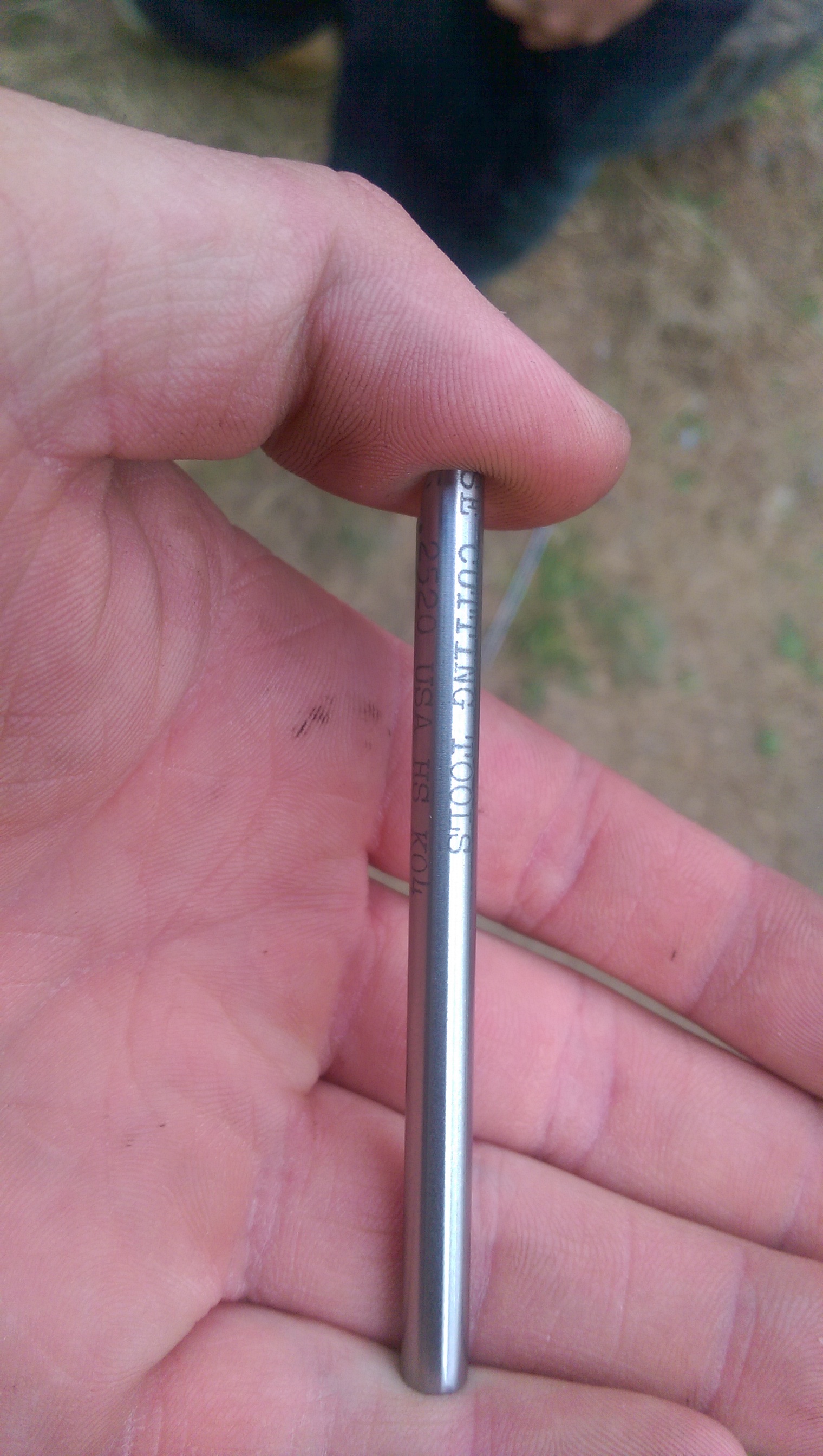

So after 3 hardware stores, 1 parts house, and a trip to work I found something that would work. My buddy found the shank end of a broken reamer in his tool box at the CNC shop we work at. It was slightly bigger than the original but that war what I wanted because I didn't want this problem again. So we pounded it in and staked it so that there was no chance of another back out.

nice work, i love the cheap fix!
