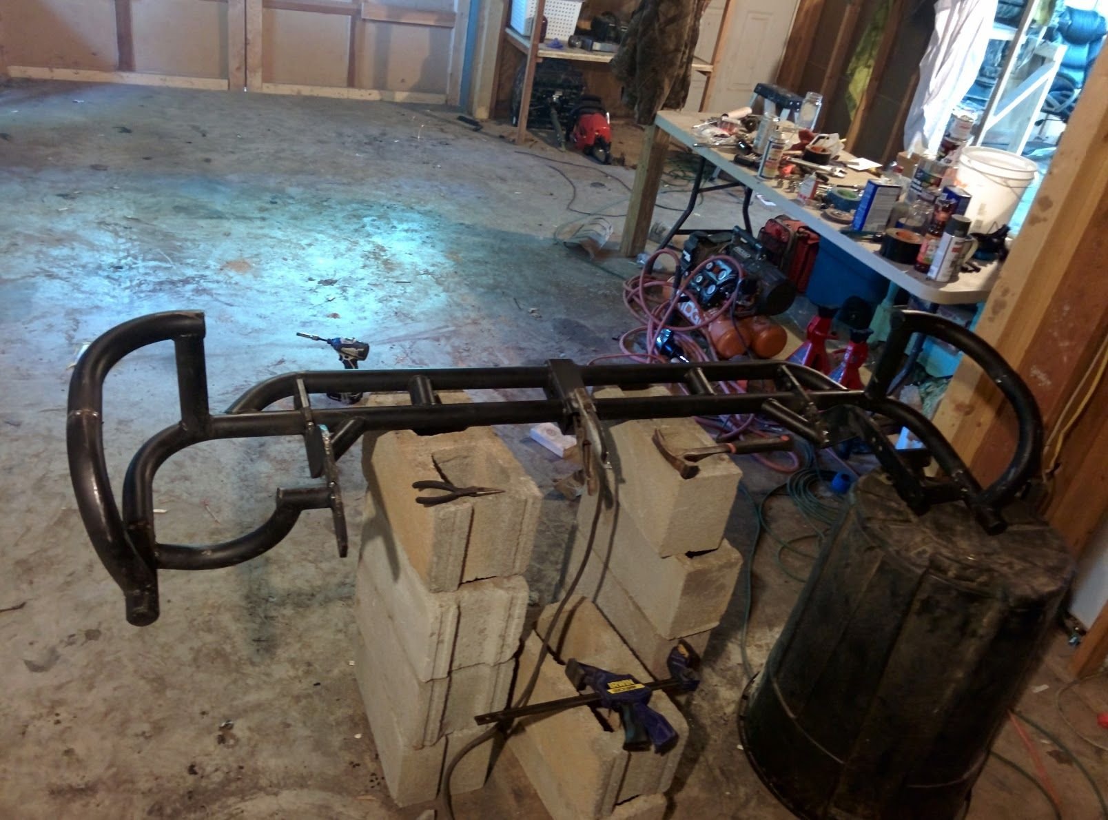

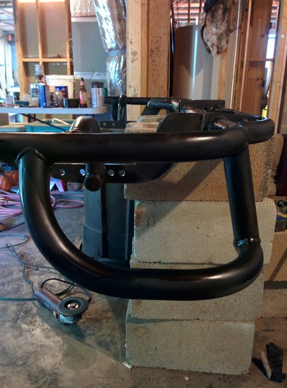

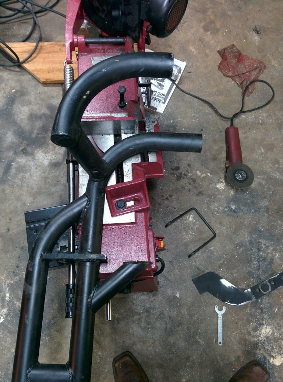

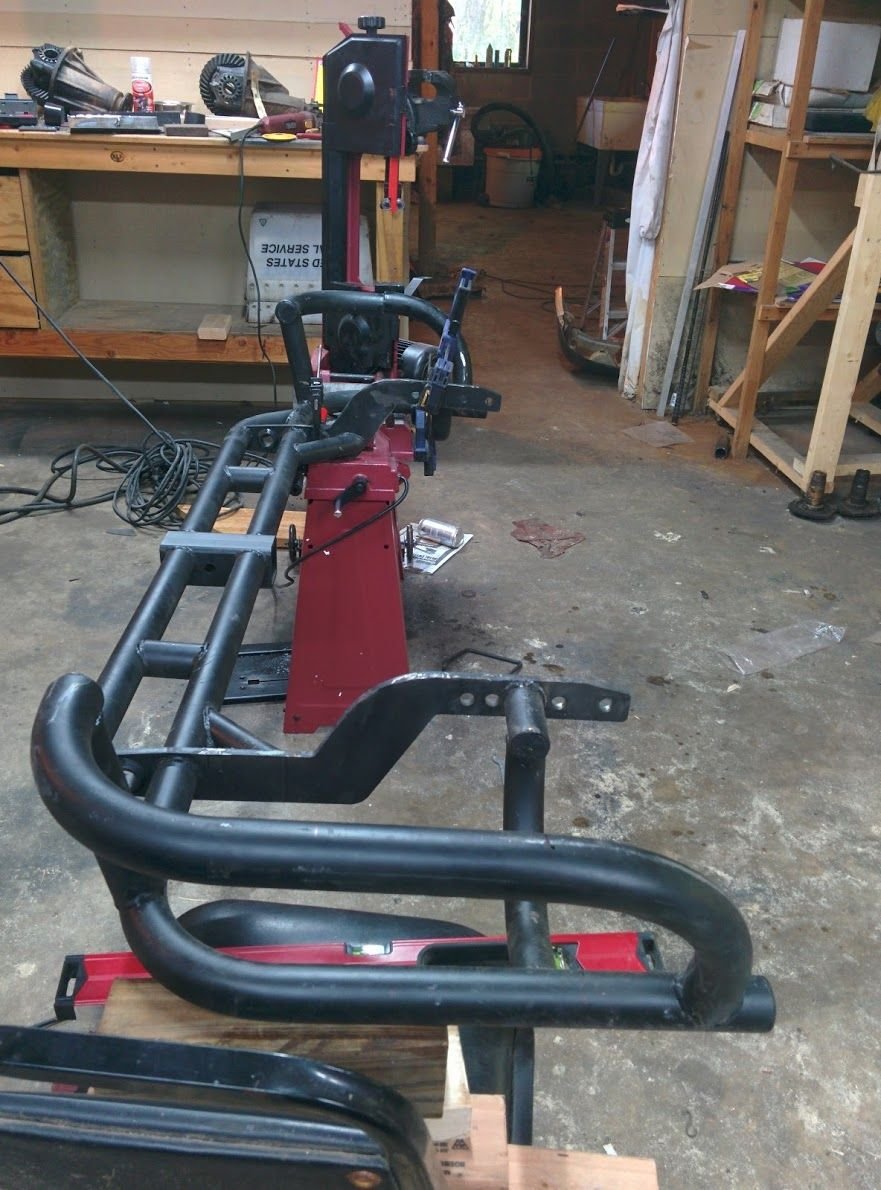

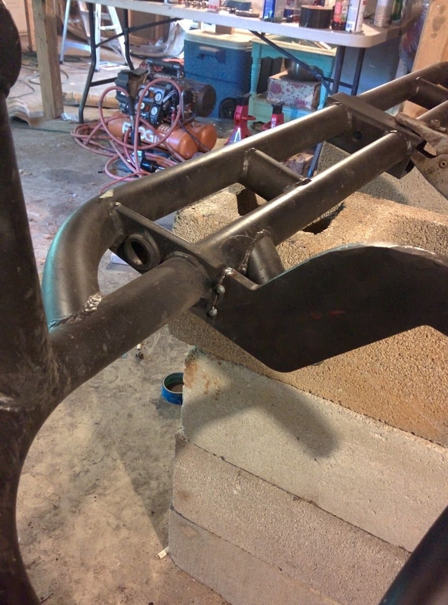

Next step is modifying the trail gear bumper to fit with my bed bob. A quick test fit even with drilling new holes in the frame shows the bumper will stick out about 5" too far. So time to cut!
I had to cut 3" out of the mounting plates to bring the whole bumper closer to the truck. This will reduce the gap between the tail gate and the bumper by 3" and leave a 2" gap (the same as the gap on the sides where it wraps around the bed). I hated to have to cut this plate as it creates a possible weak point in the steel but the bumper just stuck out way too far from the bed.
I also had to take 6" out of the side guards so they would not protrude into my wheel wells. A lot of cutting points but it all went back together nicely. I took as many pics as I could for yall as I am the first one to attempt this as far as I know. I really like the TG bumper and it was useless after the bed bob so I had nothing to lose here by hacking it all up. Its just tacked up right now for a test fit.

Are you going to plate the weld area or add any bracing?
On the frame you mean? I'm going to use bolts to attach it. No plans for plating yet. I would like to but the bumper fits very tightly on the outside of the frame rails and its going to be a real bitch if I have to fit another 1/4" of steel between the two mounting plates (might have changed since i cut it up). I thought about at least welding in some bolt sleeves through the frame where the bumper attaches.
I have thought about a stronger crossmember on the end of the frame rails where I cut them off but Im not sure if that will do nything for the bumper.

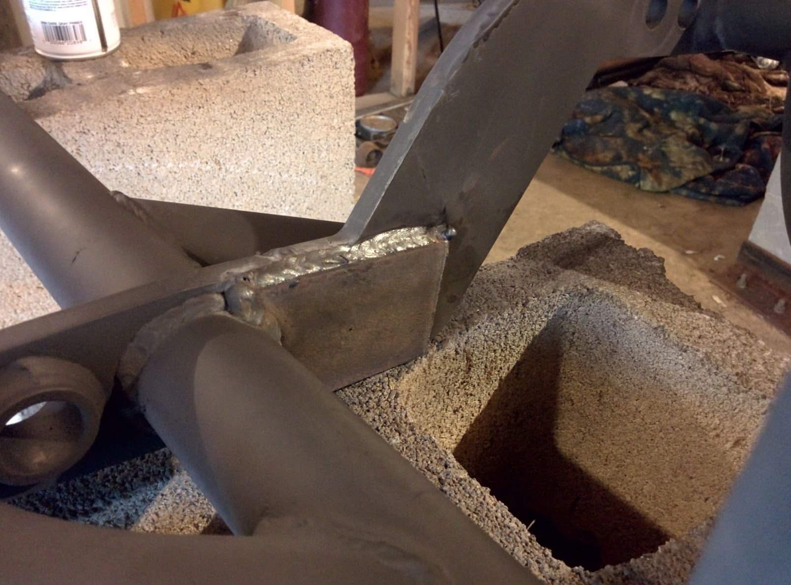

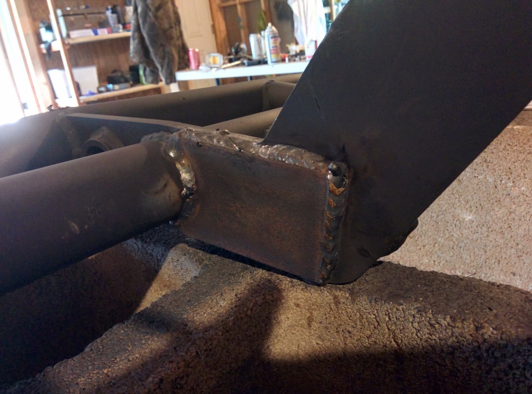

No I mean where you cut the bumper mounts and shortened them up.
Old Sep 15, 2015 | 12:15 PM
  #108
wberry85's Avatar
Joined: Jun 2014
Posts: 229
It fits!
Cant even tell it was cut. The wonders of a sanding disc...
Bump I made a plate for the mounting bracket out of some 1/4" plate. Post pics in a sec. Good call!
Old Sep 15, 2015 | 12:56 PM
  #109
wberry85's Avatar
Joined: Jun 2014
Posts: 229

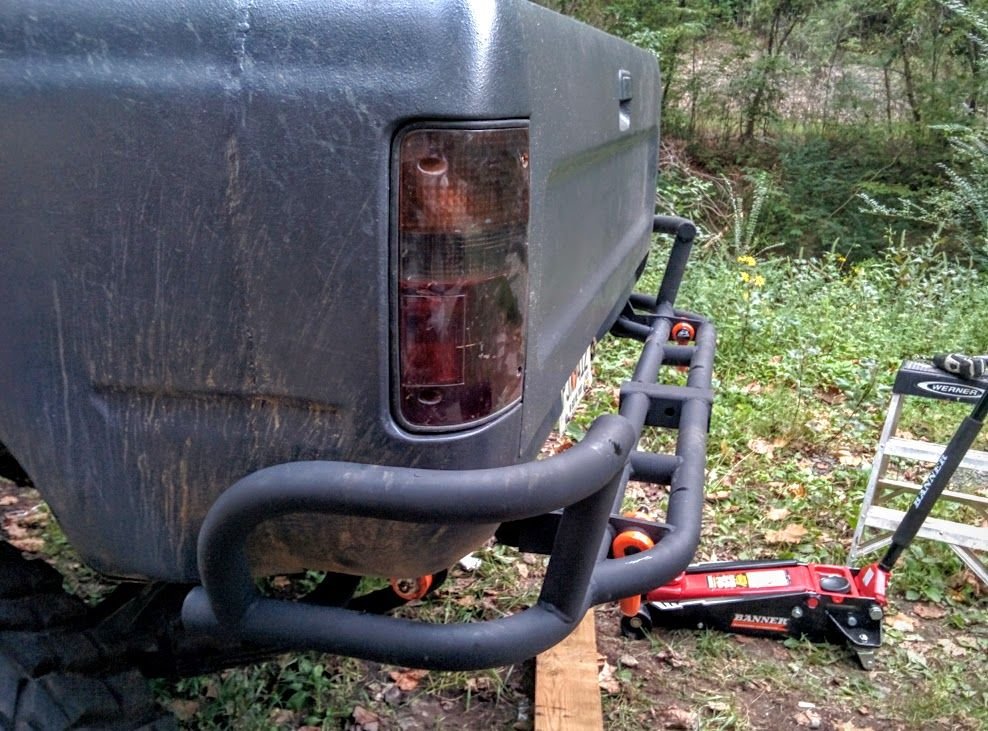

Here are some pics of the plate I used to beef up the mounts. Burned it in on the highest setting so hopefully the penetration is good and everything is sturdy. The welds laid flat so I think its pretty good. Ill yank on it a couple times and test.

Looks good. I'm ready to get to the bumper building phase of my ride.

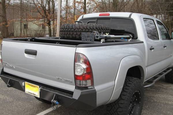

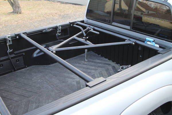

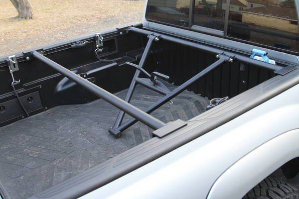

Flat tires scare me. I dont carry one on any of my trucks and I need to. But how to carry it?

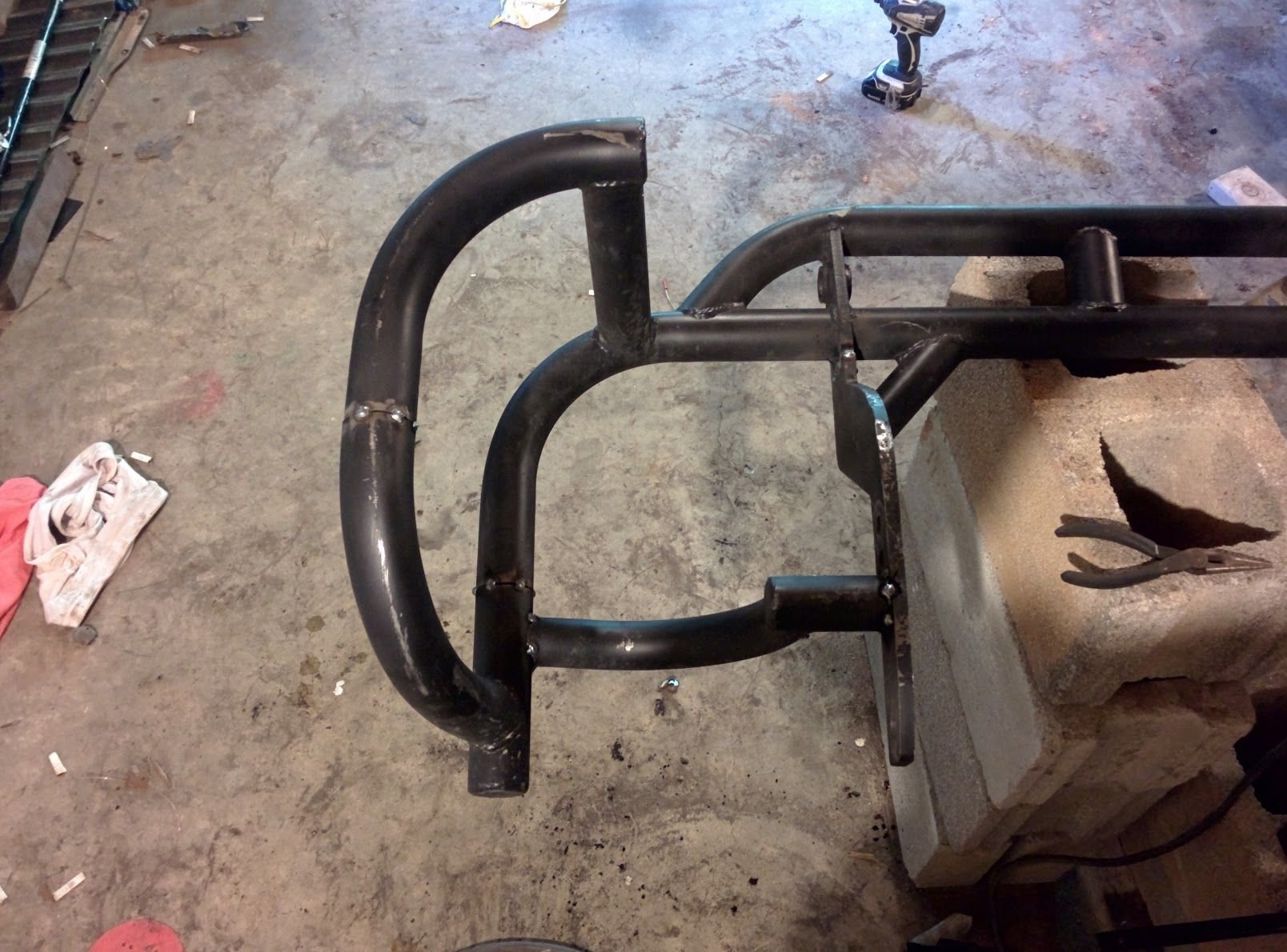

Found this awesome design on another forum. I plan on making it this weekend. I love the angled design and the fact that you can flip it up and have the tire lay flat if needed so you can fit stuff underneath it for camping etc.
I have some 1.5" tube laying around I can use. Its only .065 wall so I hope its sturdy enough but we will see.

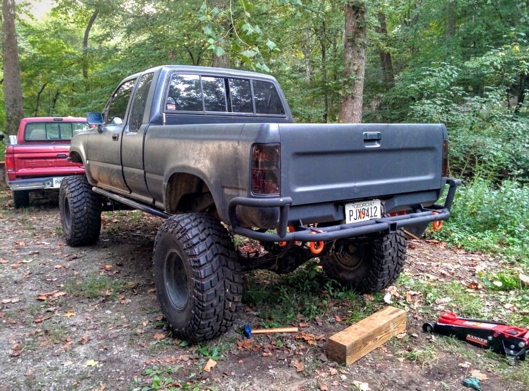

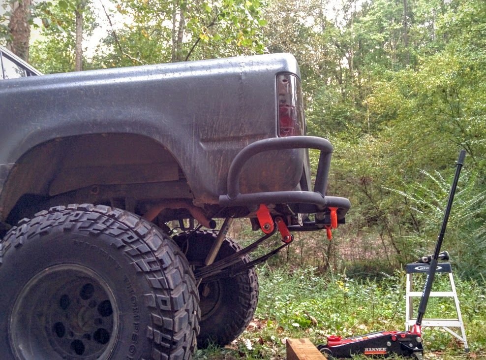

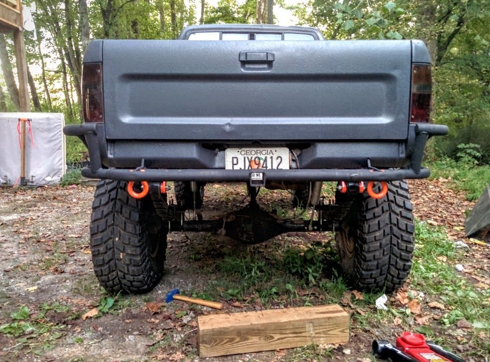

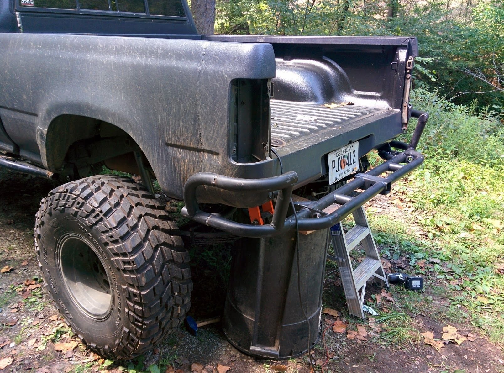

Wow lots of stuff to update.
New gas tank installed...check!
Spring hangers moved and shackle angle fixed...check!
Bumper shortened and reattached...check!
Finally back on the road.
And the pics of course.

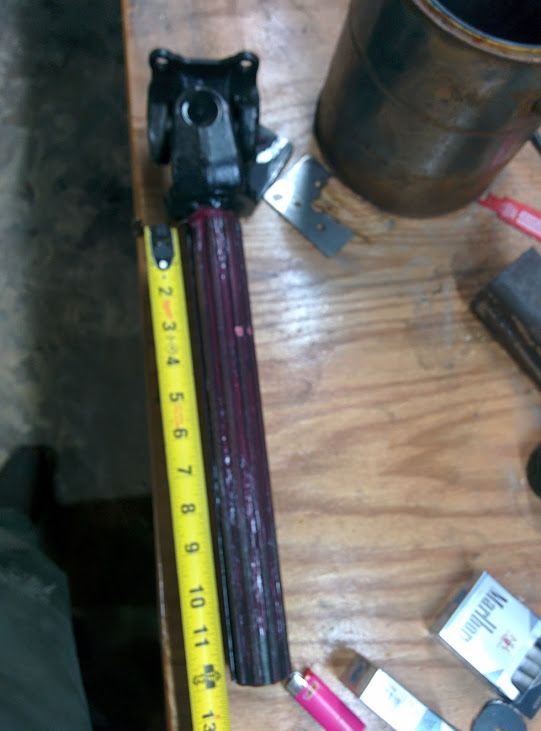

Oh yeah...driveshaft finally came in from Davez. A full foot of travel and very heavy duty. I'll be be attempting to redrill my flange and install it tomorrow.

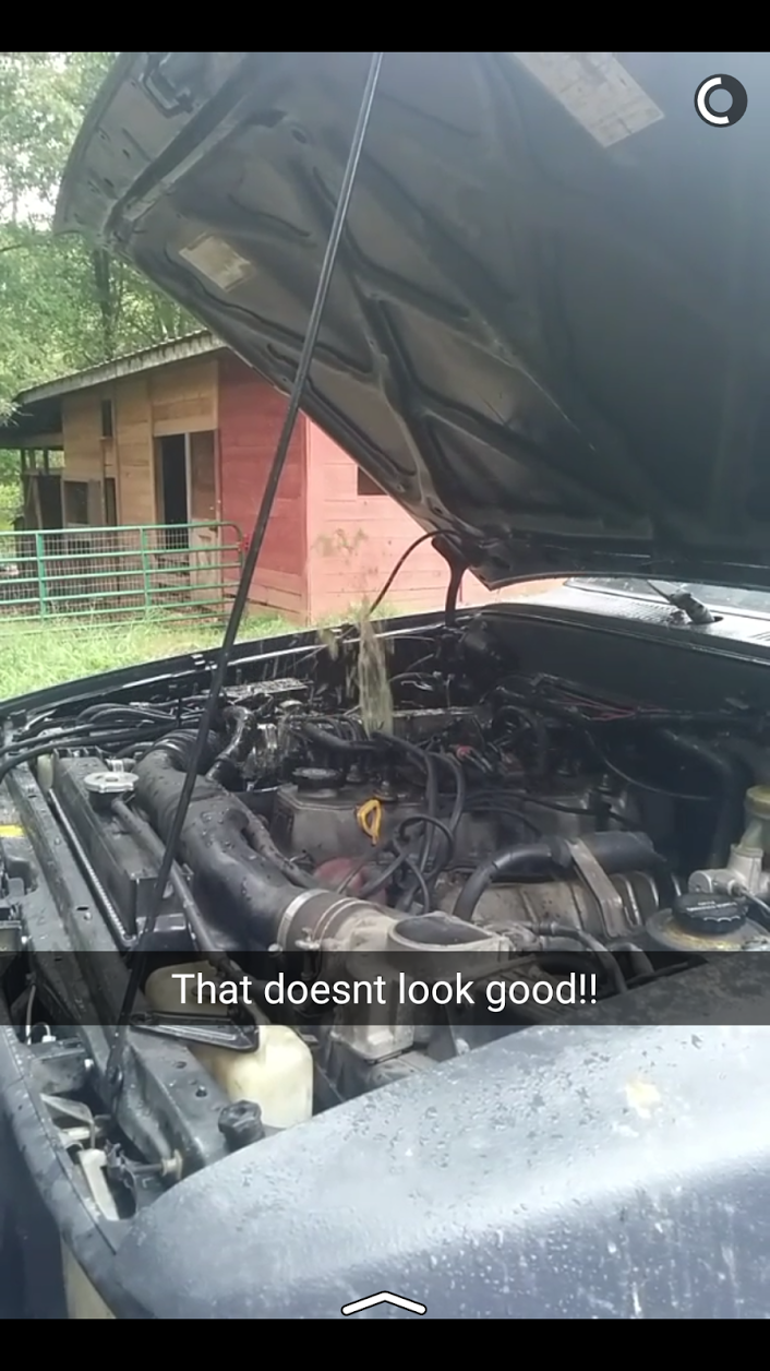

Sooo this happened today!
seems like a good reason to put a 4.3 in it lol
Old Sep 29, 2015 | 03:45 AM
  #119
wberry85's Avatar
Joined: Jun 2014
Posts: 229
It got pretty hot til I could pull over and all I was thinking was man if I blew the head gasket it will be a great excuse to do a motor swap!
