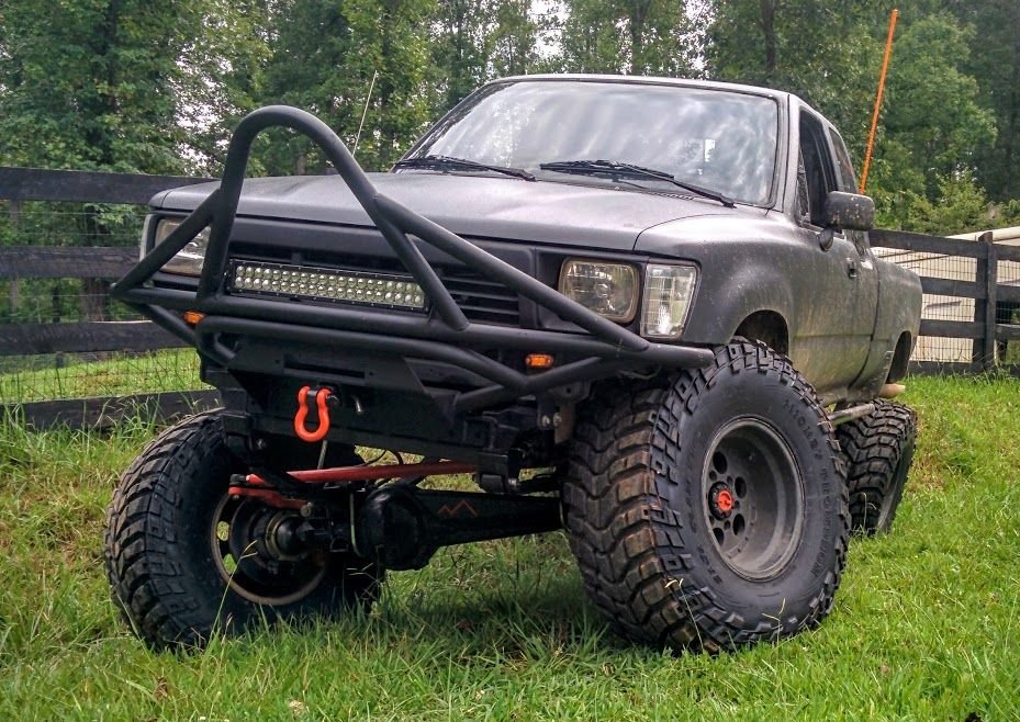

New light bar for $35 on amazon. Works awesome and very bright. Sure beats $250 like some people are asking. Sturdy aluminum housing and good hardware. Seems like a winner. We will see if it affects cooling...
35's get here Monday.

Thats more like it! Probably gonna suck til I get 5.29's though lol

You have been mighty busy my friend. Your truck has taken on a whole new life. Looks like a sick crawler. Mad props to you. Truck envy for sure.

Well since Davez is taking over a month to build me a front driveshaft , and 2wd wheeling isnt very productive, I have been working on fine tuning these leafs. Took some poser shots in the yard to make sure the 35's arent rubbing and I was pretty unhappy with the amount of rear flex I have.
I am pretty happy with the front flex, since it is flexing the full length of shock travel that I have, but the rear flex isnt so great. I am nowhere close to the bumpstops at full stuff. Its drooping ok but the spring seem too stiff for enough uptravel, maybe bc there is so little weight in the back end. Could be bc my shackle angle is almost vertical in the back? So I can start by moving my front spring perch back a little to get closer to 45* shackle angle in the rear, or take some leafs out, or both. What do the experts have to say?
