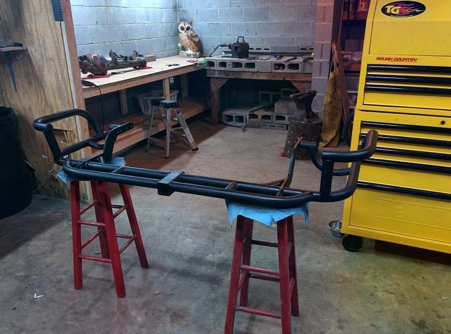

Rear bumper came in...i hate waiting for paint to dry
I think they sort of put the shackle mounts in a dumb location. If you tie anything to them they will contact the outer tube if you pull on them. I might weld on some of my own.

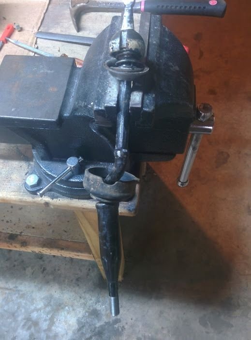

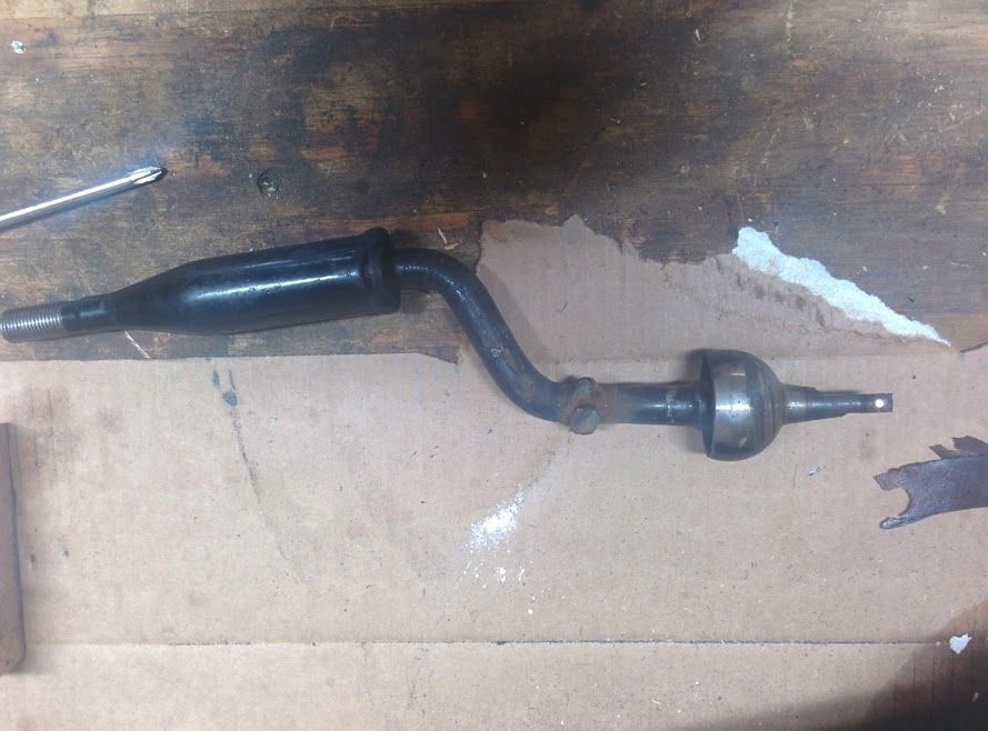

Still dealing with this stupid body lift...when I lowered the truck back down i found they had installed transfer case shifter extensions. They basically welded 3" of round stock onto the shifter so I got to cut that back in half and return it to stock length tonight. I would have been fine leaving it 3" higher but they extended it so that the bend in the shifter would contact the transmission shifter and I couldnt put it in 4L. Wonderful.
This was the shifter with extension
Cut down the shifter to remove excess length
Me being an idiot and welding it back together forgetting to reinstall the dust seals, spring, and boot
I had to cut it off again and reweld it after putting it back together correctly. Sort of glad I had to do it over bc I turned the heat up and got way better penetration on the weld this time. Not that its going to see stress but it makes me happier. Saved me $120 on a new shifter.

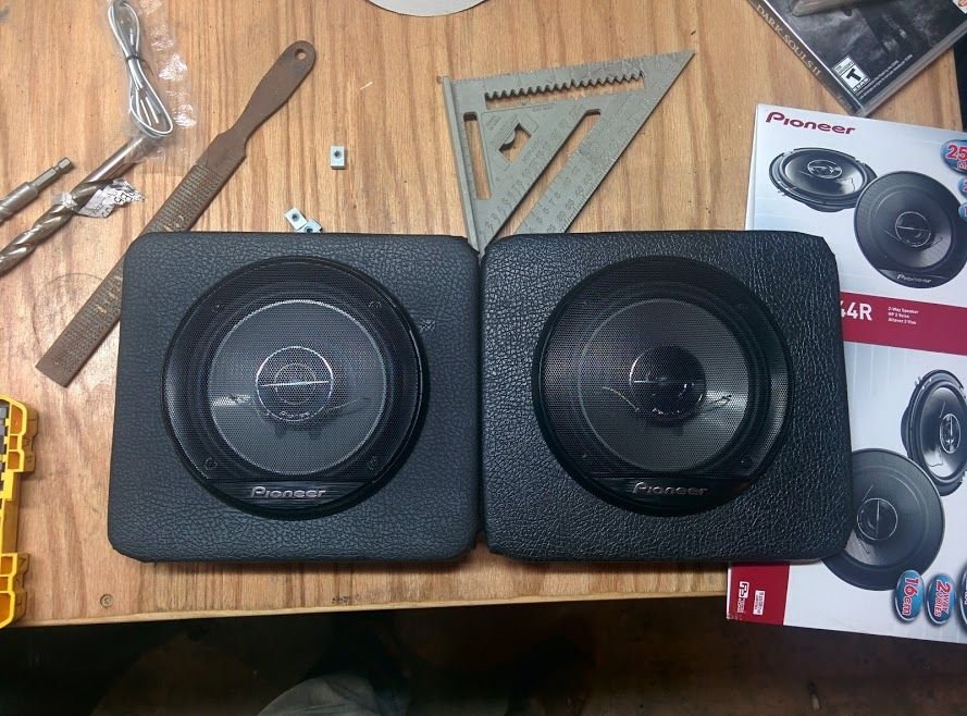

Tube doors really suck with no music. Being that my truck is an extended cab I have those little cubby holes in the back. I decided they were a good place to put in some speakers.
Mounted them in 1/2" ply and covered them with some vinyl from an old bench press pad. I'll wait to install them when my CB comes in so I dont have to take my dash apart twice...

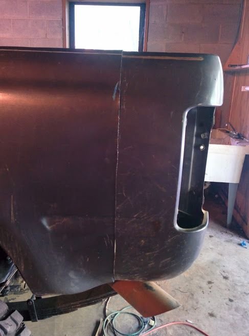

So I was walking around in my shop and all of a sudden I tripped over my sawzall and then this happened...
Right after I just got my shiny new bumper too! Bummer.

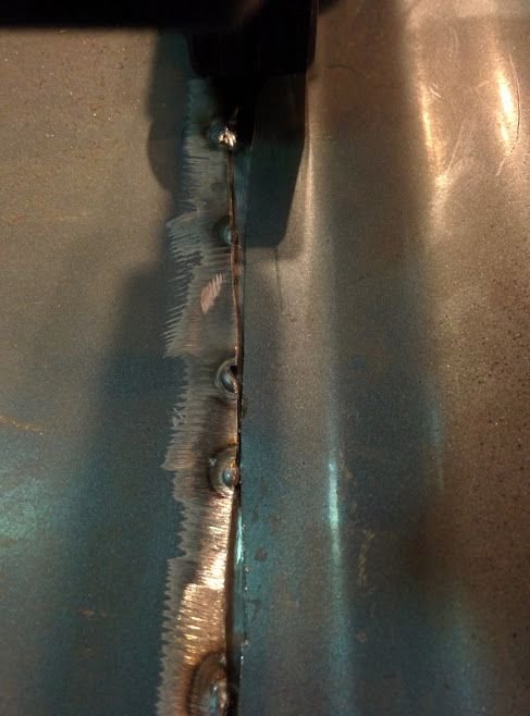

Got everything back together. It was a fun mod and free. I never done any body panel welding before. If you are planning on bobbing your bed, I can't stress enough how important straight cuts are. They make the job much easier. I started using a sawzall, but after I jacked up one side of my bed, I switched to the angle grinder.

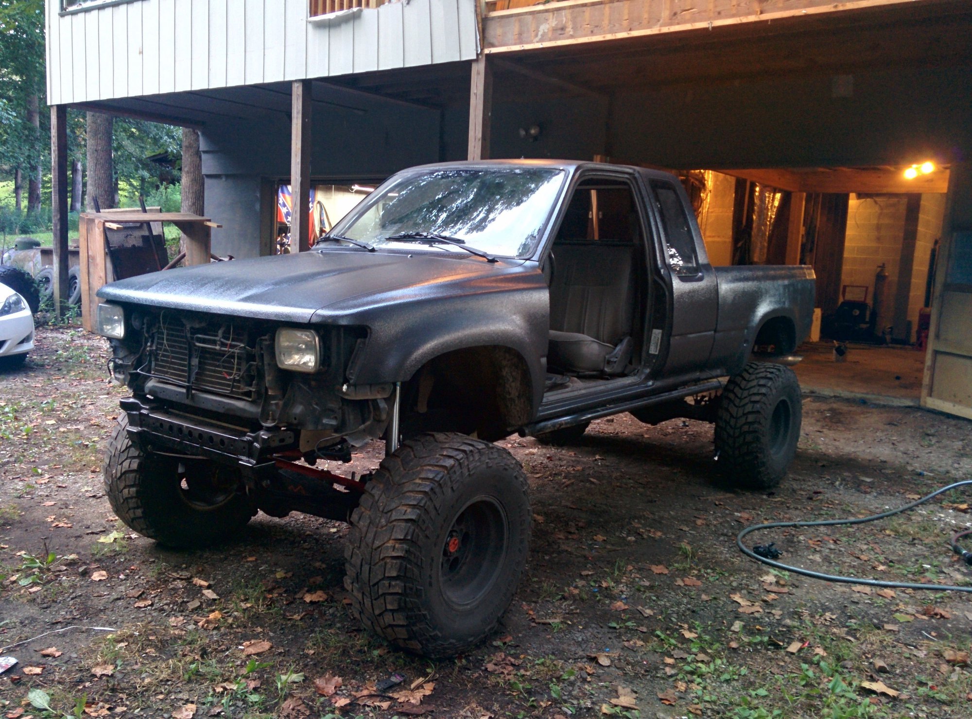

Well the paint on the truck is a little rough. The roof has zero clear coat left and the hood is next to go. It also had a drop in bedliner that rubbed in several spots and rubbed through the paint causing surface rust. I need a durable solution. I dont want to go with a Maaco job and I dont want to rattle can. I am just too hard on the truck for any of that to last. And so I have decided on Monstaliner for the entire exterior. I will be using the Pyroclasic color since my truck is already gray and this will help the engine bay match.
It will end up something like this:
I know a lot of people are against the bedliner exteriors but for what I need I think it fits the bill quite well. This truck will never end up on a show room floor and I plan on keeping it forever so it seems logical and the most durable solution. Also looking forward to getting rid of all that chrome!

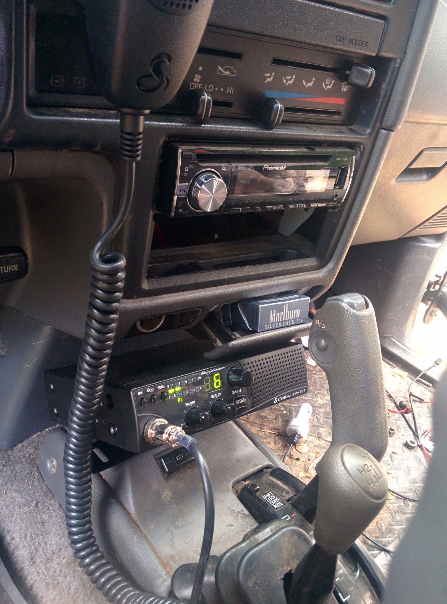

Forgot to mention this little addition. Got a cb for the truck. Never used a cb before but it's pretty cool so far. Made an antenna mount for it.

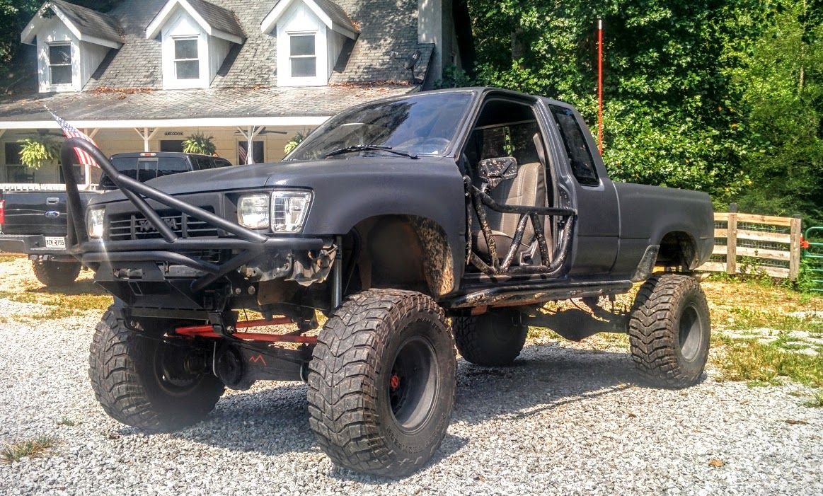

Monstaliner is on!!
Prep was a real pain but it went on good and feels rock solid. Matches my stock paint pretty good too. I am definitely happy with it.
