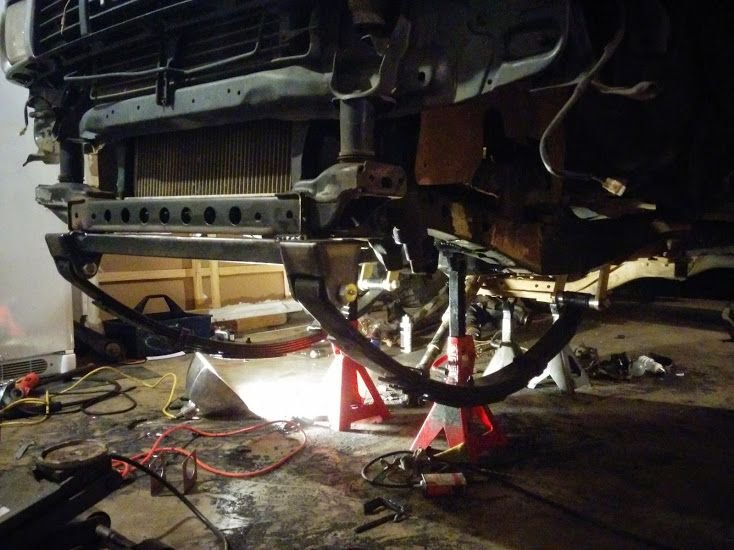

Progress is slow...I feel like I have been grinding for an eternity. I finally got the frame clean though. Used a hole saw on the outside of the frame but there was no room for the drill on the inside so we had to torch it out. Of course I ran out of gas again. Tried using a die grinder to make the holes a little bigger bc I was conservative with the torch when making the inside frame tube holes, but it is taking too long. I stopped wasting my time and went back to grinding the IFS brackets. The hole saw worked great on the outside. I used a 1 3/4 Lenox bimetal hole saw and it cut right through it. Plenty of cutting fluid kept it buzzing right through. The gussets were a pain but not that bad with a torch.
IFS = gone!
Going to get more gas in the morning. Then I will finish sizing up the holes and at that point the frame tubes should be burned in and we can get around to hanging this darn axle!

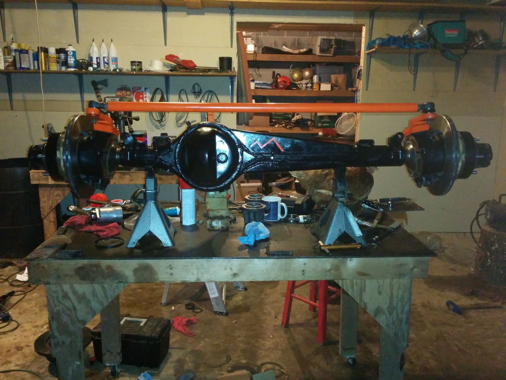

Diff installed...
And Marlin ecoseals installed.
And now I just stare out the front window for my axle shafts to get here... UPS normally shows up around 2 PM so hopefully it is soon!
Old May 26, 2015 | 08:07 PM
  #28
wberry85's Avatar
Joined: Jun 2014
Posts: 229

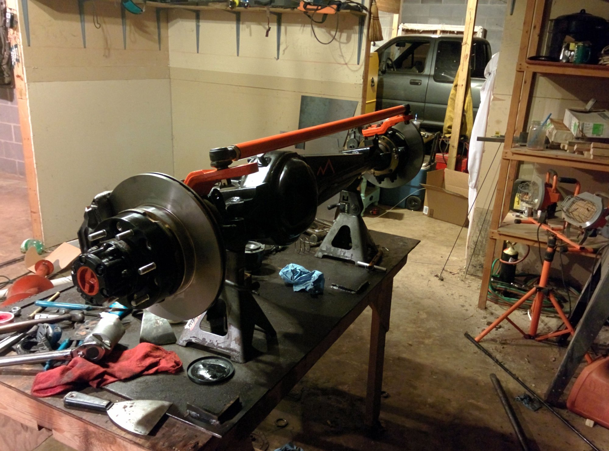

Longfields came in and installed! I didnt have to clearance my axle housing at all. No rubbing on rotation. Not as much progress as I wanted bc I had to knock out some honey do items but I got the axle seals installed, longfields installed, chromoly hub gears installed and hubs rebuilt (PITA!), and knuckles/steering arms on. Preload tested at ~13 lbs with stock shims. Found a busted knuckle stud so I will to replace/repair that and also have to replace some cross threaded lug studs. Thats tomorrow.
Pics:
Had some help from a friend lol
Old May 27, 2015 | 05:51 PM
  #29
wberry85's Avatar
Joined: Jun 2014
Posts: 229
Axle is BUILT!!
I did have one issue with wheel bearing preload. The hub didn't spin until about 20 lbs of pressure was on it. I think FSM says 13. Even with the spindle nut all the way loose I couldn't get it that low so I guess the seals and grease needs to break in a little bit? I just torqued to spec and moved on. I don't know if my preload has ever been perfect though so I'll just ride on it and see. The Chinese bearings in the TG kit probably wouldn't have lasted long anyways lol.
Hope you guys are enjoying the build. I know I am. Tomorrow hopefully we can get the axle under there and test it out. Then measure for a new front drive shaft and start on the rear lift.

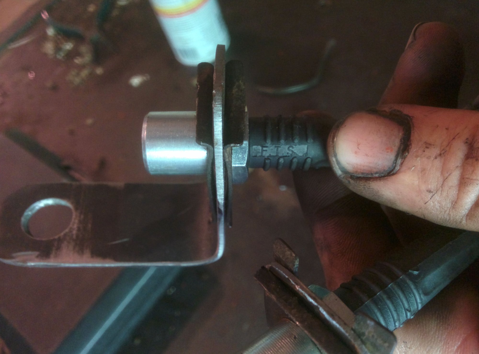

Today I worked on getting brakes hooked up on the front and starting on the rear. I really think TG should do something to include a brake solution for connecting the IFS calipers. They just send you extended lines with no way to connect them to the calipers. So I made my own brackets for the hard line...
I'll probably do something similar for the upper hard line attachment.

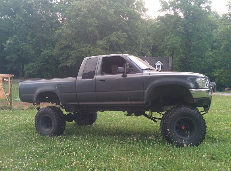

Alright guys...this thing is done! Mostly...
The day started by putting some work in on the rear. Everything had to be painted, welded, etc. I already had the shackles on and the axle was out and painted. Diff was swapped.
Tacked the front hangers and got the leafs in first off.
Then, I needed to place the axle under the truck, lower the truck on the axle, and determine pinion angle. Then weld em up. I think my welding has improved!
Finished burning everything in, bled brakes, and torqued everything down and she was ready to roll out of the garage for the first time!!!
Pics:

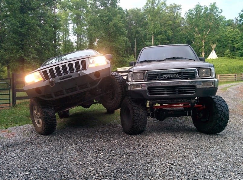

My buddies WJ:
All in all it was a fun project and no hiccups thank goodness. This thing is TALL!! I plan on removing the 3" BL so that should shrink it down a little.
