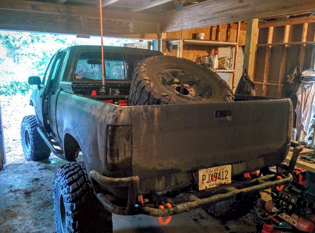

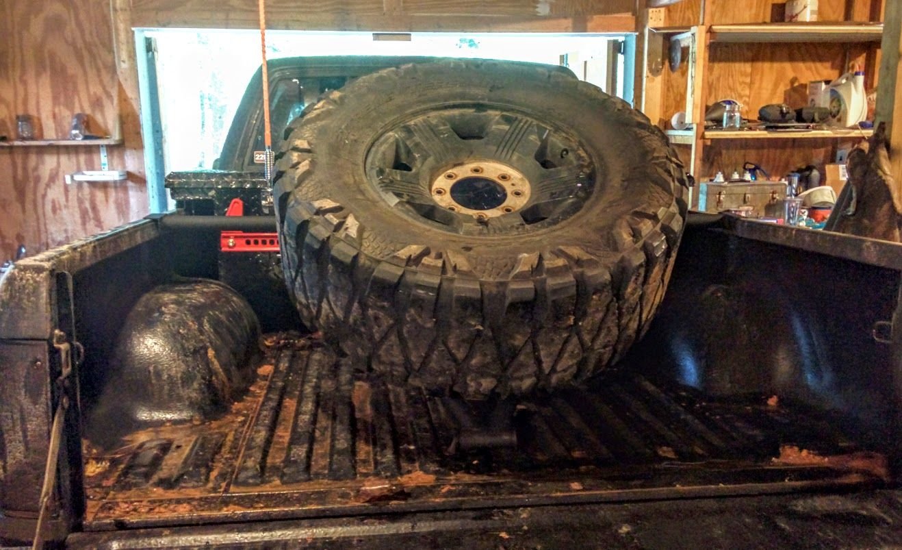

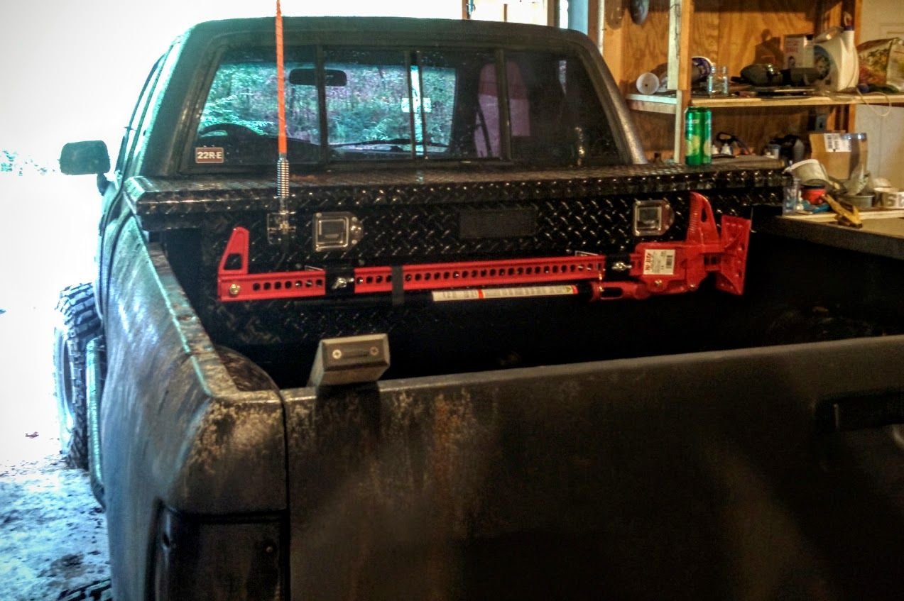

Now that I have a toolbox I have a way to mount my hi lift and my cb antenna.
Also just about finished with the spare tire carrier. I just have a test tire in there now until I see if its going to be strong enough to support the weight and I figure out how to secure it.

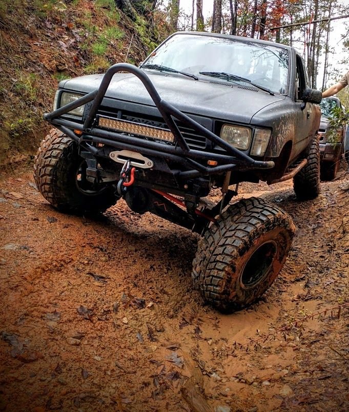

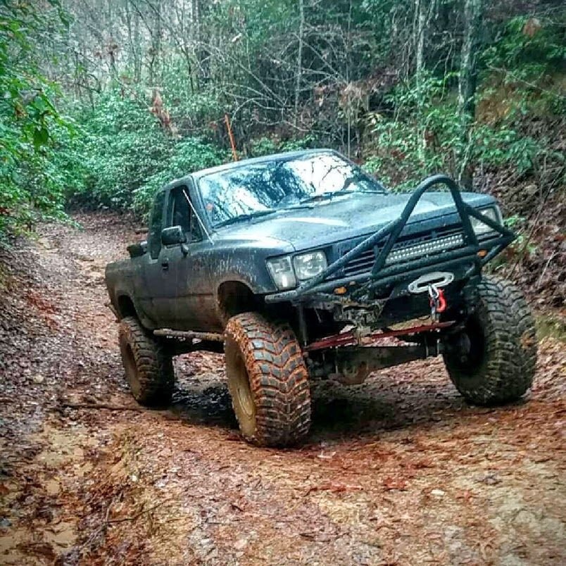

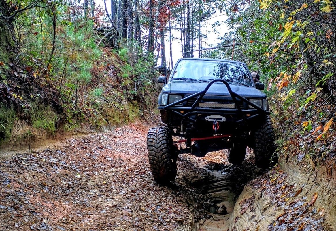

FINALLY got to wheel this thing today. I have played in the woods but today I was able to actually test the truck. She did great. No damage and everything worked like a champ.
