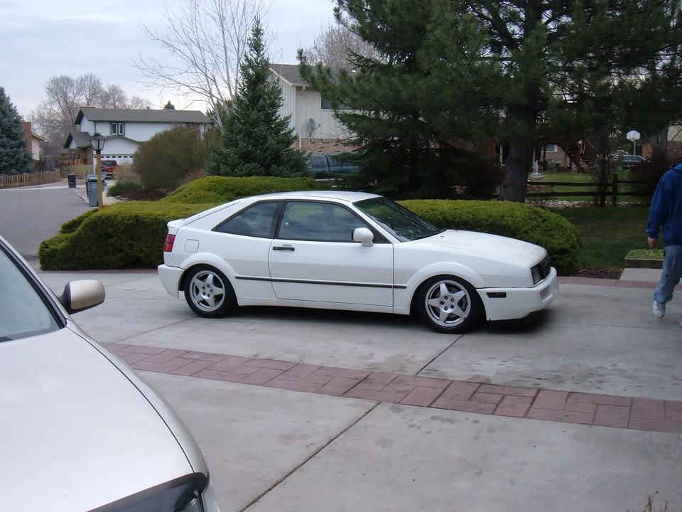

Humbleslc "Any pics of the corrado in the background of the pictures, does it have schmits on it"
The car has schmidts on it but is not much to look at it. I sold it to the owner with 42k miles on it and he trashed it. It has looked the same for about 4 years now.
When i sold it to him
i saved the car from a field. It had windows down for 5 years and a blown motor. I built a 1.8 for hit with high compression a ported and rebuilt Gladder(20something psi),cam,head work, Tranny work,management, vr6 plus suspension and speedlines, custom suspension. When i sold it to him i gave him a gray with white dot interior for a 90 and a full tan leather for a 93 that he is putting in. He wrecked the car and ripped off a few times in the first year he owned it. I will get a few as it sits now. Its one of the 30 corrados i owned that i still see around(most trashed again)

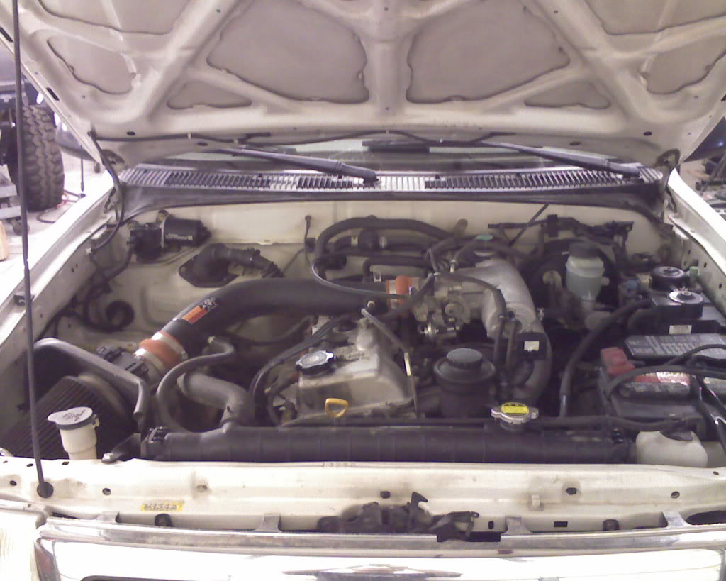

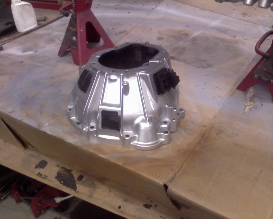

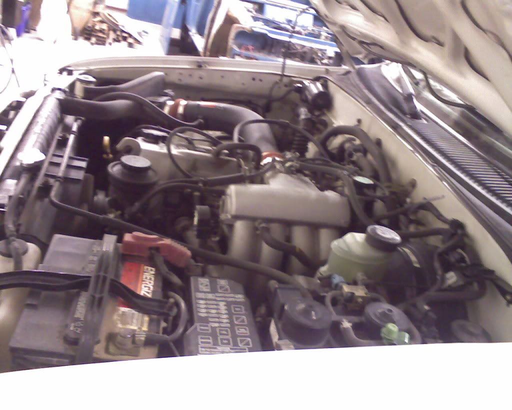

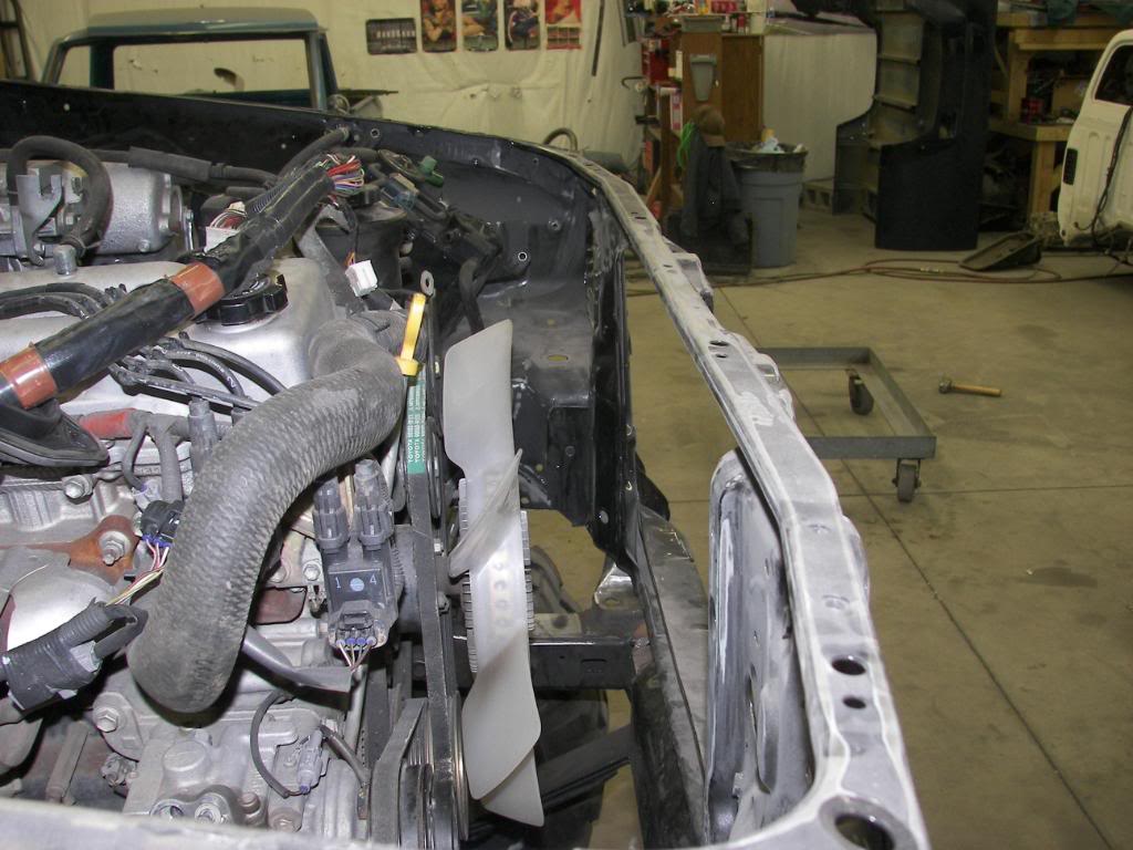

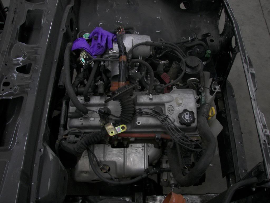

More pics as promised.

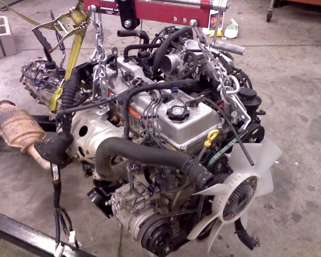

Cleaned the 3rz
The cab parts.
More to come...Gotta order a new clutch and a few parts to bolt up my trans.
Cleaned the 3rz
The cab parts.

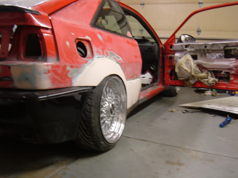

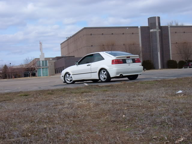

Nice I thought Vr6 at first becasue of the suspension, Here is a pic of my Corrado, needs paint, but other than that its in good shape, owned it for about 6 years now.

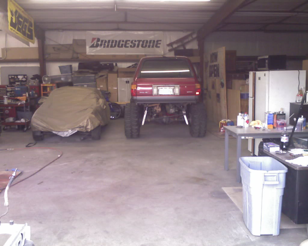

Sorry i havent had much of an update the past few days...I had to clean up after a 3.4 xtra cab swap we did last weekend. I get to start gutting doors,cab tomorrow. I have been talking and bouncing ideas with a few dash swap guys about the dash and its not as bad as a vw dash swap and its all going to work.

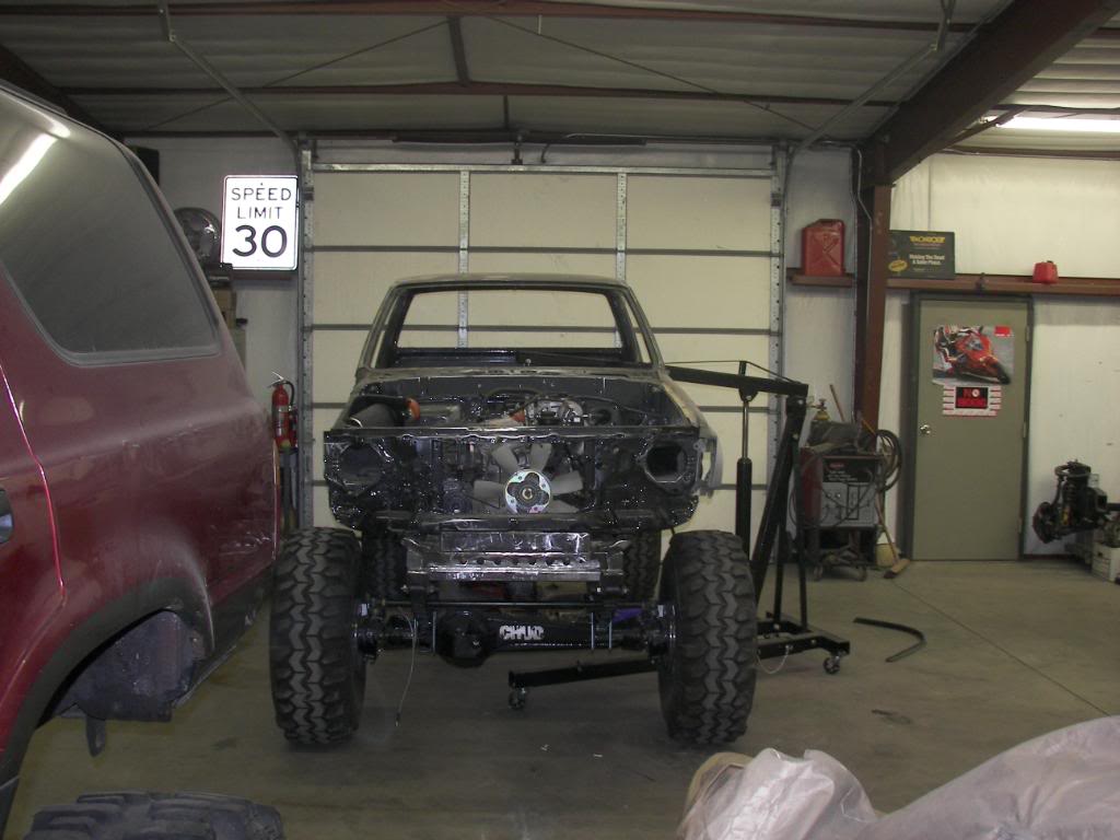

I have been working pretty hard on the truck and have made a few big steps.
Final mock up for the motor is done so now i have to pull it all apart, paint it and put it all together for the final time...Im so glad the project is getting somewhere.
had to build new mounts...2/4 1/4'' for the mounts
shes sitting pretty nice for not having anything in her and the springs not broken in. Should be about 15degrees when its drivable

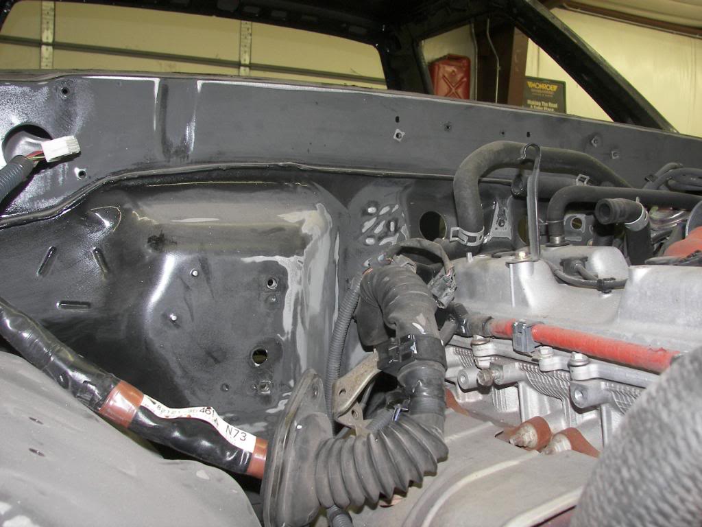

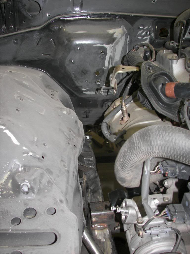

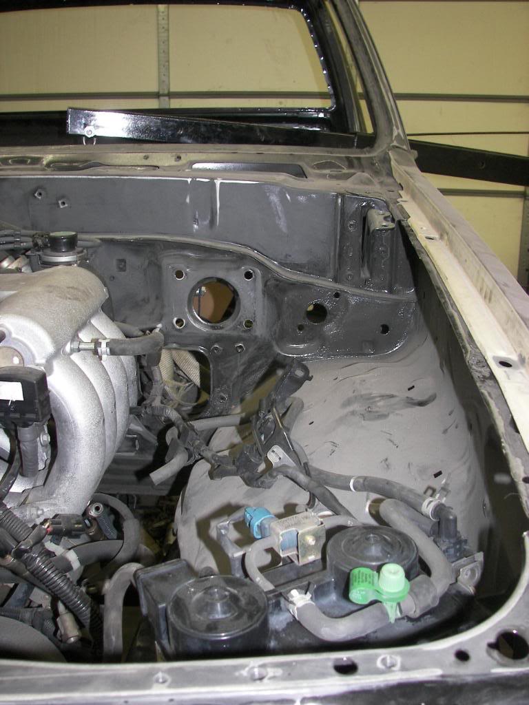

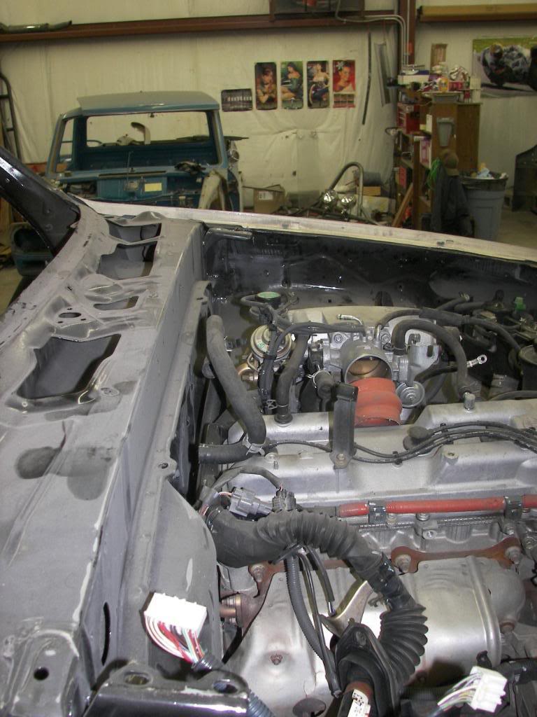

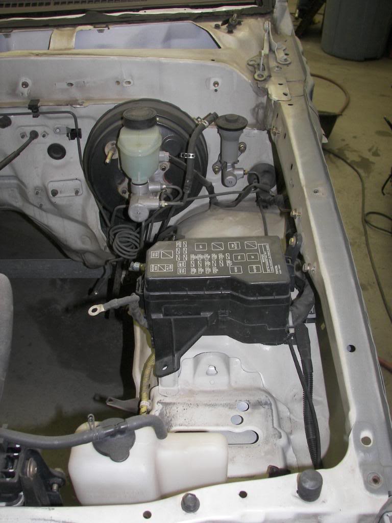

A few things to make up my mind on with the bay wiring....
Lexi is getting the inner workings of her younger sister(00 tacoma dash) the A/C parts will be installed so i cant avoid the holes in the firewall for those and the heatercore but i can avoid the clutter of the wiring harness. Do i wire tuck the bay and put the tacoma fuseblock behind the dash where the airbag is or do i take all the brackets from the bay of the tacoma and move them to lexi and make her look oem fresh?
A bunch of emissions crap goes behind the fuseblock that im going to try to work out of the swap all together.
you can see the emissions crap in the front corner of the bay here.
If i wire tuck it this plug will wind up running through the firewall directly behind the motor and to the passenger side where the stock ecu mounts in the tacoma dash.

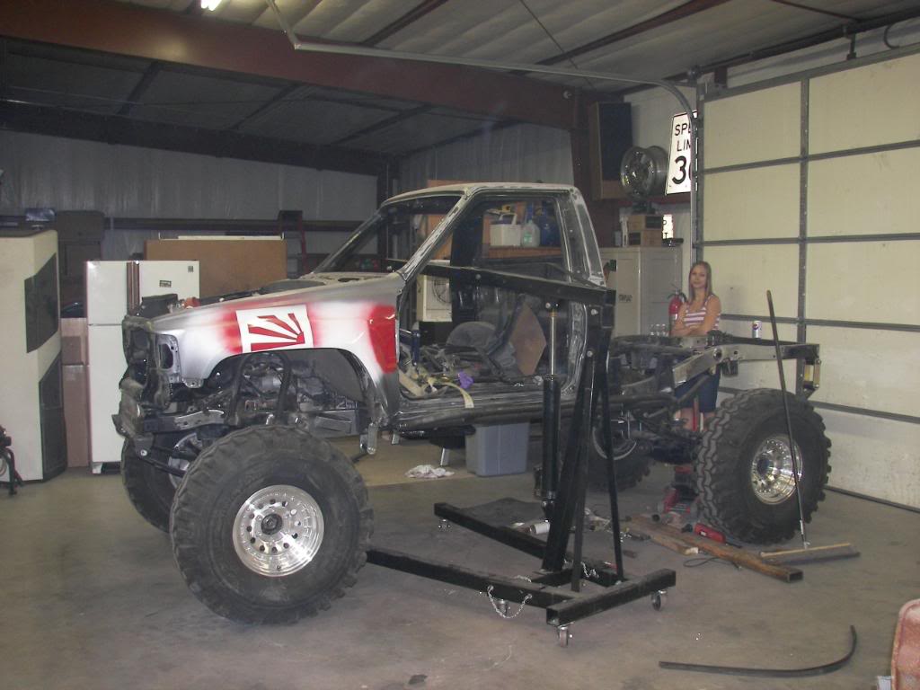

Few more pics from the hospital
I think that the 3rz takes up less room then the 22r/re/rte. I can see the top of the bell housing(could get to the top bolts np) before it was a paint to see or get to. Theres like 3-4 inches on both sides of the motor to the inner fenders and everything lines up perfect with my new mounts. Heater core lines are pretty close but will need to change some with the tacoma heatercore so it will be perfect.
cant wait to paint the frame and finish welding this sucker up!

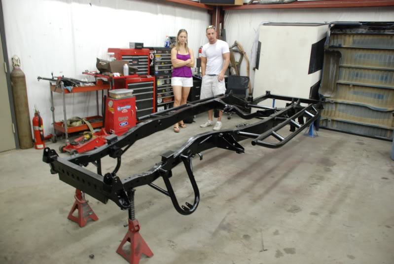

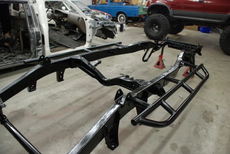

Going back together for the last time...
That was all done today...heres what it looked like when i got to the shop.

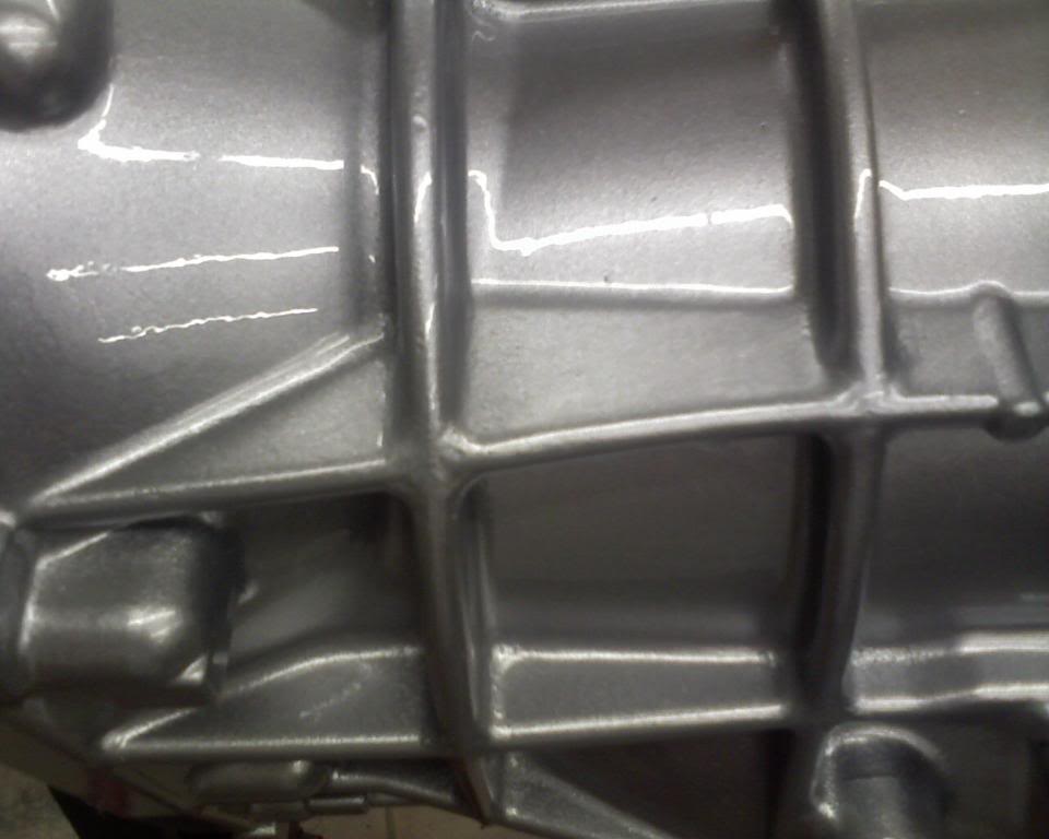

Painted the skid and all the ebrake pieces. I stripped everything down so i was sure i had removed all the rust.
More pics when i get back to the fun stuff.
