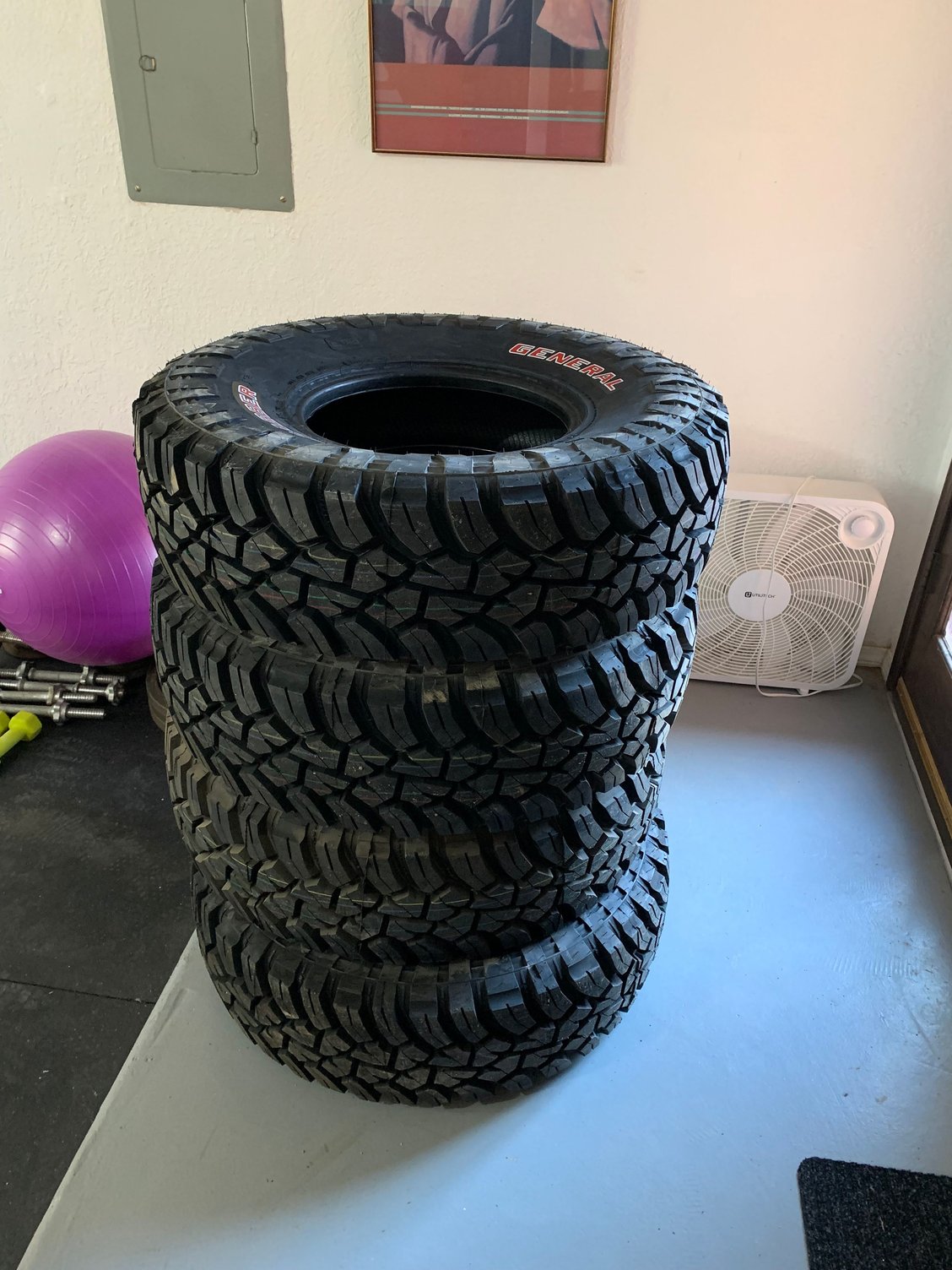

After the 4Runner was running correctly, it was time to address the old dry rotted tires. 35s are awesome, but I just don't have faith in the stock carrier so I'd rather run an ARB front or a solid axle if I ever want to run 35s. I think the stock SR5 wheels look great so I wanted to be able to keep them, hence running 33x10.5 instead of 33x12.5. I picked up a set of General Grabber X3 Mud Terrains.
