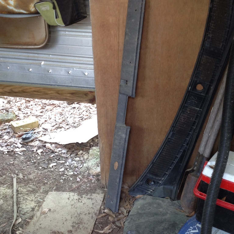

Pics of Parts
Here are the pics I told you I'd send. Couldn't figure out how to post them in a PM.
Attached Thumbnails Project "Striper" Build Thread-cap-1.jpg   Project "Striper" Build Thread-cap-2.jpg   Project "Striper" Build Thread-cap-headliner.jpg   Project "Striper" Build Thread-interior-trim.jpg   Project "Striper" Build Thread-tailgate-trim.jpg

Charchee, you're a legend. Arkansas is one of the few states I haven't been to and now I've got a reason to make it up there! Looks like a lot of interior stuff is going to help me out a heap and the SR5 alloys are sexy. See you Saturday!

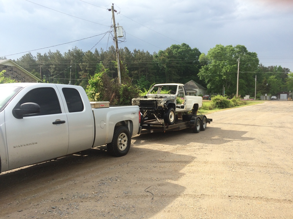

Oh, here is a pic of the parts rig when it was together and then stripped.
Attached Thumbnails Project "Striper" Build Thread-purchased.jpg   Project "Striper" Build Thread-stripped.jpg
