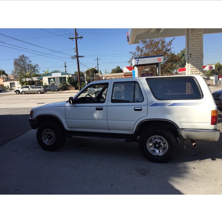

I thought it was pretty cool that my dads sequioa was pulling my truck so I snapped a quick pic of it at the gas station. Here it is!

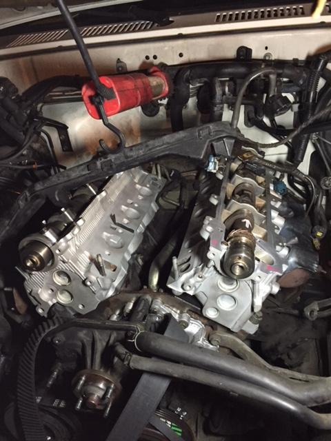

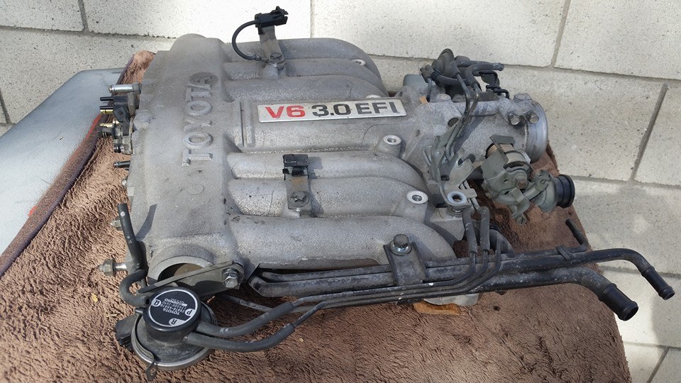

So my cousin started working on my truck this past weekend! Unfortunately I wasn't able to help him on the first day he started working on it due to my work schedule, but he took of almost all the things necessary to take the cylinder heads out!

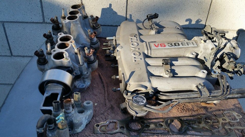

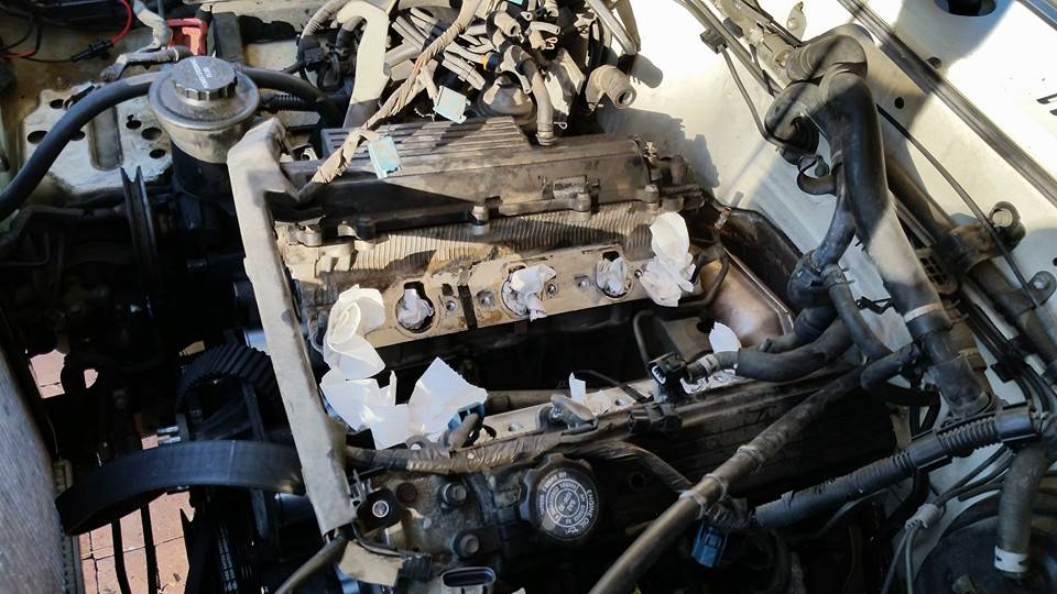

I went over to his house today and we took of the last part that needed to be removed which was the exhaust manifold and boy that was a PITA!
Hopefully I can get my truck running within the next couple of weeks! for now here are some pics my cousin took when he got done working on it on friday!
I can see myself driving my truck once again!

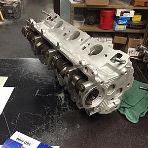

I just got my cylinder heads back from Steve's Machine shop in Covina Ca. They mostly work on Vdubs but it seems like they know what they are doing with all the different motors and heads they have in front of their store! They also have 4 out of 5 stars on yelp and 5 out of 5 on google.
I would highly suggest anyone to go there! They are extremely friendly and answer any questions that you have for them! Hopefully the heads turn out great when I put them back into the truck!
Hopefully I get it back up and running within the next week! for now here is a quick pic I took of one of the cylinder heads!

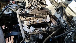

A little update here, My cousin and I finally started working on putting the heads back on. We got the heads back on but we still have to tackle a plethora of things! Hopefully we get it running this weekend!
For now here is a pic of the newly machined heads back on!
