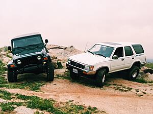

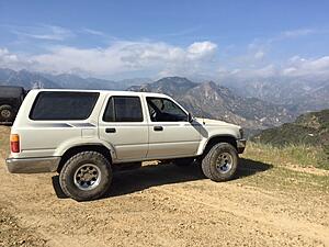

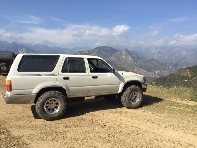

My buddy and I decided to do the rincon trail up in azusa mountain. It is basically a fire road so it was very easy. We practically just raced through it. Here are a couple of shots we took!

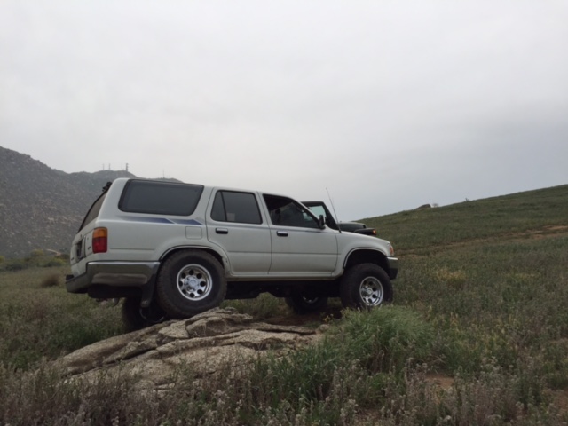

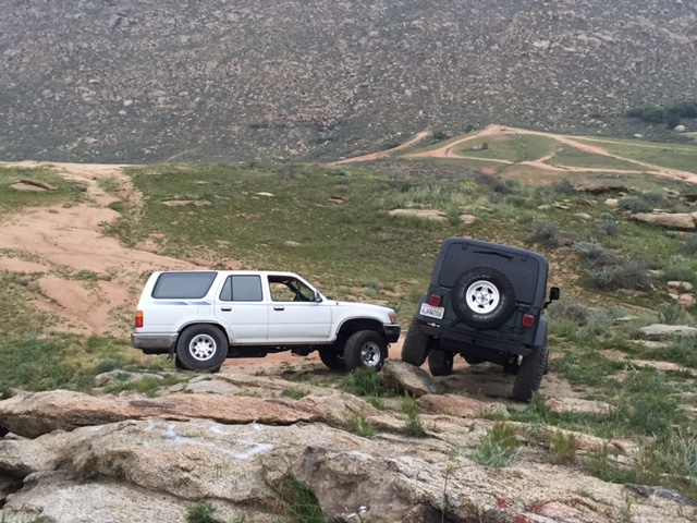

Another trip we did was in the backroads of riverside right off the 60freeway. This is our normal off road spot, we come here almost every other week!
