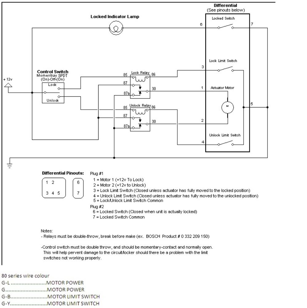

E-Locker Wiring.... i just need a switch and try it out

which circuit did you use? and did you include the high-watt resistor for the motor?

i used the 1st picture below. its for a hi pinion so im guessing land cruiser. the pins are not correct but i just see where they go to and compare it to the correct one i have. i used the relays from aftermarket alarm systems, they use them for the starter kill and its 5 pin relay. i didnt use a resistor but than i havent tired it out yet. i still need to figure out how the switch i got works because theres no diagram for it. its a on off on with 6 pins.
the second picture was the one i was gonna use but couldnt find a 6 pin relay only found 8 at radio shack. i also used this (2nd) picture to compare the 1st picture for correct pins

if the current one i made works. i will only have one light (telling me lock only) the second picture isnt hard to make imo but so much more wiring and cost more since i would have to buy two relay that i couldnt find

on to the elocker wiring. i added a 10amp fuse at the battery before the switch. i tried it out and i was blowing the fuse for some reason. checked my wiring and i think i had the motor wires switched at the relay. i tired it the other way and it works. no more blowing fuses. oh btw i tried this on a second elocker i had so i know it worked. now to install to the truck and run the wires

got the wiring figured out and works great. i couldnt find the million 12v led i have somewhere in the garage so i used a fan lol. everything in the cab is all temporary since im going up tomorrow and didnt have time to run it all nice. besides im gonna run a different switch and use a LED light
