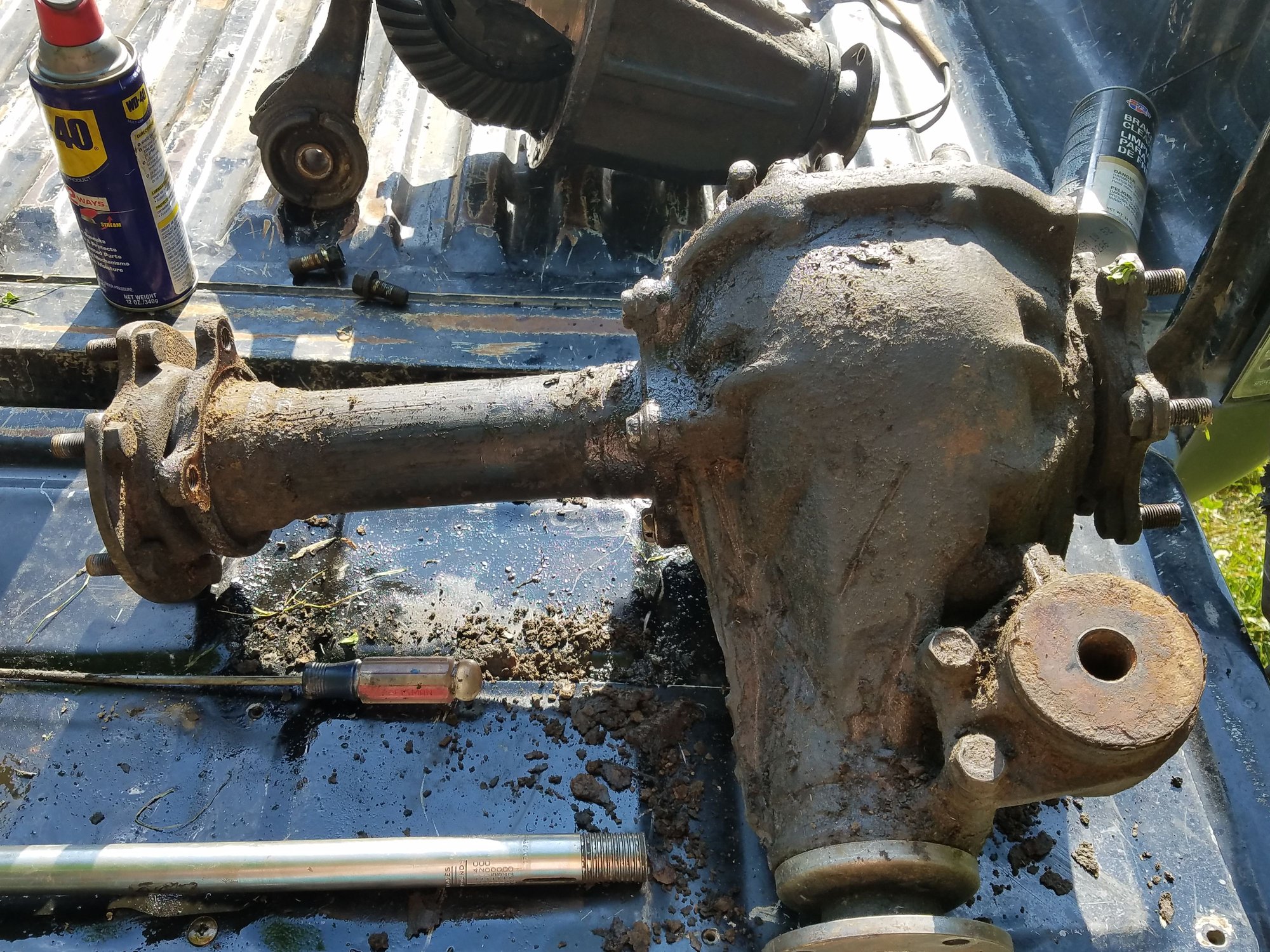

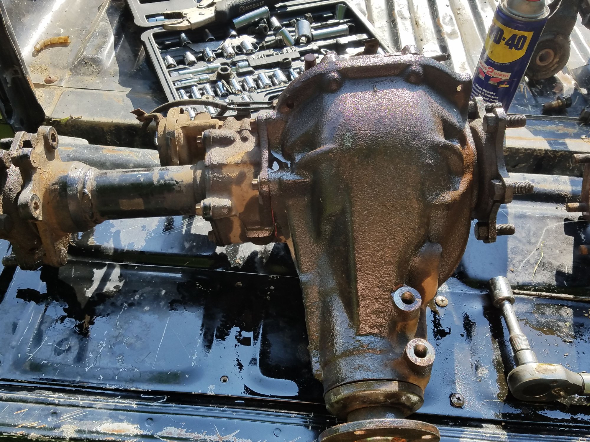

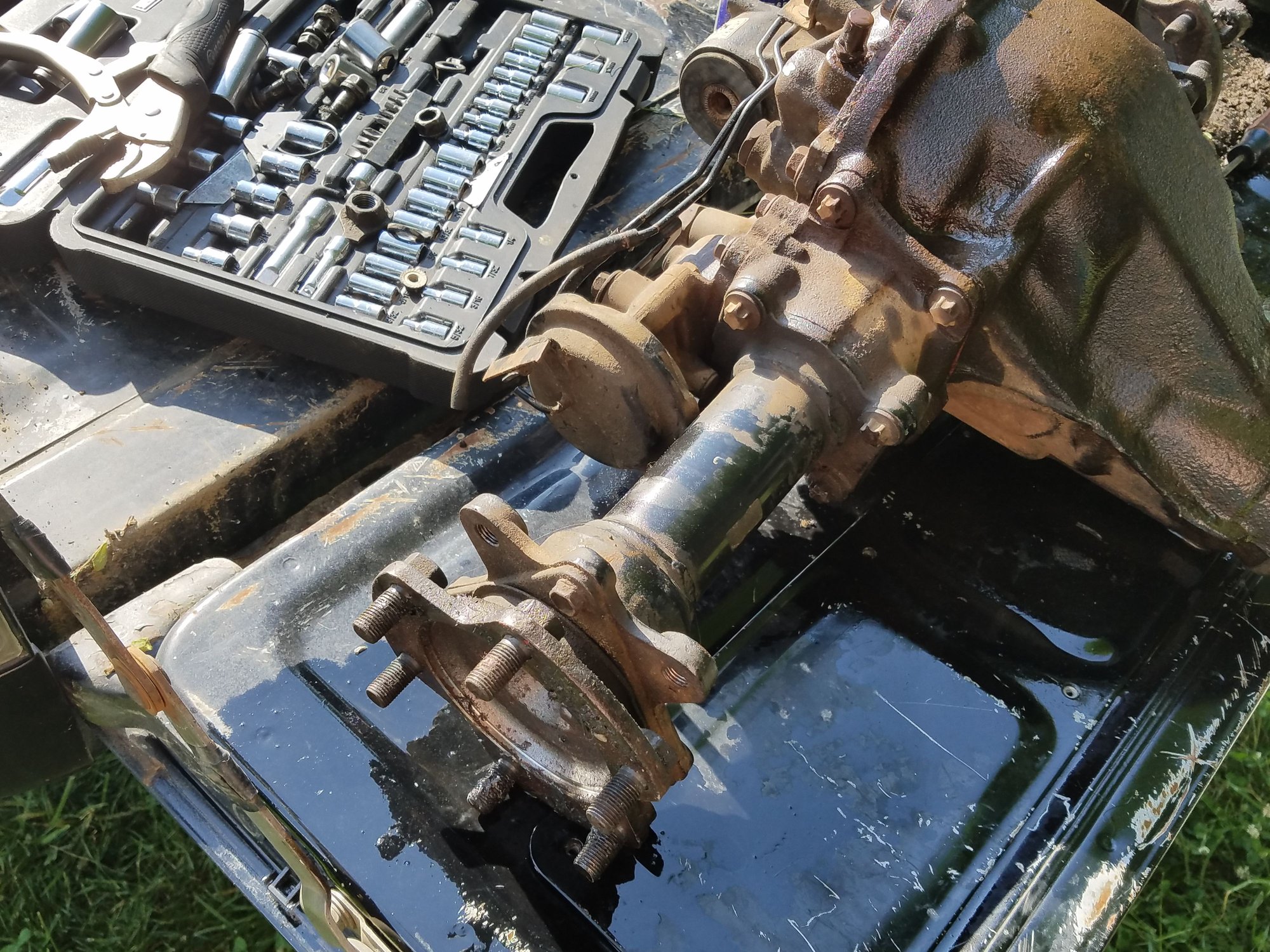

thought I would start on the front first..thought it would be easier....Wrong!
here's the issue. The long shafts that has my 488s in it has some contraptions on it
the original I just took out doesn't have all of that
I'm thinking. Need to switch the long shafts from my original to the new one just so everything matches... thoughts anyone?
Old Jun 1, 2016 | 04:48 PM
  #49
92ehatch's Avatar
Joined: Jan 2015
Posts: 652
From: Hendersonville NC
I think that is the auto disconnect deal that some runners have. If that's the case then swapping shouldn't be an issue
Old Jun 1, 2016 | 05:36 PM
  #50
TN Five-0's Avatar
Joined: Mar 2016
Posts: 72
From: Kingsport,Tn
Well I thought so to. The I tried pulling my axle tube off my original.. there is a snap rings holding the axle in. I'm stumped....researching now
